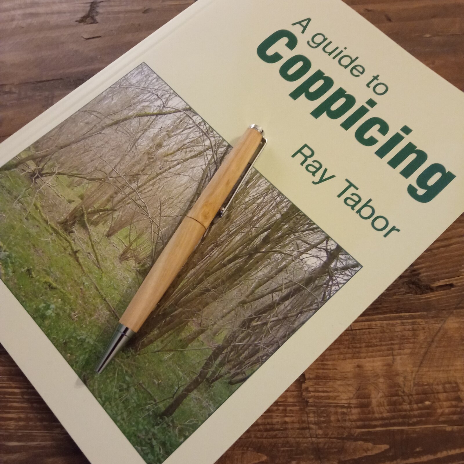

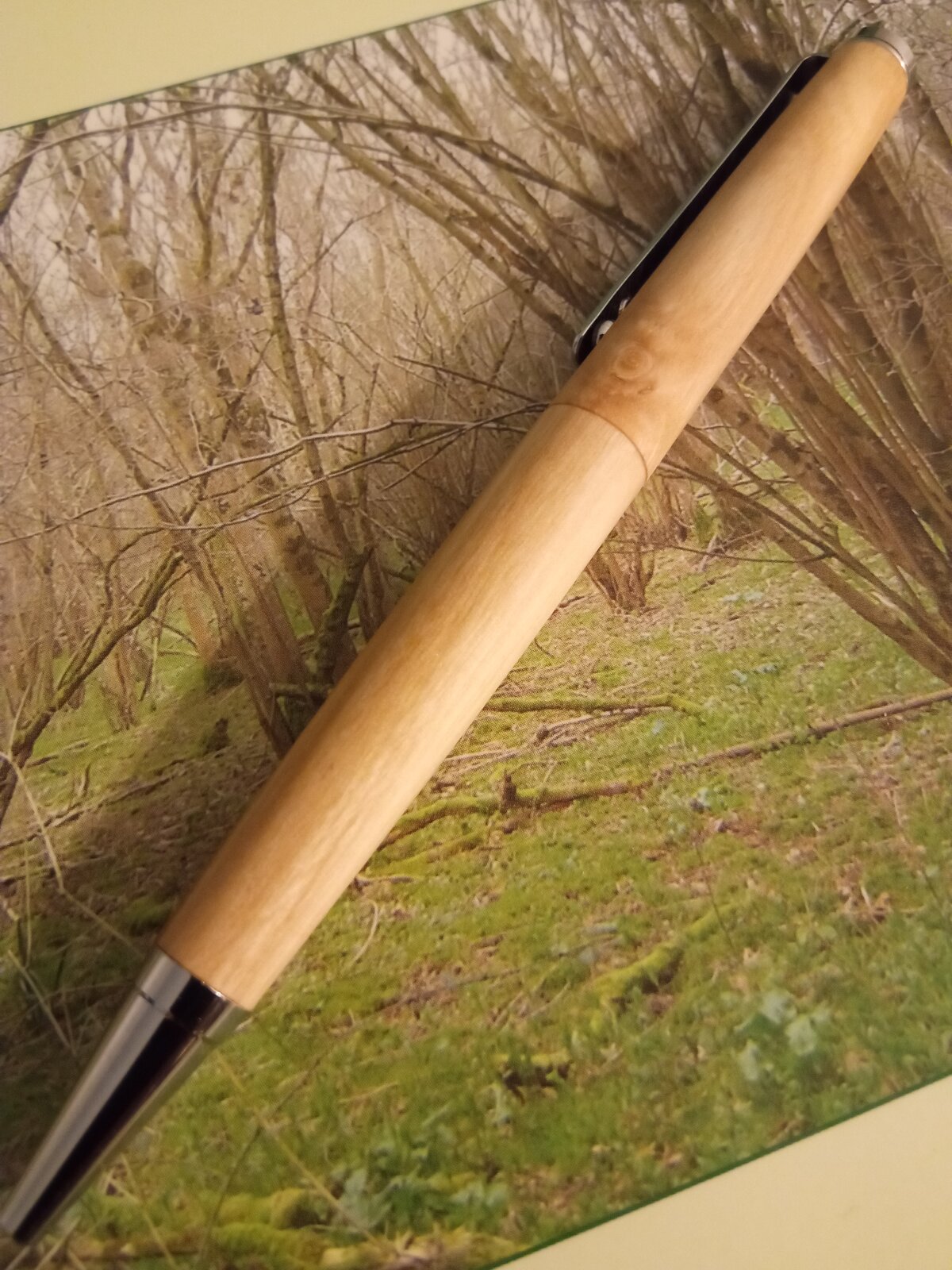

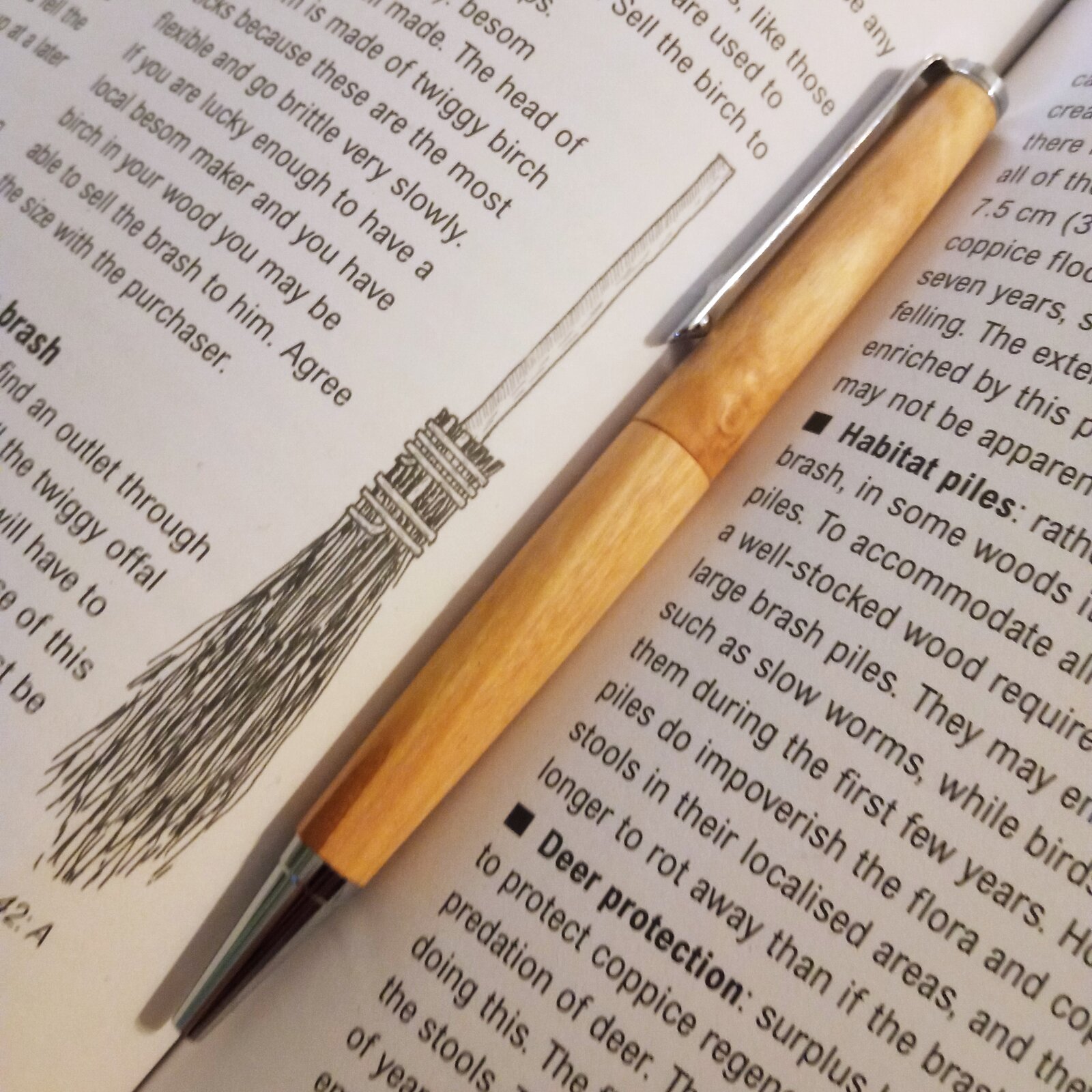

A modified slimline i made recently from wild olive wood. This is the wild relative of the domesticated olive tree; more robust, dense and not fruit producing. I small problem i have when i eliminate center bands is that the pen is not 100% round (maybe the same happens in ordinary slimlines also but the center ring makes this unnoticeable). I am thinking to make a new shaft for my pen mandrel ( which is a relatively high quality axminster evolution), maybe the diameter of the shaft is a bit smaller than the tubes. Any advice is welcome, cheers.

I've never heard of wild olive, only what's from Israel or Holy Land as some call the region. If you are using bushings to turn the blanks, here is what I have done recently. When I get close to the bushing, I wrap it with one turn of masking tape. Taking careful and light cuts, I watch for the tool hitting the tape. It could wear it down to show the bushing or tear a small part of the tape. Then, more careful and light cuts. I pass my thumbnail over the bushing and blank to make sure it's even. There is a book by Don Ward who has several ways to modify Slimline pens. You might see if your local stores have it. Worth the money.
the thing is that i use bushings at the ends; not the middle bushings, to acieve this pattern. when i take the blanks off the mandrel everything is ok but when i have completed the pen and i twist the two sections there is a tiny (fraction of a mm) gap that it can be felt (otherwise its unnoticable).
