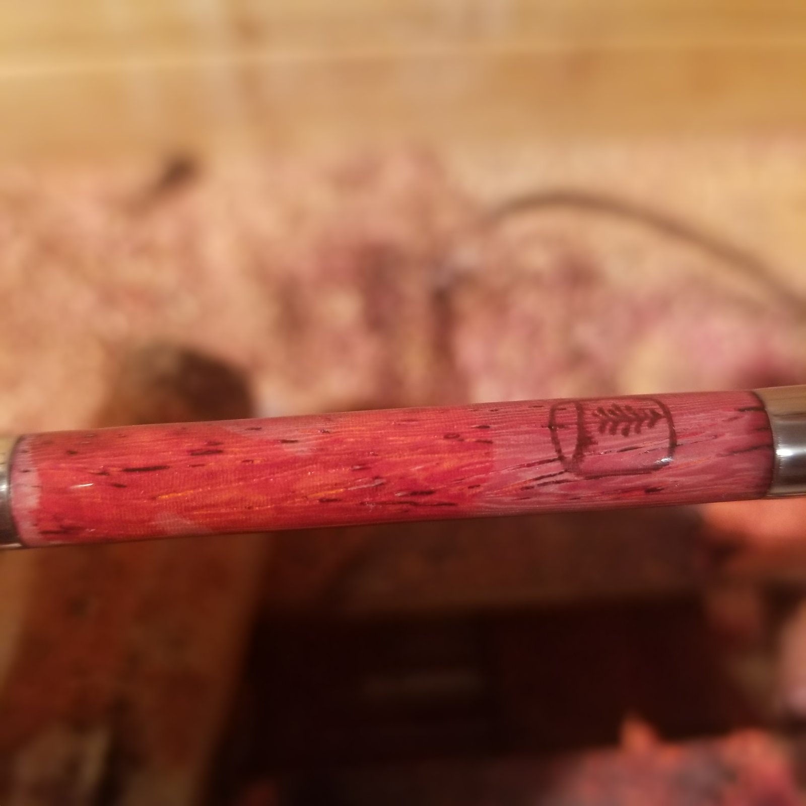

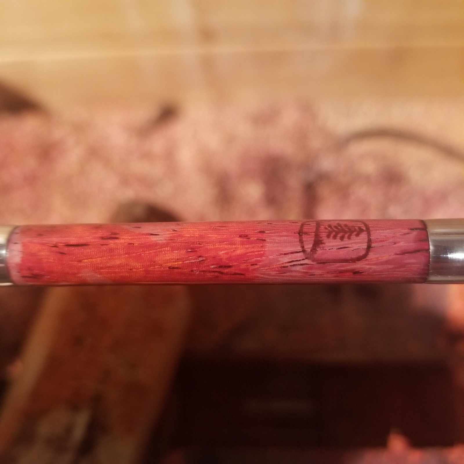

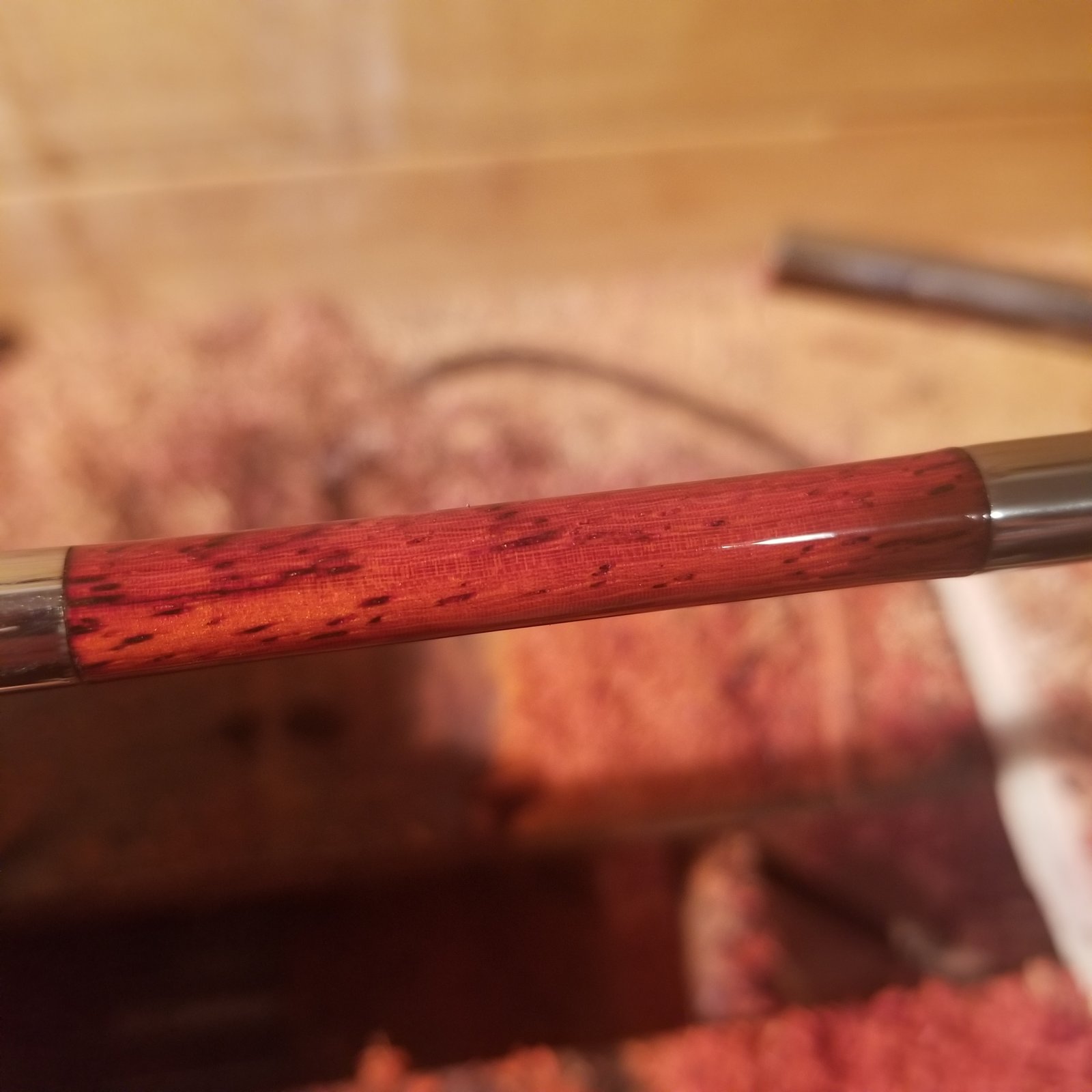

I am relatively new to pen turning and I'm having a issue with my CA finish. For some reason I have big splotches left that look dull. At first I thought I might have sanded through the ca into the wood but that's not the case. There is still plenty of ca on the wood. I've attached some photos of what the wood is looking like. One came out well but the other has the big splotches I have mentioned. I use denatured alcohol to clean the oils off the wood but I make sure to let it completely evaporate before I apply the Ca. I also sand the CA with micro mesh and apply a plastic polish.
Thanks for the help!!!

Looks like you sanded through your finish. Have you checked if your mandrel is straight? Last time I had this issue I had a bent mandrel.
Looks like you sanded though the finish. Once I put ca finish on, i start with 3200 micromesh. Very light pressure
When I see spots like that on my work, it usually represents the CA separating the the wood. I remove all and start over ensuring the wood is dry and allowing more time between coats. I usually only get that on the ends after assembly.
I agree from the photos it looks like CA has been sanded off. But with that said, other things can cause the same look. First is if you did the CA finish and and took the blank off to sand the ends because of CA build up on those bushings (which I do not like when finishing) It make have cracked the end of the CA. Also if wet sanding and you do not seal the ends of the blank, water can get under the CA and cause lifting. We do not have a good read on your method of applying and sanding and finishing so hard to make a true assessment. We are guessing here. I highly suggest you do not finish with the same bushings as you turned with. Make or buy some finishing Delron bushings. There is a ton of info here if you do some searching and even check the library. Just so much to cover when it comes to properly doing a CA finish and there re many methods used. But those bushings have to go.
Thanks! The bushings in the pics are not the ones I used. I have nonstick bushings. I just used these so you could see the wood better. Any advice on how to deal the end of the pen to prevent water from getting in when sanding?
After you trim the excess CA off the ends of the tube, lightly coat the ends of the tube with thin CA. To do this, I take a folded piece if paper towel and dampen it with thin CA and then dab the blanks on that. Work quickly - it WILL stick!
In addition to sand-through from bent mandrel, sand through comes about from different reasons:
1. Not thick enough layers of CA. Anyone can apply 10 to 15 layers of thin CA with paper towel and I can apply one layer with medium that is thicker. The point is, It is NOT the number of coats that make a success, it is the thickness and build UP of layers. If you want to know how effective your coats are, use a set of good calipers (metals ones) to measure the diameters Before Appling CA and after applying CA. That will give you the thickness. VERY Thin layers will/can be sanded through in SPOTS.
2. Too much pressure in Sanding will cause the mandrel to give and flex just enough that you will sand more on one side than another.
3. soft woods will sand more on the soft portion between bands of hard grain.
4. Using a stock wood lathe endpoint/live center in the tail stock - in the little cup in the mandrel. The mandrel requires a 60° live center for proper use. The wood lathe live center is made for WOOD, not mandrels. This will cause the tip of the live center to bend a tiny bit and introducer minuscule wobble and sand through on one side.
5. Too Tight on the tail stock with mandrels - Again forcing a minuscule bend in the mandrel - maybe imperceptible to the naked eye but results in sand through in spots.
You mentioned that "you can see the CA but you see flat spots". This is a description that many "new to turning" say. Because the CA can be seen easily - that does not mean that it is everywhere. It has been sanded off in the dull areas. One other item that hides this is if a wax is applied AFTER turning, the shiny wax may hide the sanded spot for a few hours to a few days.

Thanks for the advise! Really helpful to me as a beginner. Thanks!!!
