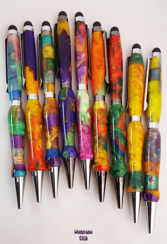

Kenny - I learned by making slim stylus pens of all sizes, shapes, and colors - and 80-90% of current pens are slim stylus. This bunch went to a local garden club requesting bold colors to complement their blossoms and blooms, with stylus ends to keep up with their grandchildrens' texting:
attachment.php
If there were other stylus kits, I'd make them.
Warm regards - and have fun, Bob
