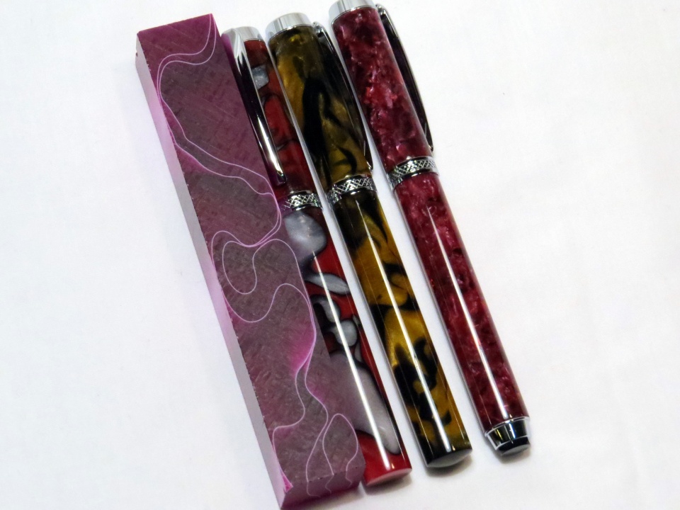

I love the look of a closed end pen! The Orion RB pens use up nearly all of a 5" acrylic blank. I might be able to squeeze another 1/8th" out of the blank but after drilling a 60 deg center hole in the closed end section (TBC) there isn't much blank left. What I need is a 6" acrylic blank:biggrin: Wood works and I have one finished with poly that is sitting in a drying cabinet.
Flat bottom closed end, round closed end (hole drilled with my 2nd smallest center bit) and stock hardware. Not a whole lot of blank left to make the pen body longer:frown:

Turn the pens closed end, you can make them any length you like.
