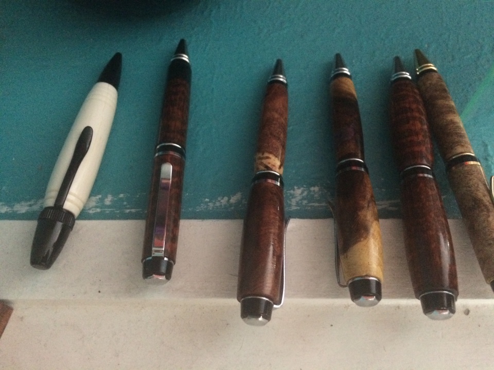

Snakewood sawyer turned pen turner
Hello,
I am new to pen turning and have fond a way to keep the snakewood from cracking. It works 9/10 times:
Hi,
I figured out how to stop the cracking. I drill using a drill press and do it incrementally so as not to overheat. I usually have 5 blanks that I drill at the same time, one after the other and keep going back to them.
Second I use epoxy on the tubes.
When I square the ends I use a rest 90 degress to a sander, i used to use a chuck and a jacobs but there was too much vibration
When I square off the ends I immediately like seconds afterwards drop some thin CA on those ends, one or two drops until it gets absorbed
I let it rest one day and put the blanks on a mandrel for a few minutes sometimes overnight, I have several loaded mandrels.
I use thin CA on my first pass, then several with the medium or thick
I actually had one start to crack but I put some thin CA and put thicker the next day and it worked fine and held
I have Gabon ebony, Az Desert Ironwood and snakewood. Ill specialize iun those
I am new here and could use some help to start a snakewood pen tunring post.
- dom1971

Dom welcome to the site. You can just start a new thread in the penturning section forum or you can reopen this older post like you just did. I commend you for having success with snakewood. But may I ask you how long have you been tracking the pens you made??? Snakewood is one of those woods that will develop cracks down the road. The thinner the blank the more chance of this. Not all snakewood blanks crack as well as Gabon Ebony or Pink Ivory and there are others. Alot of times it depends on where it was cut from on the tree or plant. Other factors such as how it was harvested and dried. How it was turned to fit the pen and so forth. One of those there is no right answer to scenarios. Good luck with your turnings and again welcome. Jump right in. Others will follow.:)
