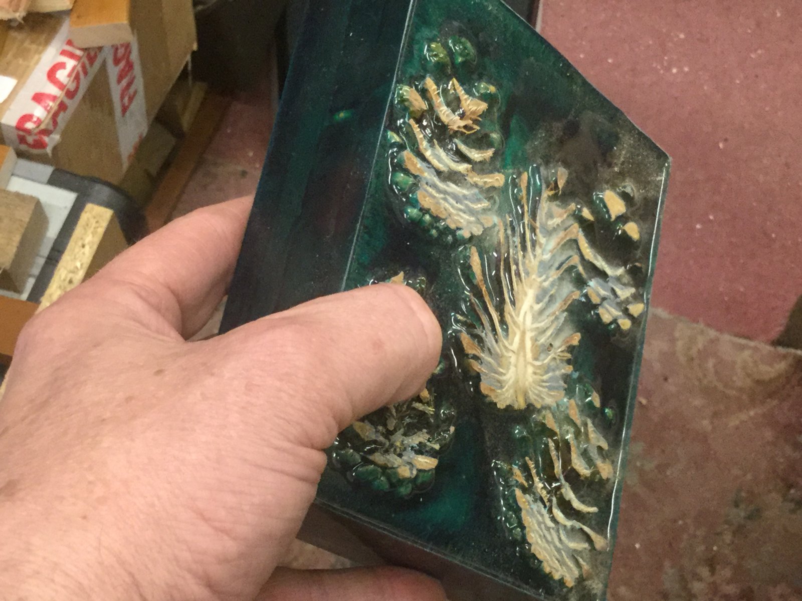

Have you checked for taper in your molds ? if the are even slightly tapered from base to top then your stuck fast but with screwed moulds you can ease apart. Never tried tubes but i intend to now but , at my current rate of production that may mean january 2020 .
the pine cone block shown needed four pourings but came loose no bother , stoner was used .
