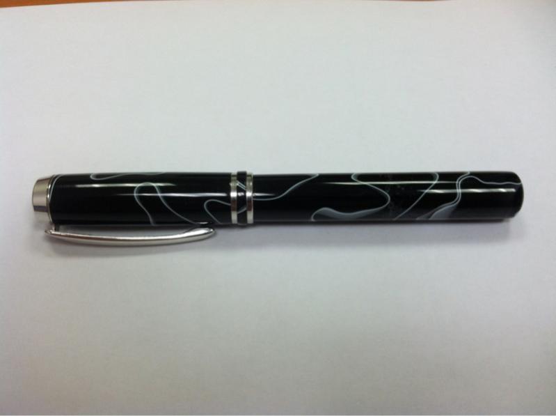

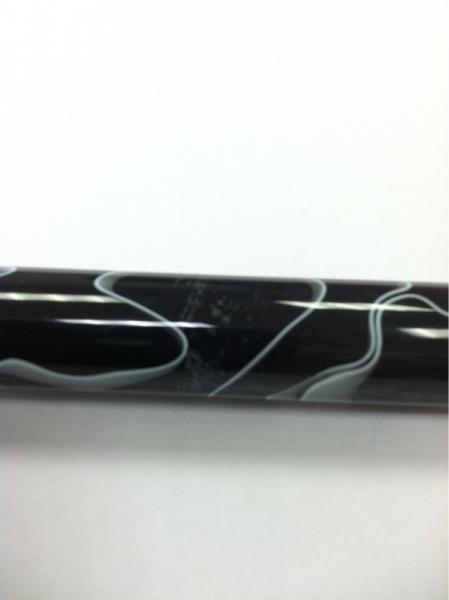

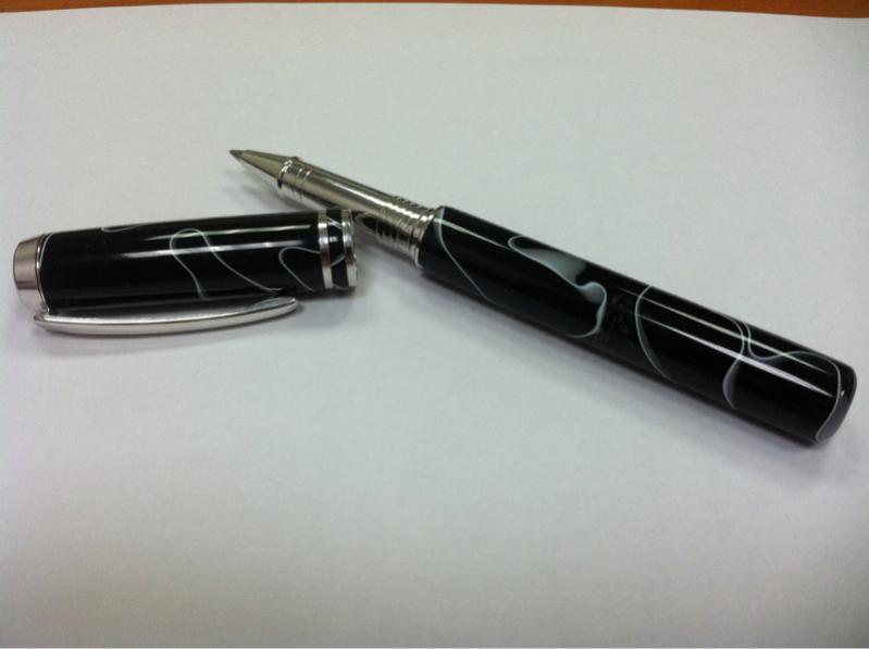

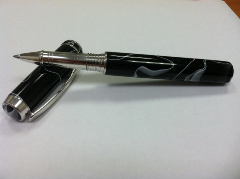

Thought I had it .. But then the dreaded 'checking'. Use epoxy to glue the tube an tinted the epoxy? Sorry for the bad pics ... iPhone and regular lighting

What kind of drill did you use? I only see one spot in the one picture, it could be that your drill was grabbing and chipping when you drilled the hole.
I don't know how you applied the paint, but assuming you got a good coat of full coverage, it looks like you scraped some paint off when you inserted the tubes. Use sharp drill bits so you get the smoothest hole possible. Use a round file to smooth out the inside of the hole even more.
If you sprayed the paint you would not have noticed that there were rough areas on the inside. If you used a q-tip as a paint brush you would have felt the rough spots. It is built up paint on the rough spots that get scraped off.
Hold your finger over one end, look into the other end. If there is any light you missed a spot.

It's in that one section of the pen but all the way around. I'm thinking Chasper is right ... Gotta be drill bit markings. I use Norsemans so now i am going to try another lucite and sand the inside of the blank too.
