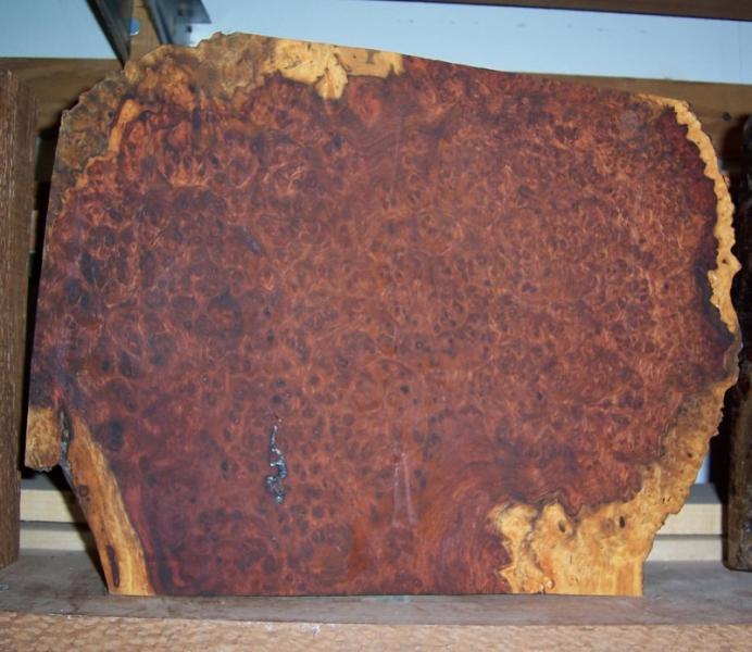

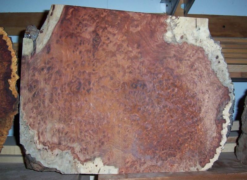

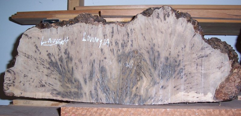

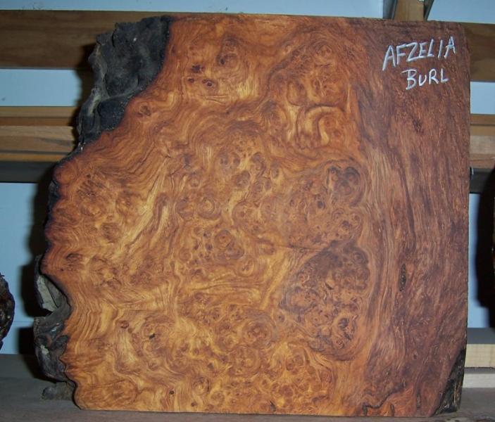

I recently met a gentleman who has a lumber mill in Laos and imports his own wood to Dallas. He has a huge warehouse full of burls and exotic wood and specializes in burls; Livingia, Amboyna, Afzelia among several others that I can't recall right now. Depending on the size and species, his burl prices run between $8 and $17 per pound and run from small 10 pound caps to 400 pound monsters. The more you buy, the cheaper it gets.
He is considering cutting some nice size blocks of nice amboyna and afzelia burls that will fit into the USPS large size flat rate boxes (12 x 12 x 5 1/2") for around $12 per lb.
I am helping him set up his web site now and it should be up and running in a few weeks. If interested, drop me a PM and we can discuss details.
Here are a few burls I recently bought from him to give you an idea of what he's got....

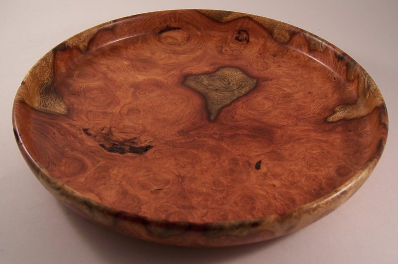

I have never turned any type of burls I know it really makes some awesome stuff but isn't it hard to turn and needs to be stabilized before turning?
I have turned my share of non-stabilized burls, mainly amboyna, afzelia and rosewood and never had a problem.
Since first laying my eyes on amboyna burl a few years ago it has become my favorite wood to turn. Aside from filling the shop with a wonderful sweet smelling aroma when turning, it is probably the easiest wood I have ever turned.
I did a small shallow bowl yesterday and as you can see in the photo there are a few small inclusions or "voids" and these presented no problems at all.
