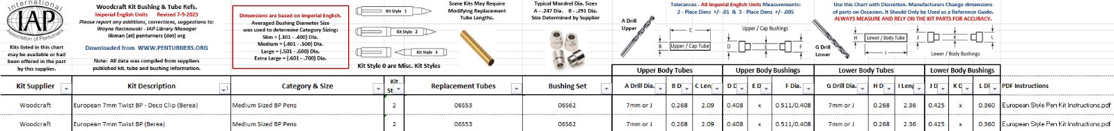

Does anyone have any information on the European Deco Pen kit? Mainly looking for a copy of the instruction sheet and possibly the dimensions of the bushings. I believe the bushing is 06562. I purchased a couple of the kits several years ago and they were in Woodcraft bags but there is no Woodcraft part number on the bag, just a barcode showing Dayacom. The pen kit is similar to Penn State's Designer but I have no idea if this is a Tenon pen or a No-Tenon pen. Any help will be appreciated.

Vyron; Look in archive.org select the "Way-Back Machine" and enter the Woodcraft web site. Select a likely time frame to search for the instructions.... Hope this helps.
From the WC Chart.
