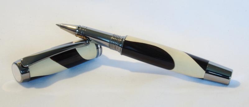

Still, in pens, I used lots of holly for real white wood.
