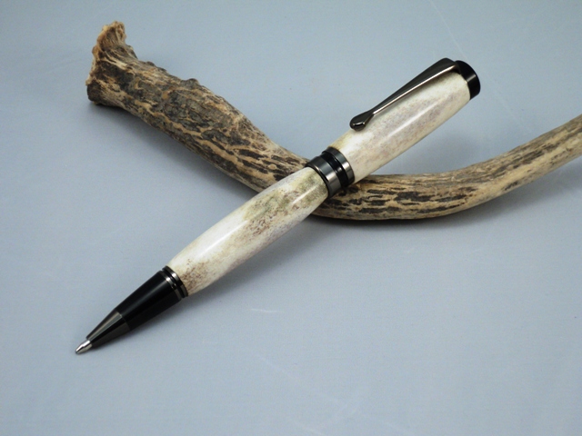

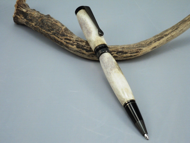

Is the smell or the dust from antler that is supposed to be toxic? Here is antler harvested from a white tail deer in southeast Arkansas, on a "Classic" gun metal kit. It is a commissioned piece that I am going to
send off & have the name lazer engraved....any suggestions?:wink:

Hey Philip, I'm not qualified to settle the bone/antler investigation, but that is a good looking pen. And if it helps, I use a respirator when turning antler. I guess you won't be able to bring that to the meeting in May since it's a commissioned pen. I'd have liked to seed that engraved.

Phillip - nice work on the pen! Looks like you have some more raw material lurking under that pen for future projects! I really like pairing gun metal with antler.
Don't let the skinny tip fool you into thinking it's too narrow to be useful. I've made iPad styluses, letter opener, and several bottle openers out of those. You just need the cut end to be wide enough for a short tube (all of those projects used a 7mm tube and the original tube from a stubby stylus is fine at roughly 1" long though I have one bottle opener with an even shorter tube than that...works fine).
For the stylus, the user's hands have to be over the portion with the tube, so a long tube is better, but a curved tine fits very comfortably in the hand during use (which puts the user's fingers right down by the tube so it works).
In addition to a powered, filtered turning mask, I also have dust collection at the lathe while turning/sanding antler...and for the natural-tipped items, I use the mask plus dust collection at the desktop sander where I hand-shape the tines.
I also have an overhead air filter going (for the really fine stuff that doesn't like to settle down) and vacuum the work area afterwards as well (to get the stuff that dust collection missed).

Got lost in the other posts for a little:rolleyes::rolleyes: Last I saw the question posted for laser engraving one of our members called Sub Vet 10 said his father-in-law did it in Houston did engraving. Might want to contact him...Very nice pen by the way! Love antler pens:biggrin:
