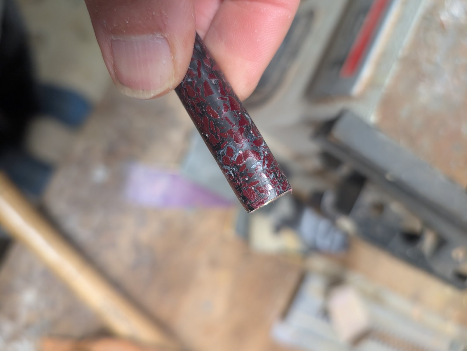

I purchased some blanks made out of plastic and dark epoxy. When I turn to finish. I can see a distinct white haze on the tube. Should I use a 2 part epoxy glue instead of CA glue and is so what brand do you like?

I'm troubled by all the air bubble pockets (the little white circles) in a blank you purchased. That's a casting flaw. An occasional bubble sometimes happens, but anybody who is selling blanks should be notified of that many, and you should receive a replacement or a refund.
What I'm seeing might not be an issue with your preparation. That grayish base color for epoxy should be opaque enough in this instance that the tube should not show through. I speculate this is the result of the maker not mixing the base color well enough (used white and black to make gray), and the white colorant is the culprit.
I don't cast for dough, and prefer to not criticize other casters. I'd be embarrassed if a blank like that left my shop, and I'd certainly want to know if it did so I could make it right.

You are the only person to figure this out. Yes, it's air bubbles. Thank you so much!
You're welcome. It can be salvaged, but it will be a lot of fussy work. I had a bubble problem with a casting of my own. I sanded below final fit and used stick pins, a dental pick, DNA, and a toothbrush to clean all the sanding dust. I used GluBoost ultra thin to fill them, built up a topcoat past final fit, and then followed my usual finish process.
Ordinarily, I wouldn't mess around trying to salvage a self-cast blank with many air bubble flaws. I liked the blank too much to turn it off and salvage the tubes.
I encourage you to address the flawed blank with the maker. They need to know their product or casting technique needs improvement.

I absolutely agree with Brian G on this! I had a similar experience with a blank with a bunch of tiny bubbles. Most were fixable as Brian noted with CA, but some were in the threaded areas (It was a kitless pen) which was more difficult to deal with. I contacted the seller and he promptly sent me a replacement.
