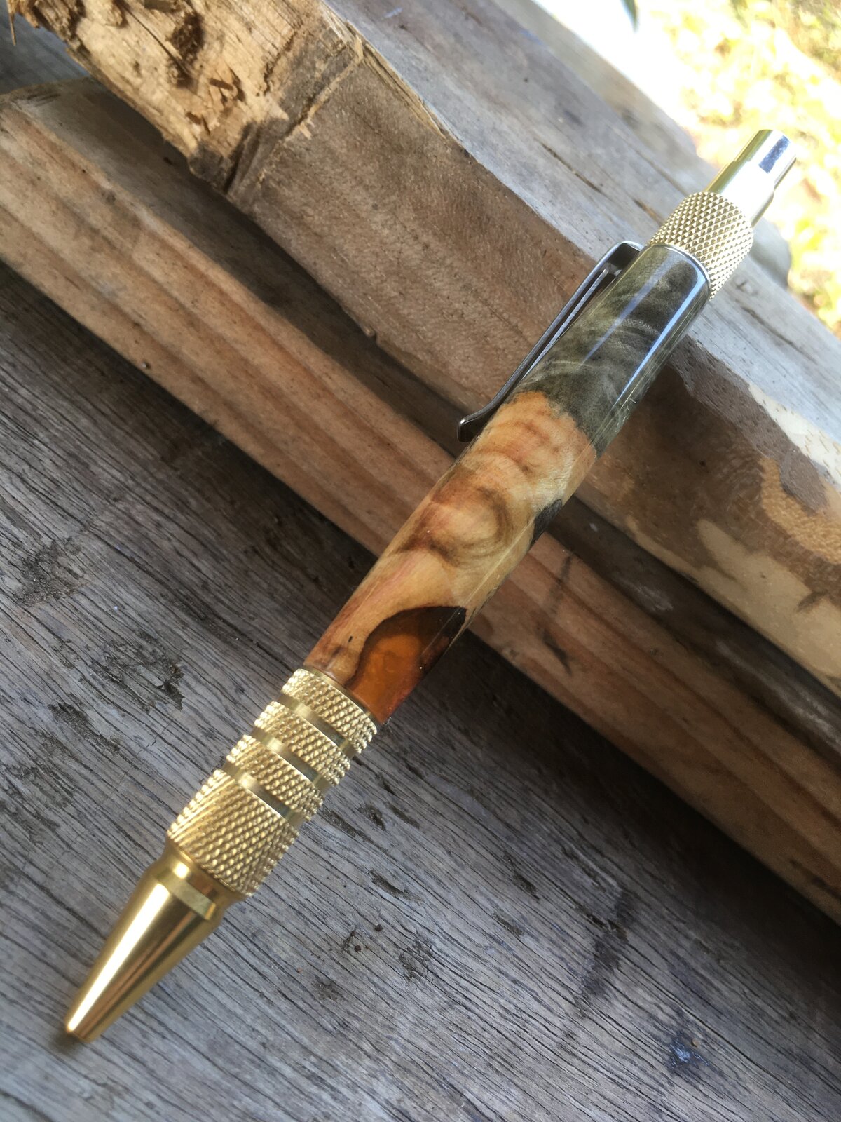

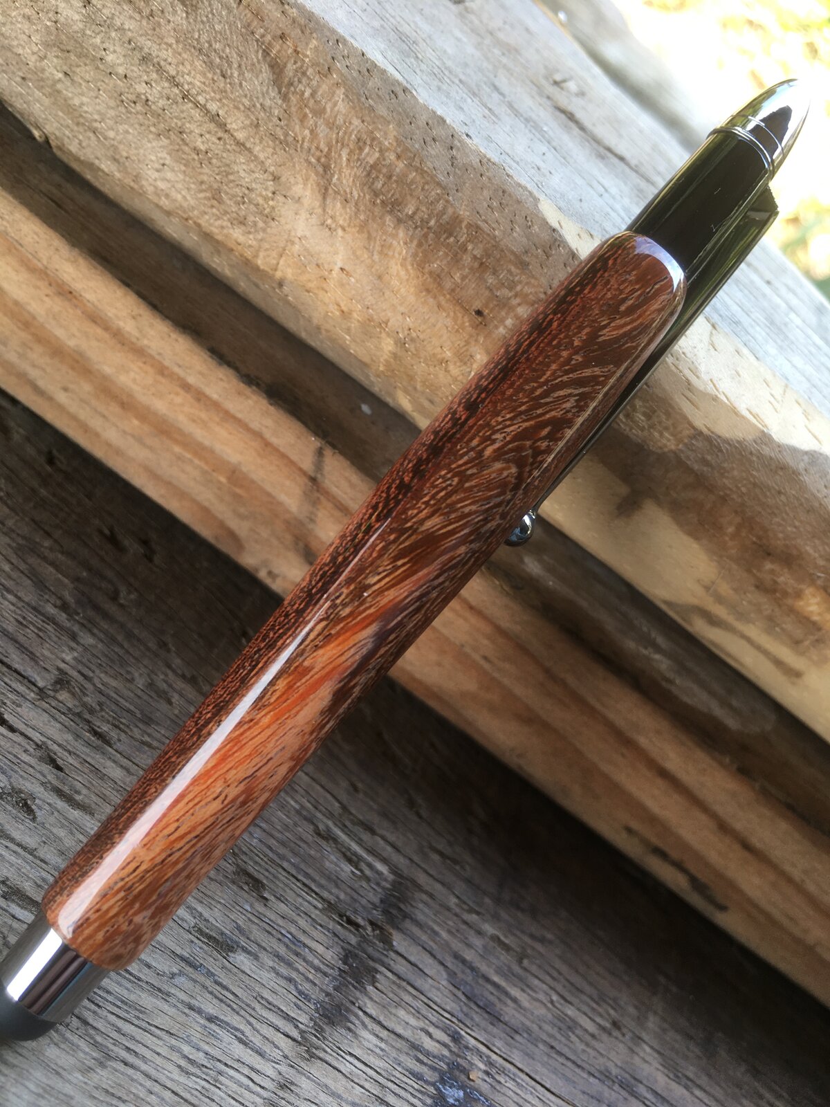

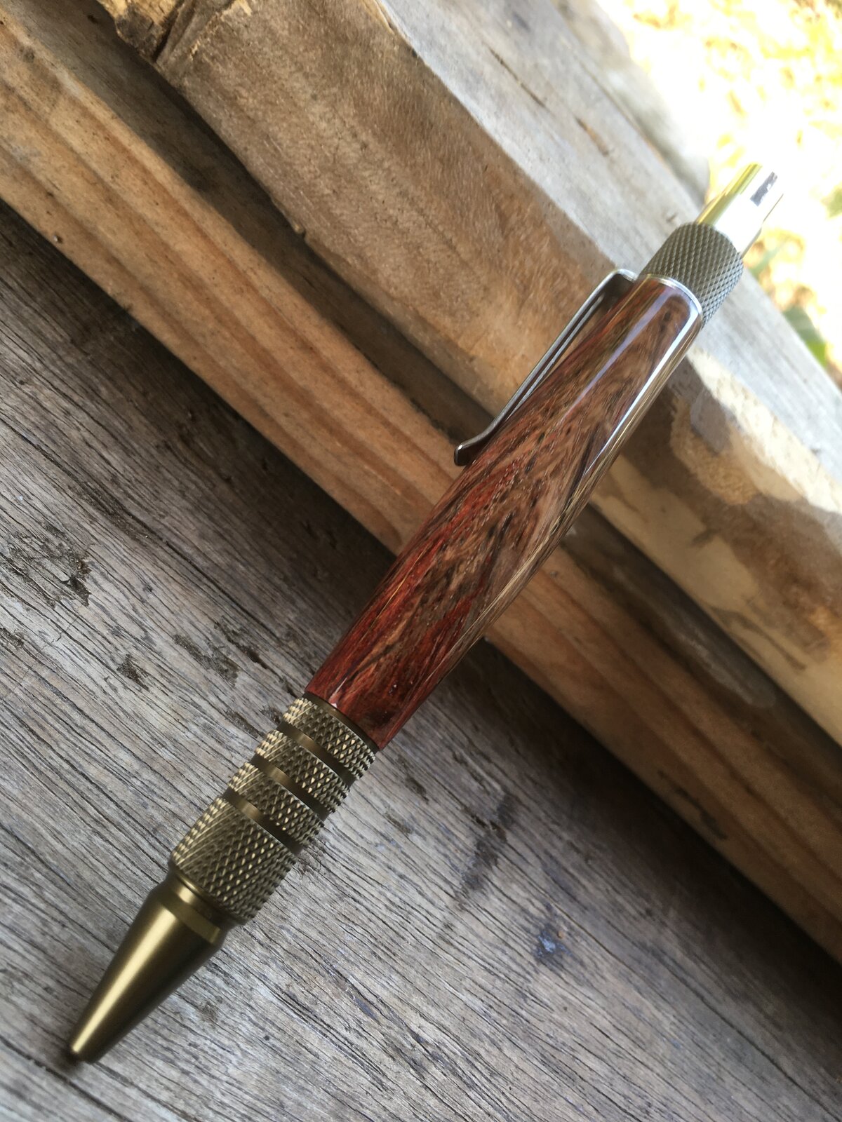

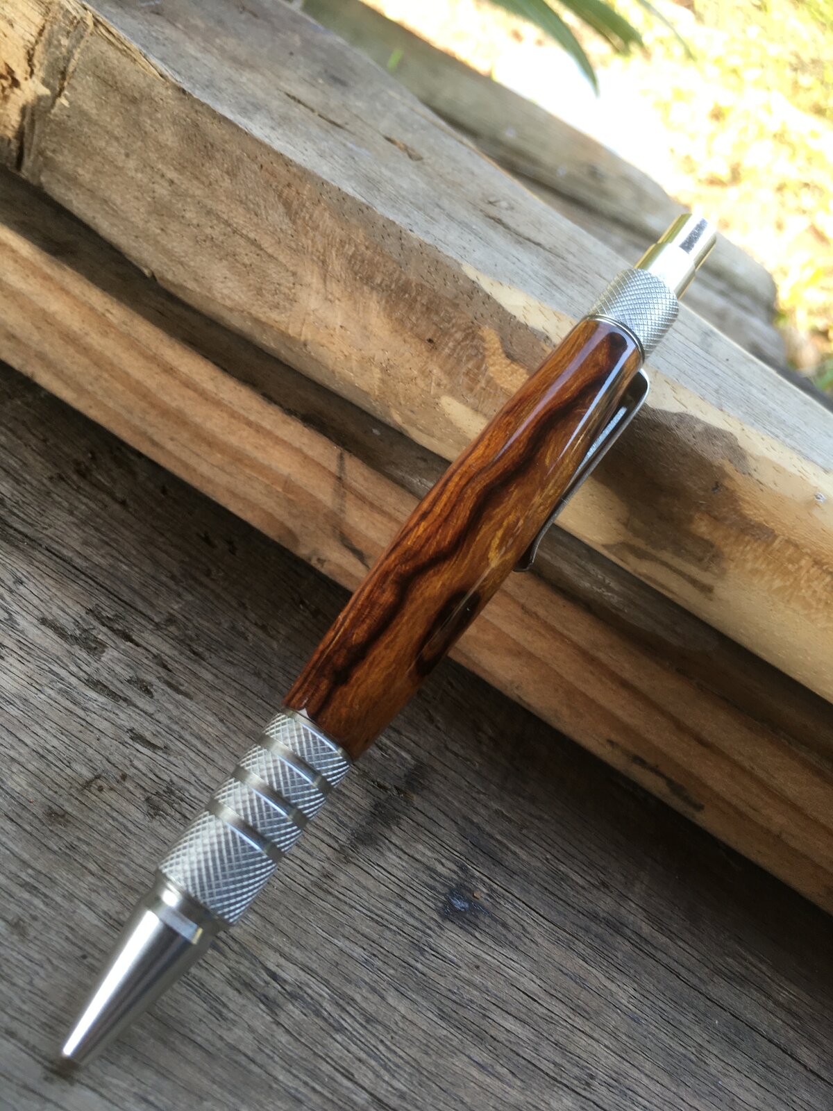

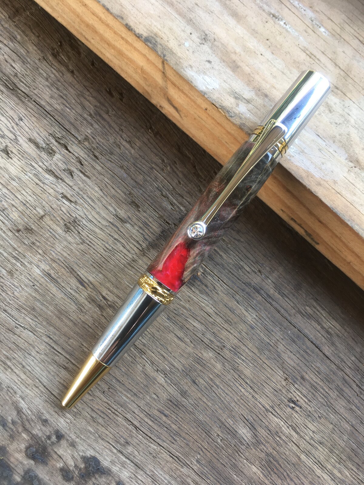

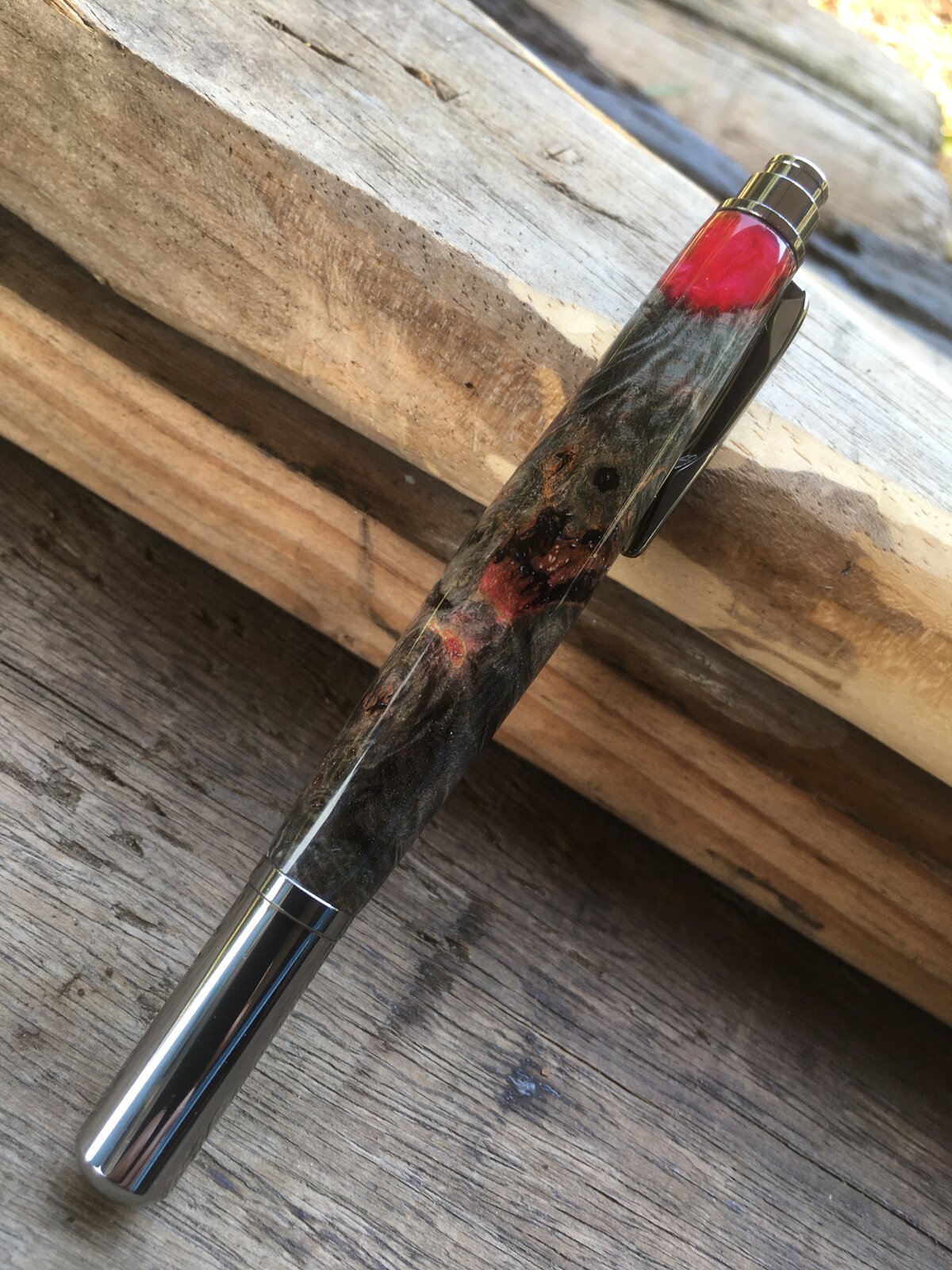

aRM  PENS  -  MAJESTIC  SQUIRE in HYBRID, 22QT ROLL GOLD & SWAROVSKI CRYSTAL.JPG

Hello there MAGPENS
I have taken the liberty to attach a few pics of our recent work so's U know I am quite serious about this !!! Know it's in the wrong place. Nevertheless, these are specially for Your eye-balling !!!
At the outset let me say that regrettably I am not that "Techno-Savvy". Been a Pen-Pusher my whole Life, including even now.
However, have made diligent effort through-out my Life and even produced award Winning Knives. That's another story for another day !!

Thanks for the pictures "aR" . . . is it OK to call you that ?
You certainly have made a good job of those pens . . . . you don't need any help in that department !!!
From the look of your excellent workmanship, I would say that you DO have some technical savvy !!
