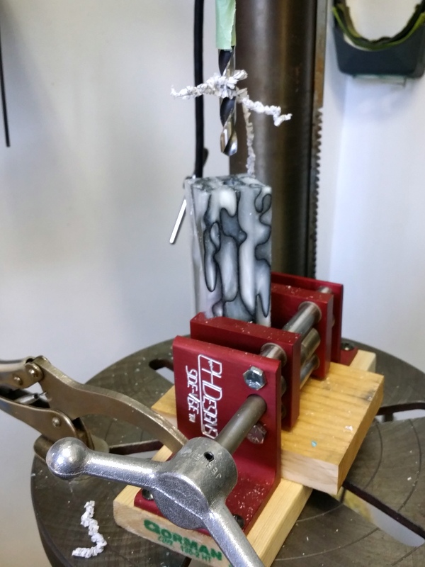

I own the PH Designs (and love it). What is the best way to secure it to my drill press table. (yes, I still drill on my lathe...so I know about that)? I simply want to know what types of clamps or devices that you use to secure the blank drilling vice to the drill press table. Thank you!
Your drill press table should have slots in it.
I used carriage bolts with a wing nut. Only need 1 maybe 2 bolts really to hold the vise in place.

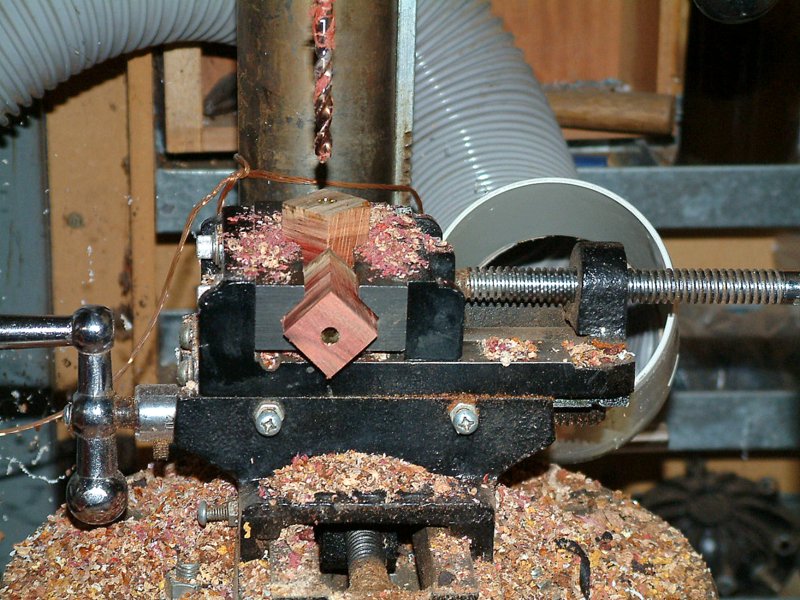

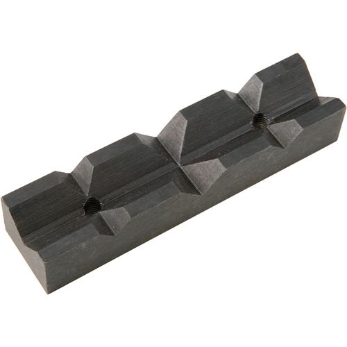

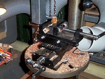

Tony I prefer an X Y Axis drill vice been using mine for a great many years I fitted two prismatic jaws that allow me to easily grip any shape blank I cut a lot of burl to follow the grain. Enclosed some old pics. Prismatic jaws from Grizzly.
Peter.
Peter.
That is a great find. Thanks!
