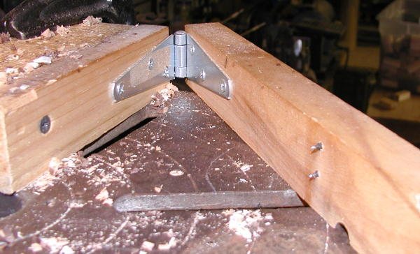

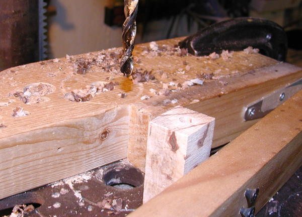

My vice to hold blanks while drilling, On the handle that presses and holds the blank I have two sheet rock screws that extend 1/8' and pierces into the blank to help hold it. I works real good and have drilled over 10,000 with it. I'll try to get a photo this evening.

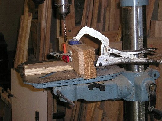

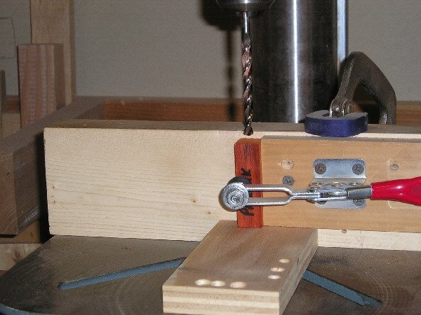

Rob......Here are a couple of pictures of my Pen Drilling Jig. Hope this helps.
<br />
<br />

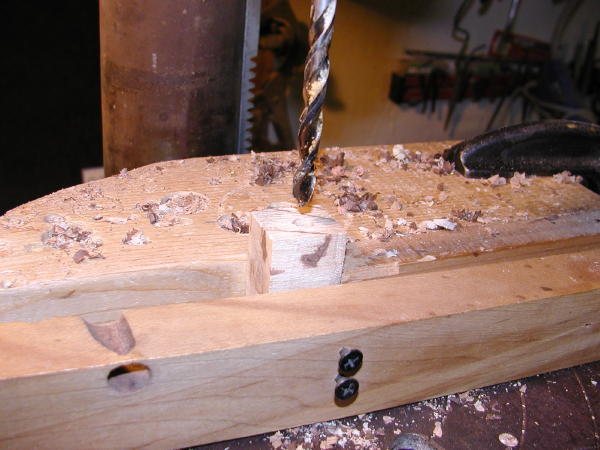

Mine cost less than a dollar and quickly adjusts for different size blanks. The screws holds the blank tight. I can drill dozens of blanks in a few minutes and I have drilled over 10,000 blanks.
