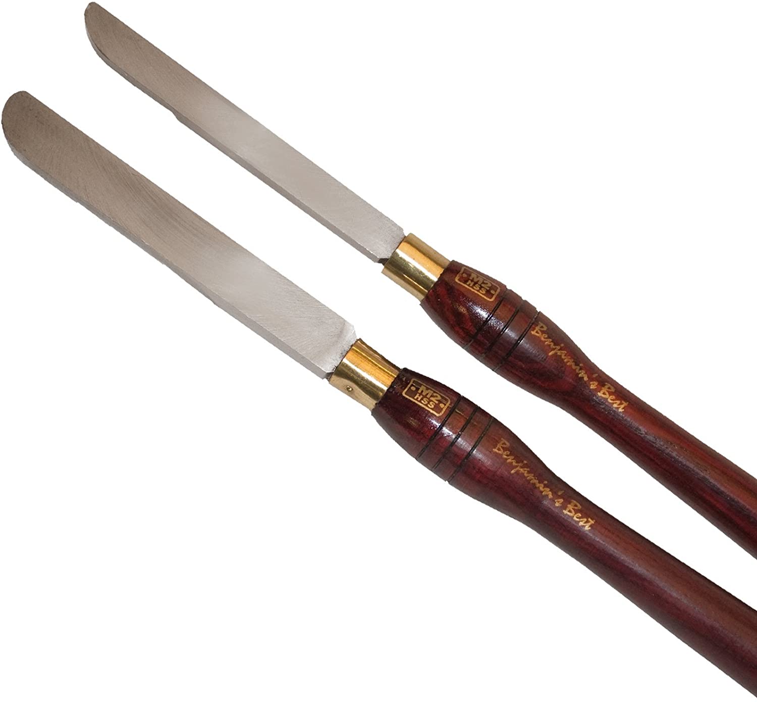

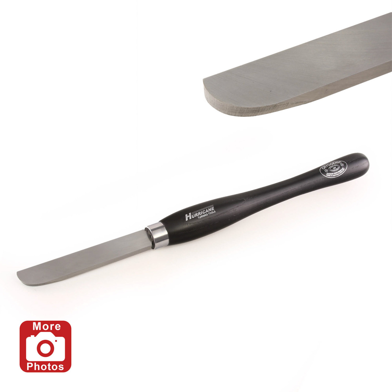

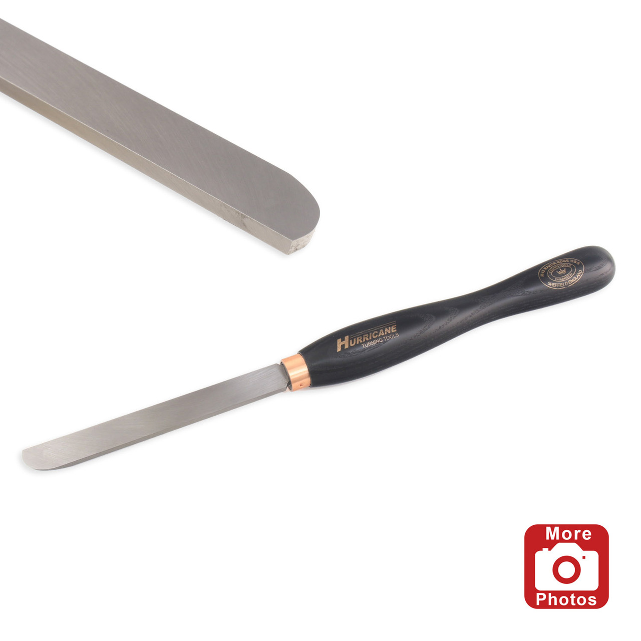

Getting ready to drop some $$ on my first set of wood turning tools and I've got everything figured out except my scraper. I'm primarily interested in turning bowls and could use some advice on which one of these three I should get.
In order, the below pictures are:
1) Hurricane M2 Cryo 1" (x3/8") Heavy Duty Bowl Finishing Scraper....$114
2) Hurricane M42 Cryo 3/4" Bowl Finishing Scraper .......................................$82
3) Hurricane M2 Cryo 1" Round Nose Scraper ....................................................$76
At first I was thinking of getting the cheaper 1" round nose and grind / sharpen so that it has the profile of a bowl scraper. Is it ok to do this, or should I go for one of the other tools that are actual bowl scrapers? And if so, what's the advantage / functionality of the heavy duty scraper vs. the smaller 3/4" one?
If you become a serious turner, you will eventually own both a bowl scraper and a round-nose scraper - and likely more than one of each. (Turners tend to be 'tool junkies'.)
Rather than commenting on the specifics of the tools you mention, all I will say is that you will be happier with the performance of heavy scrapers - light scrapers can vibrate, but a thick hunk of metal won't. Also, you may find yourself eventually either modifying standard scrapers to have a negative rake, or buying negative rake scrapers. Yes, standard (flat top) scrapers can be used in the handle-up position to achieve the same result as a negative rake scraper, but with a negative rake scraper you have the flexibility to work with various handle positions - from absolutely horizontal to slightly elevated or even handle slightly down.
Finally, I don't have a problem with the concept of modifying the grind of a tool to achieve an objective that is different from its original design, but it kinda bothers me to think about buy a new (and rather expensive) tool knowing that it's not what you want and knowing that you will be regrinding it. If the tool that you want is available, it makes more sense to me to buy that tool than it does to buy something you don't want with the expectation that you will modify it to meet your needs.
