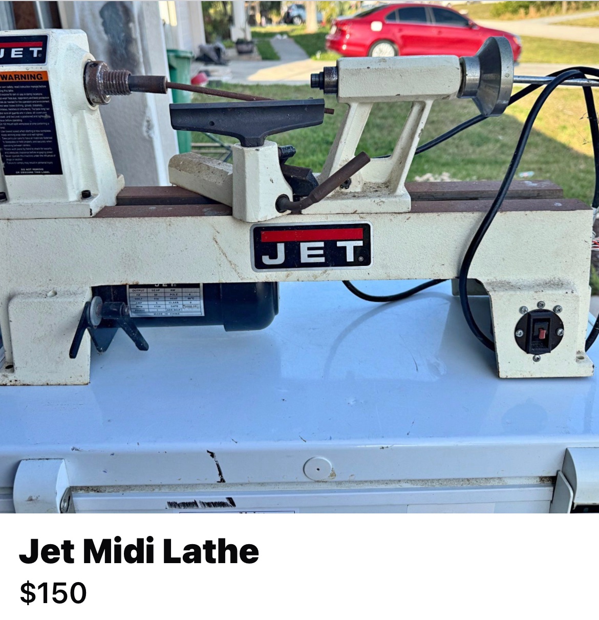

Evening, have turned 2 pens at a class at Rockler.. found several lathes on marketplace. First. Two lathes listed by this seller are: 1. jet midi lathe that needs a new mandrel. Just lathe.

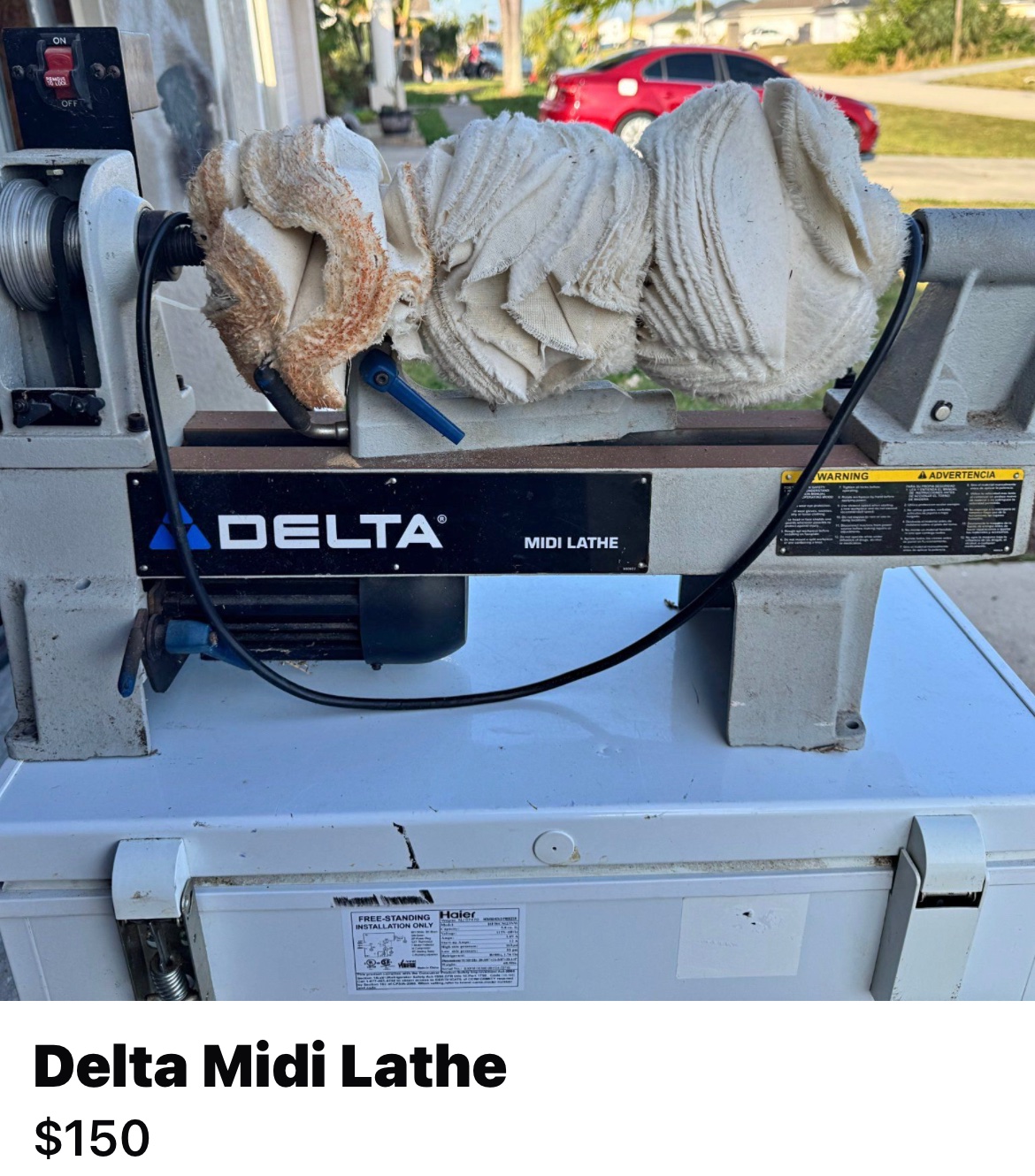

2. The delta comes with buffering pads. Said prices are negotiable. Seller said he would get me the model number in the morning.

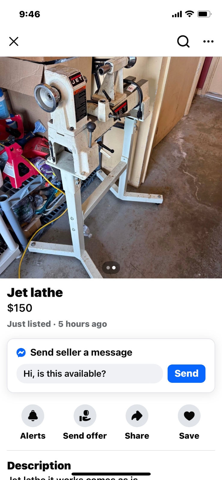

3. Different seller selling Jet Lathe for $150.00 with stand only.

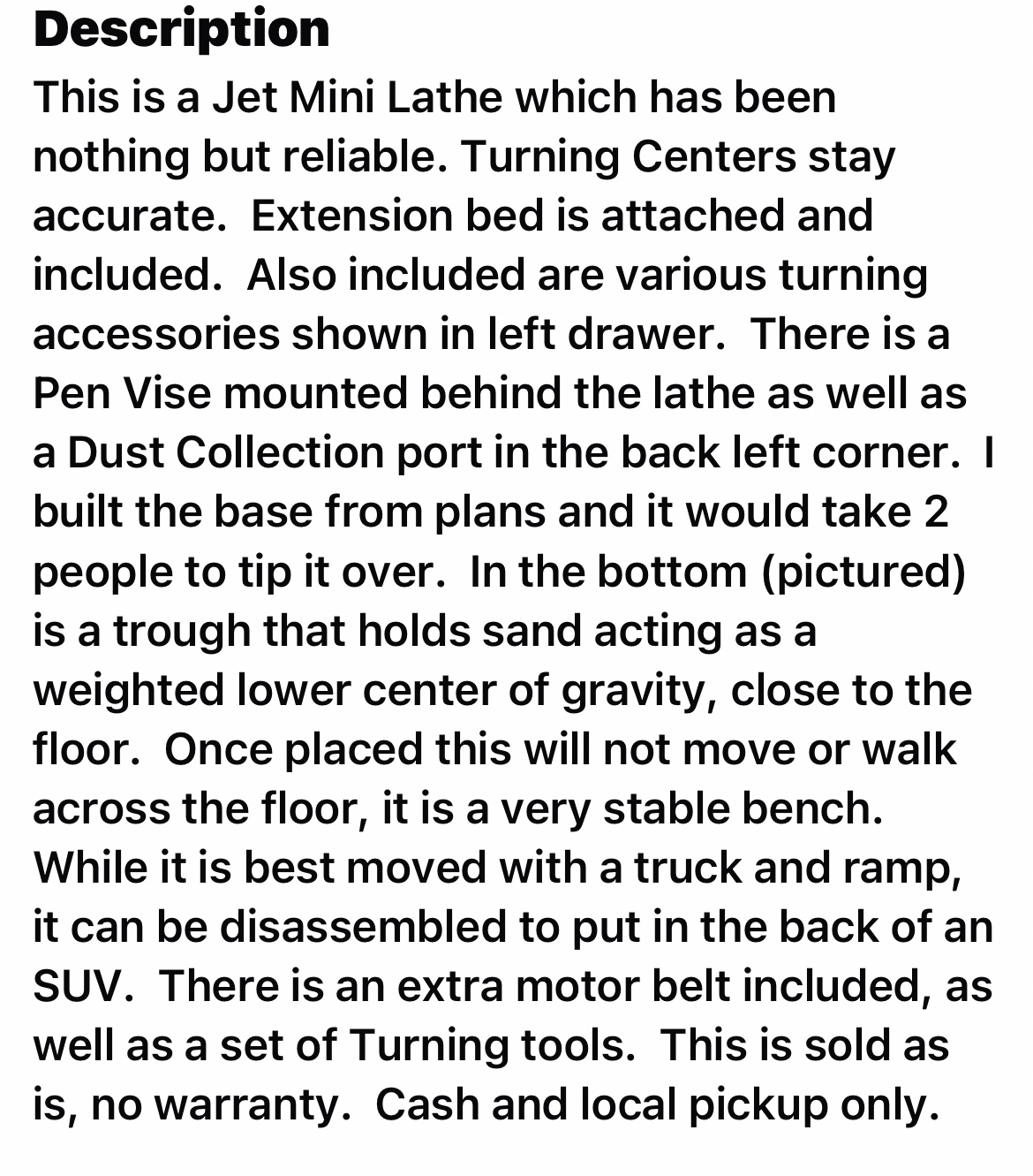

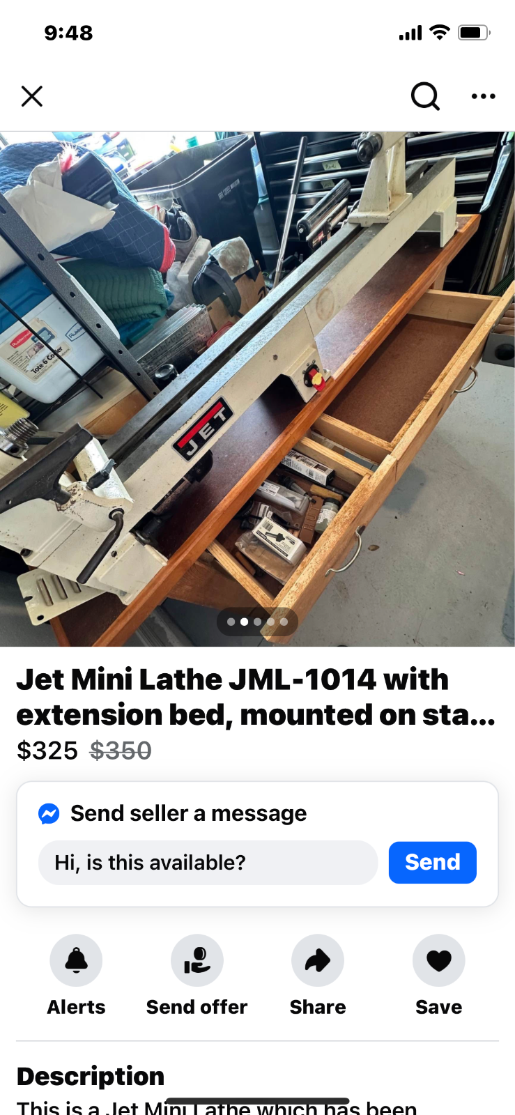

4. Jet lathe with extension, tools in drawer, pen holder and table to mount it to.
Which is the best deal? And why?
Are all lathes digital speed setting or belts? Would prefer digital speed. Which would you go with and why if at all? Good prices for either compared to buying new currently? Which company has better customer service and or parts availability? Would like to get into Pen turning without spending a lot of money in case i decide I don't want to continue with the hobby. At this time only interested in pen turning. Thank you

So does the jet lathe with all the accessories seem a good deal compared to the jet by itself? As in worth while accessories that add true value to pen turning. Is either jet a better model or unable to tell from pictures
Honestly, either of the jets are fine. The bed extension is nice, but not necessary. I've never been a fan of the mobile bases, so to me that would basically be junk and I'd replace it with a cart built out of plywood, with drawers and a base that could be filled with sand or concrete. Weight is your friend when turning. It dampens vibration and allows you to turn pieces that are unbalanced.
All three of those lathes are manual speed adjustments, meaning you have to change pulleys to change speed. This can get annoying.
Both of the jets are the older model, so they have a cast iron head stock, instead of the newer design that has a plastic door to access the pulleys. The newer design is more rounded. I prefer the older square style. The best test you can do is run them through all speed ranges, make sure the motor doesn't have any noticable squeals or high pitched noises. Then, you want to test alignment between the head and tail stock by inserting a dead center in the head stock and a live center in the tail stock. The points of the centers should perfectly align.
Tools and accessories are nice to find, but be aware of cheap tools. See if any of them come with a chuck(s) and jaws. The spindle size of all three is 1inch x 8 threads per inch or 1x8. This is a common size for mini or midi lathes.
The delta is known for having a switch issue, but I believe the replacement switch is still available and fairly easy to replace.
Pen mandrels are essentially junk, don't let the inclusion or need to replace the one that comes with the lathe be a determining factor.
You are also going to want to see if any of these come with tool rests. Be especially careful about this with the delta. If it doesn't have one, walk away, you will easily spend the cost of the whole lathe on a replacement.
If you have the funds, I might buy both jets and keep parts, etc. from the "worst conditioned" one as replacement / spares for the good one.
The way (flat part or bed) of the Jet in the first picture looks either very dirty or very rusty. Just make sure that what ever you purchase you check that out first. Dirt isn't a problem, and rust may not be a problem if it isn't severely damaged or pitted. You need to be able to clean it up and have the tail stock slide smoothly or you won't be happy with it.

Fortunately, lathes are pretty simple machines - the parts that are most likely to be required over time are belts and bearings (readily available from third-party suppliers - and there are lots of them out there), if its variable speed, replacement drive packages. The Delta 46-460 had a unique power switch which has a reputation for failing, and there have been many posts on this forum about the struggles that folks have gone through to cobble together a replacement.
I am the owner of a Delta 46-460 series 1 bought brand new at a Rockler store. About more than 10 less than 15 years ago.
I've turned many a nice pen and quite a few large bowls on this lathe.
I have no regrets learning how to turn on this lathe.
I have replaced the belt once when the lathe started to get a tick in the rotation. After I replaced the belt the tick was still there so I replaced the bearings. That took care of the issue. That was 5 or so years ago.
My on/off switch stopped working and found that they were no longer available for the series 1 but the series 2 switch was available. The problem with the series 1 switch is, the body has a concave area that the contact arm moves in and the contacts became off center to one another.
The problem I encountered with replacing the series 1 with the series 2 switch is the opening for the mounting of the switch is a rectangular hole in the center of the casting of the head on the series 1. The series 2 switch was moved to the edge of the casting and was mounted 90º different from the series 1 switch. After some finagling with the body of the series 2 switch I was able to get it to fit into the series 1 hole but it is obvious it is not the switch that is supposed to be mounted there. All the connections are the same so that wasn't a problem.

If it was me (based on my personal preferences and experience only), $150 for the JET sounds pretty reasonable. I wouldn't put much value on the extended bed, stand, and other accessories - but that is simply because I wouldn't get much use from the extended bed and I would prefer my own stand and accessories. It looks like it needs some TLC with a detailed cleaning, steel wool, Nevr-Dull, and some Trewax. (Another thing that I would find to be "fun" - but that's just me).

Comparing the two Jet offerings the first will certainly allow you to turn pens. The benefit of the more expensive Jet is the inclusion of turning tools. Depending on how nice those tools are they could well be worth the additional price. The stand may also be of value to you. If you are unlikely to turn long spindles the bed extension is unnecessary and will just take up more room.
