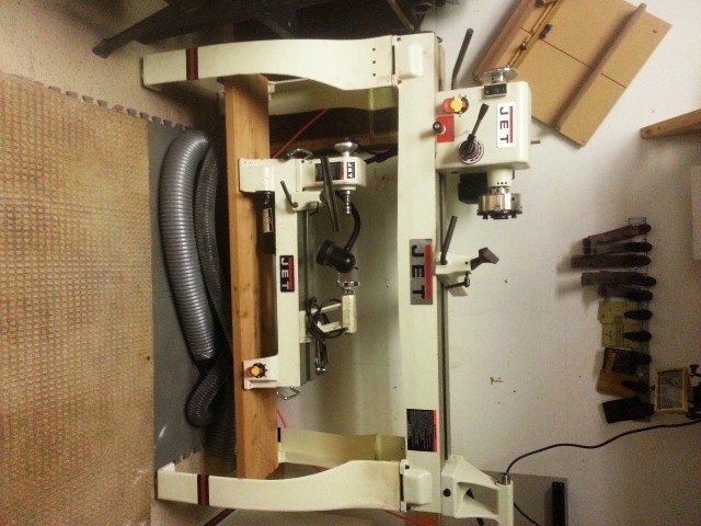

The two lathes I have now are both Jets. The bottom one is the Jet Model # "I'm never going to turn a bowl". The top one is a Jet model # "I now turn bowls"
They both work well......
That mini lathe must be bolted down very well to not slide off the shelf:biggrin: I'm sorry, I couldn't resist the sideways picture.
The "baby" one is a 1220 and is not bolted down, just sits there until I need it. The "beast" is a 1442 and never budges, I also use it as a jack-stand for my car when needed.
