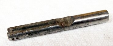

Plain mandrels to match the inside diameter of some common kitless sizes I make.

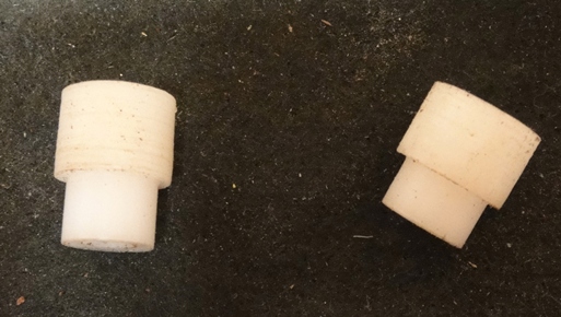

Delrin bushings

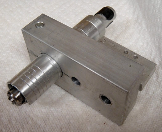

A foredom tool holder. Drilled the larger hole on the lathe with the piece of aluminum stock bolted to the face plate. Didn't have a large drill bit, so I drilled a smaller hole and used a boring bit to enlarge to correct diameter.
