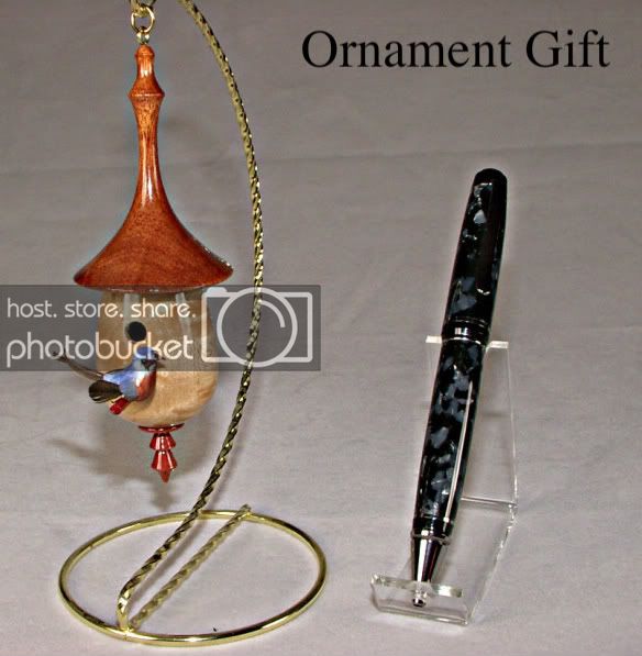

With lacquers you have the advantage of each coat melting into the last and you get that deep clear look. As I said i like to use Deft if I am using a nitros lacquer. And I use it on small thing such as my birdhouse ornaments.

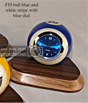

Now if I want to lacquer larger items I will switch to a waterbase lacquer ( Target Coatings Emtech EM6000) I will use this on my desk watches and projects that are larger because I use my HVLP gun and the clean up is very simple. Just water.
Now these type projects do not get the handling like a pen does and i have no experience of using them on a pen because I strickly use CA. Fumes do not bother me because of the way I apply it using good ventalation. Same goes for applying lacquer and I use a vapor mask.

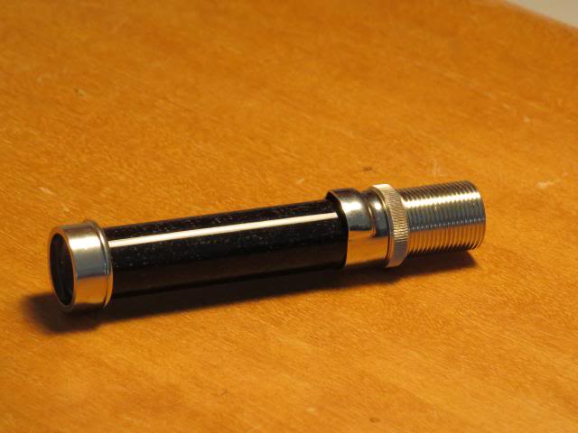

I like moisture cured urethane (mcu), this stuff is extremely hard yet flexible and polishes to a high gloss. They use it to seal concrete driveways and fishing lures so you know it's tough. And it has good flow, brushes on easily and since it's not sprayed a respirator isn't needed but good ventilation is. Re-coat time is about 2 hours with 3 coats being about right.
Not a pen but a reel seat I made for a fly rod awhile ago. A few coats of mcu, buffed with red and white compounds to remove dust nibs.
