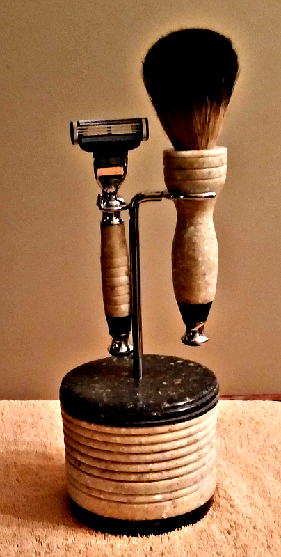

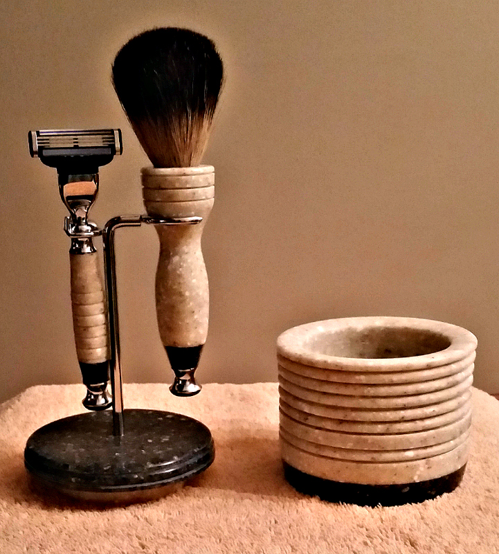

here is a shaving kit I made from corian.
I wet sand both sides ( glue a piece of 100 grit to a 12x12 piece of corian for a flat surface sander) .
I use 15 minute epoxy and clamp it TIGHT.
As you can see, no lines

Not sure why my post did not show up but I wanted to say MaicBob is showing us some more magic. Nice work on this set and you sure can get some nice colors with that material. Good job and thanks for showing.
