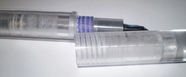

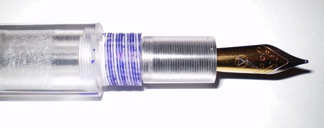

combination of scary sharp bits, speed of turning, clearing out the shavings and keeping things cool are the things i have learned to consider.
If you look at the barrel of this prototype you can see how the material melted. I was going too fast with not enough clearing of the chips. they melt and make a big mess for the cutting tool.
My rule of thumb: big hole = slow spindle speed, and alot of clearing with time for bit/plastic to cool down.
