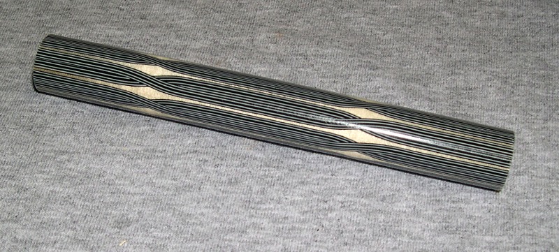

Here are a few more details to answer some of the questions.
The pen is kit-less. The only parts that I did not make are the clip and the refill ( A Schmidt).
The nose cone is made from nickle-silver aka German Silver
Finials, CB, and Section are black Polyurethane Resin.
The pen blank is almost all paper and styrene. The diamonds are wood - Hardware store dowel rod simply because it was the lightest color wood I had on hand.
I used almost an entire bottle of CA just making the blank - Yep, my sinuses are clear :smile:.
I spent an entire day just making the jig for this blank, then 2 or 3 partial test blanks over several days to tweak things. The first full blank had a major blow out (previously posted). All that led up to this blank. It took and entire day just to make the blank.

absolutely stunning.... If you do another one I'd really like to see the blank before you cut and turn it..
Well, I snapped of pic of this blank, as I want sure it wouldn't blow out. Perhaps this also can give a little bit of a hint.
Nice hint!!! and even the blank is great (but nothing like the finished pen)... I can't wait to see what you do for the bash, cause this could easily have been a winner in my book!
