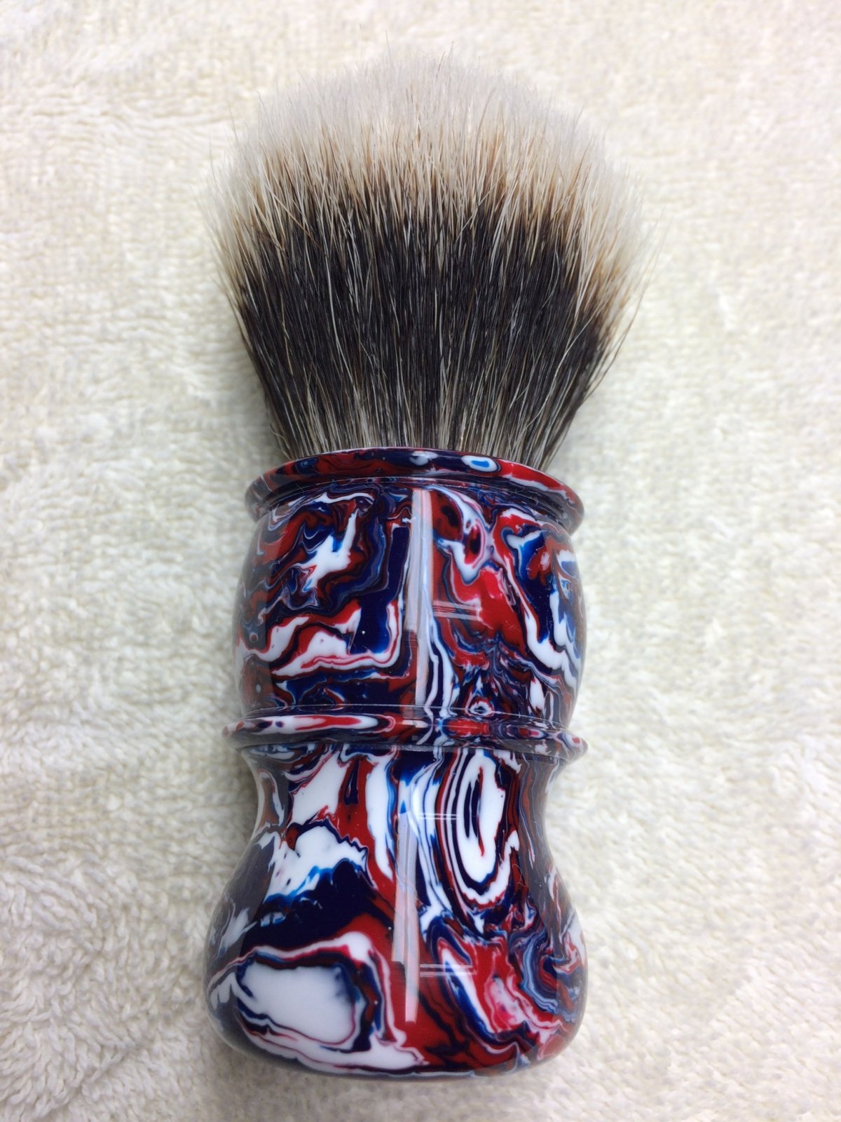

I've used Castin' Craft dyes with Alumilite. Yeah, they're sold to go with Castin' Craft PR, but I've never had any issues. The local Michaels quit stocking them, but they're available on Prime & ebay. Here's a shaving brush I made using Alumilite w/ CC dyes.
