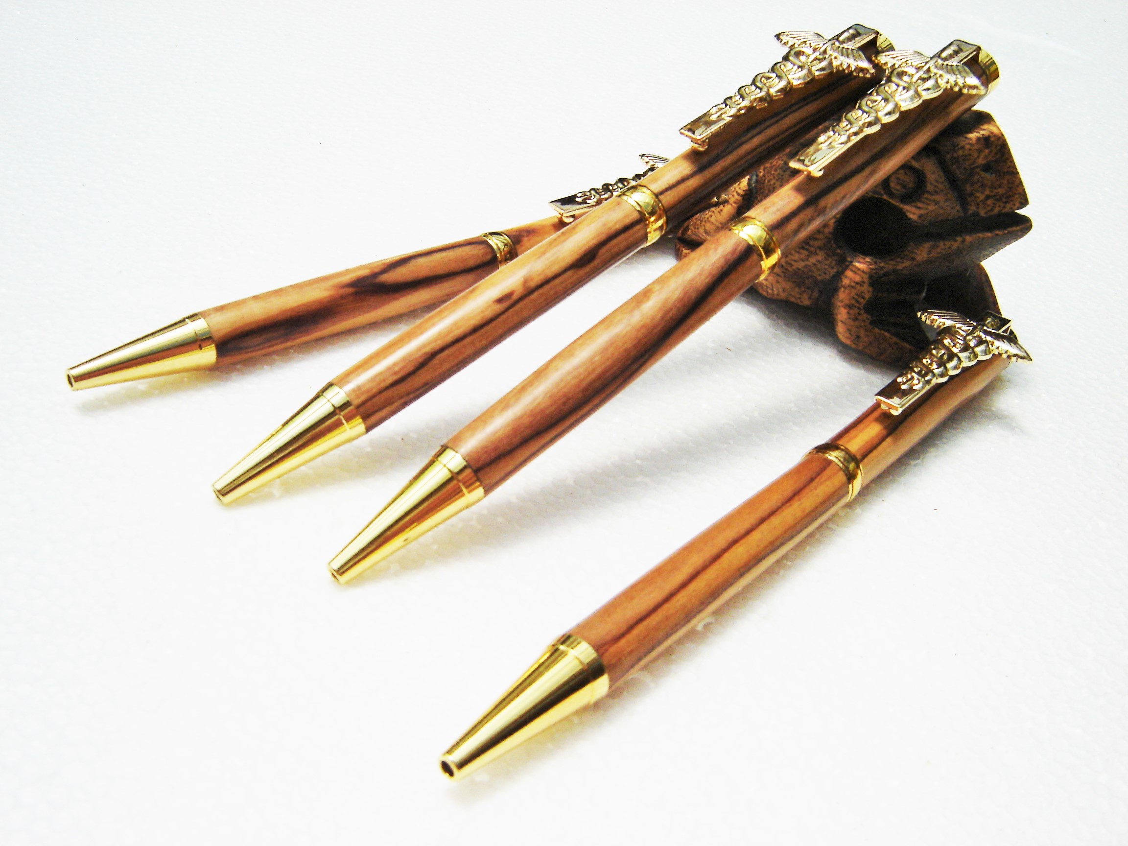

I received so much from these Doctors, that not only did I feel comfortable on a First Name Basis, but I felt I wanted to Share with them something that would be Meaningful to them, of their Profession, that would be Somewhat Unique.
I chose to Make a Gold Plated Slimline, In Bethlehem Olive, and fit a Caduceus Clip.
View in Gallery
While I was delighted with the Pens, I was somewhat disappointed with the size of the Caduceus Clip, it's Wings spread too far.
I considered bending them around the Body, but they were too solid, and I was scared that I would break or damage them or the Plating.
All Criticism and Comments Appreciated.

I agree 100% on the clip and that is why I stayed away from them. I guess the alternative is an inlay blank from one of the laser guys or a decal. You may use a larger kit too. I made a desk clock for one of mine with that symbol in it. Have to agree it gets to the point they become your friend over time.

Did the same for my eye surgeon only I used an American Classic. Same observation, clip is too big and stiff. Nice pens any way.

Thank you for you Critiques and Comments,
Jim (Jim15) I have already given them to my Doctors, and the Reception was very positive.
John (jtheclockman) If I want to do it again (which well I may) I will probably use a larger Kit, I will not use the 7mm Caduceus Clip.
Terry (terryq) They sure are large, possibly dangerous, the tips of the Wings could rip out a nice sliver of skin, if you got caught against it.
Jim (JimV) I found difficulty in locating a Caduceus Clip for any pen other than the Slimline.

I think they are great Brian . The sentiment behind them makes them even more so . I do agree the clips seem too big , even to my novice eye , but I think for this group of pens and the back story of them makes them appropriate with that clip .

Brian, I was able to fit the clip to the pen with some minor modifications. It worked very well. The clips I used look to be the same as yours.

Lovely Pens Brian, the olive wood is spectacular.
I agree about the clips, but that is far outweighed by the gesture.
