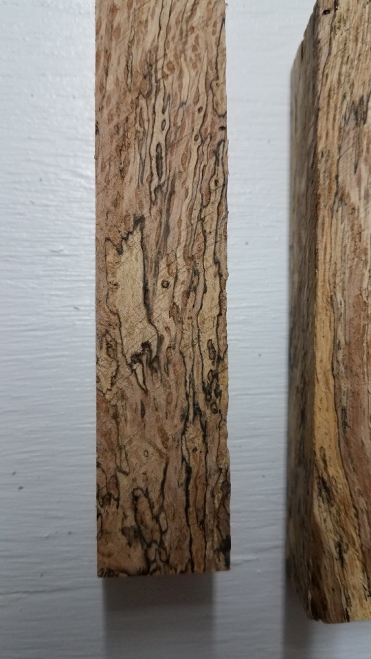

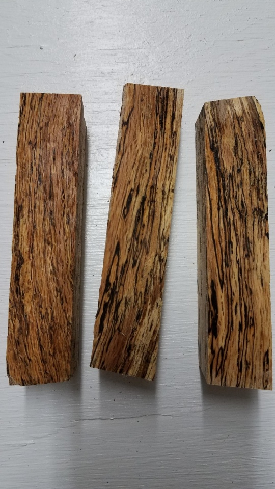

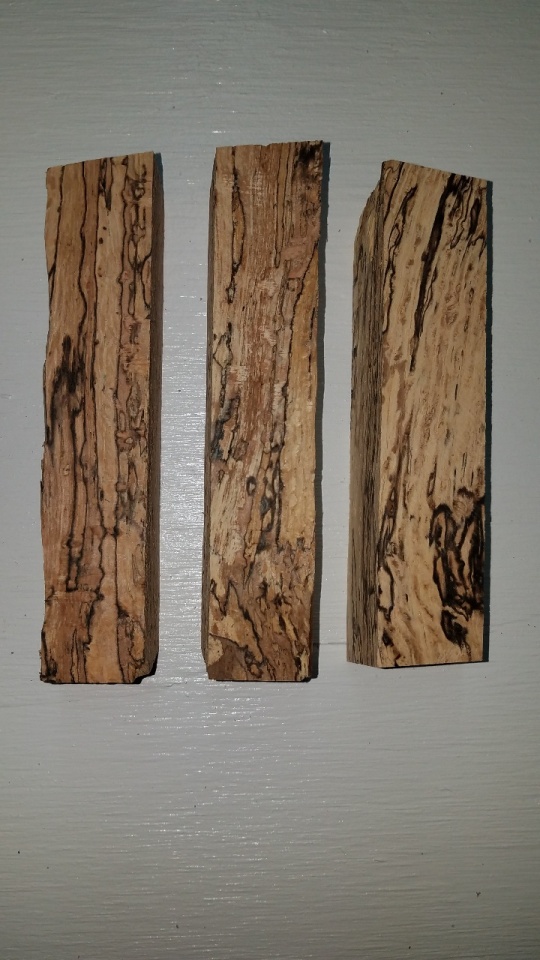

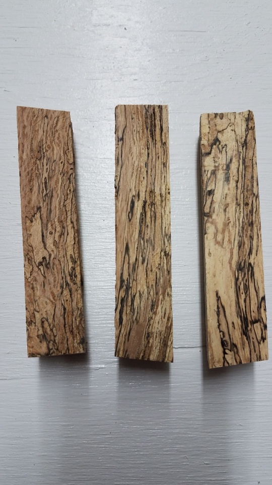

I've been burning wood from a tree that fell in my yard, and thought some of it had pretty spalting.
These pictures are some pieces I cut.
They seem dry and pretty stable, would you recommend having them stabilized? If I don't, is there risk of blanks falling apart when turning?
Thanks, I've never tried turning wood that I scavenged.
Jesse

Need to be stabilized? Yes.
Would they fall apart if not stabilized? it depends on their density and your skill, but more than likely, even with a skilled person it would fall apart.
is the material soft? Can you mash/indent any of it with your fingernail? If so, it is probably too soft for natural turning.
If you have the ability to stabilize then I would. I don't yet, but have turned a lot of this type of wood and only lost a couple of them. The ones with the lighter almost white places are more fragile. They make beautiful stuff and people like them. I have sold every one I made. I have drilled them then pour thin ca in the hole before gluing the tubes in. Maybe this is poor mans stabilizing. Sharp tools light touch and you might be surprised. Give it a try its free ( scavenged) anyway. If you do mess it up just turn it down to the brass and go again. Let us know how it turns out.

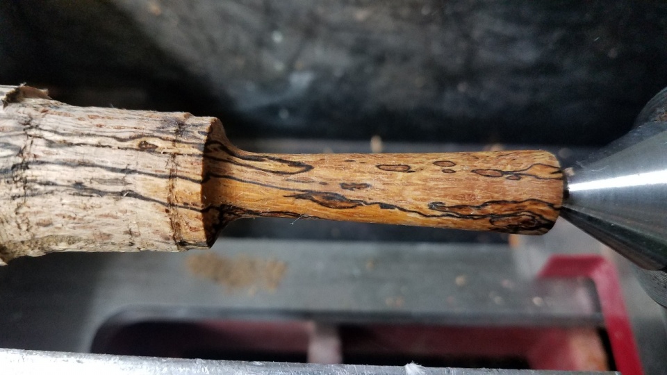

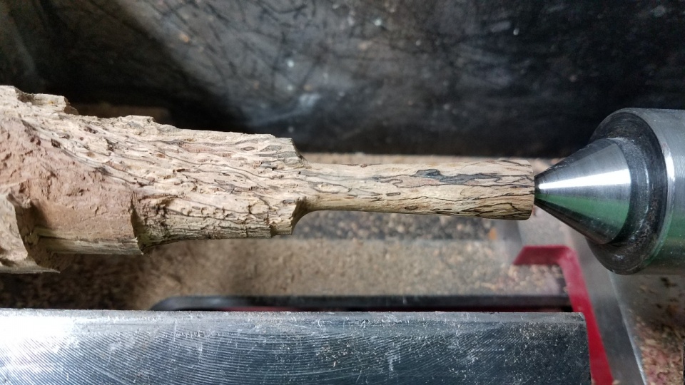

I tried a piece that was too small for a pen, and it actually turned pretty well. I think I'll try using the "poor man's method" with lots of CA and see how it turns out.
(2nd pic is with a denatured alcohol to show the color)

I ended up trying the methods suggested: I turned it to round, and then would switch between soaking with CA and turning. Once I got it near to shape, I sanded it the rest of the way.
It took a lot of layers of CA and sanding to get it to the glass look that I prefer.
I have to say that it took longer than any other pen I've done, but i think it turned out beautiful!
