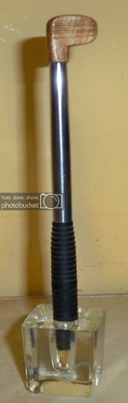

Next time if your take a golf ball and drill it out it will make a nice stand just flaten the bottom or drill and use a peg to hold it onto a base

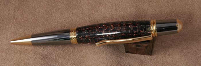

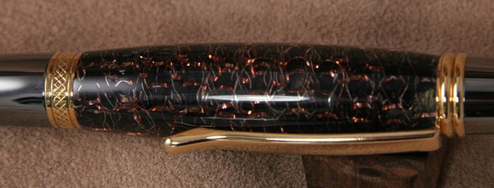

I guess this one would considered my most "Creative". It is a copper pot scrubber cast in clear PR with the hole painted black.
attachment.php
attachment.php
I just wish that they had the Sierra Vista style when I made this. It is a little too "pregnant" for my tastes.

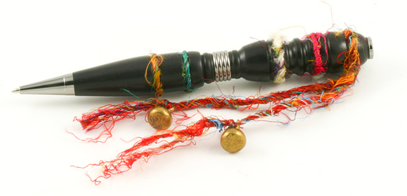

Creative Himalayan Pen
It's not my favorite pen, but it did have a lot of creative juices involved in making it.
African Blackwood. Slimline kit. Silk threads from a Himalayan shop. Brass lotus flower buttons from Napal shop.

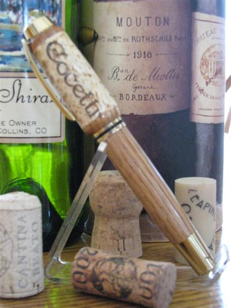

Was the cork in general hard to drill out and turn? Did you have to stabilize it with CA or something to keep it from deteriorating when you drilled it out?

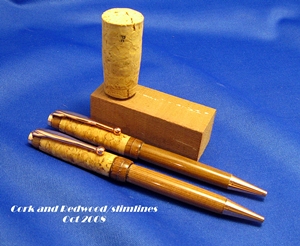

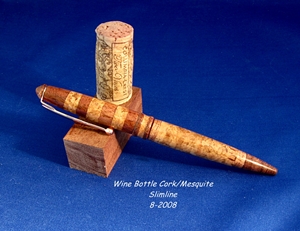

Not hard to drill, I used a Brad point bit. As you can guess from the picture I used wine bottle corks. Just drill about 1/8" at a time and clear. These were wine bottle corks and some 100 year old wine barrel stays. Really smell good while turning. Made for my neighbors that own a winery.

late entry
A gift for the dad who has everything from his son whom I work with at the fire department. A wine cork and oak from the family winery.
Thanks for looking,

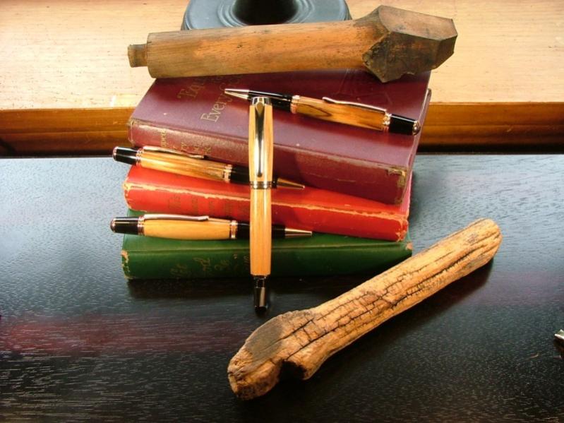

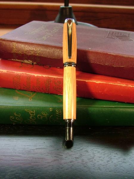

100+ year old Hickory from a Ford Model A
Although hickory is a fairly bland wood... the history behind these is hard to overlook. Made for my grandfather who restores and collects antique cars including a number of Ford Model A & T's, these pens are made from original spokes from these pieces of American history. Since this is supposed to be my most "creative" pen to date, I guess the wood type doesnt really matter.

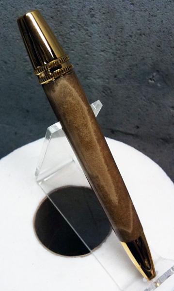

Man there are some cool pens in this post. That Pentel is great. I have to add another so I apologize. The sports pens were cool, but I think my last was my most creative and biggest achievement yet.
I think the material is what makes this pen my most creative. The body of the pen is made from a spollete, which is a simple type of fuse used in fireworks and is made from tightly wrapped paper. It was turned using a skew chisel, lightly sanded and finished with CA.

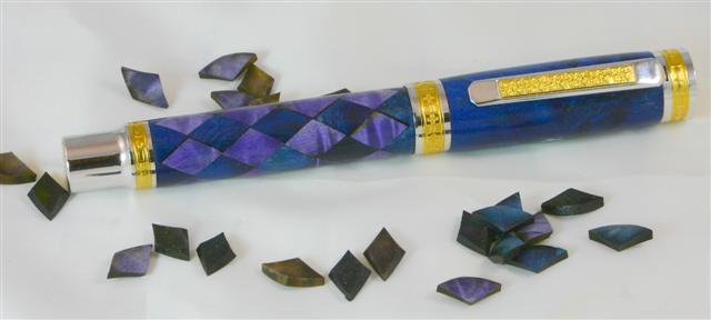

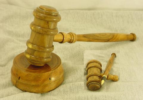

Other than the pens I make with blanks I cast I suppose I have two favorites I would place in this category. Pictures follow and I think they are self explanatory. If not, ask and I will answer.

Don

Don those pens are awesome.
That halequin pattern is great. It looks like you turned 2 blanks to shape then cut out the diamonds and reglued on a tube. If this is the case, how in the heck did you cut them so exact. If thats not how you did it, could you give me a clue. I would love to try something like that.
Darrin
Thanks Darrin. That is exactly now it was done. I did not cut the diamond pieces myself. I drilled and preturned the blue and purple blanks and sent them to Ken Nelsen at http://www.kallenshaanwoods.com and he cut the pieces for me. I then glued the diamonds to the tube and finished turning the pen. Contact Ken if you want to do one and I'm sure he will help you out. Mention this pen and he will remember...he probably will anyway. We had fun figuring out how to best do this. The pen was a special request from a customer. I will be doing more of these in other colors.

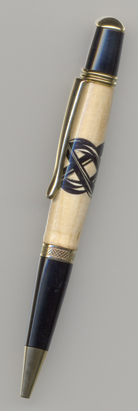

This one has been shown a couple of times now, but is the most creative of my pens. I wanted to use a table saw instead of a bandsaw to make a super thick celtic knot, and the Colorply looked like it was gonna be good for the job. I did the turning after he walked me through installing the knot into the blank. We both worked on the CA finish.
attachment.php
