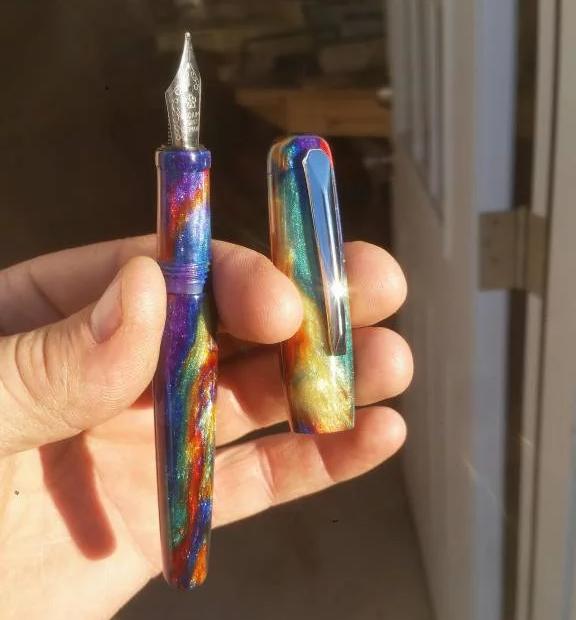

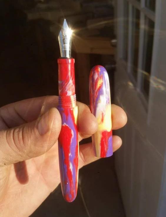

Timing is key for sure... and don't go crazy trying to swirl it all up. I've switched to alumilite slow because my process takes a bit more time. Certainly is a little less hectic having that extra 4 minutes of time!
Time it right and you'll get good separation. Couple of kitless a buddy turned from my blanks.

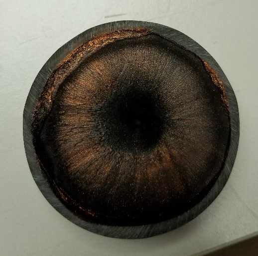

Although you can get some really cool effect from the movement within the resin while in the pressure pot. And here was my latest attempt. Looks like an eye. Wasn't really what I was going for, I didn't mix the 2 at all, just blooped the copper in. It mixed all by itself.
The movement always seems to be in a torrid direction, down in the center and up the sides. I assume from the movement of air bubbles, and possible the mica power itself, while being compressed. This movement would be limited if the material was starting to gel.
