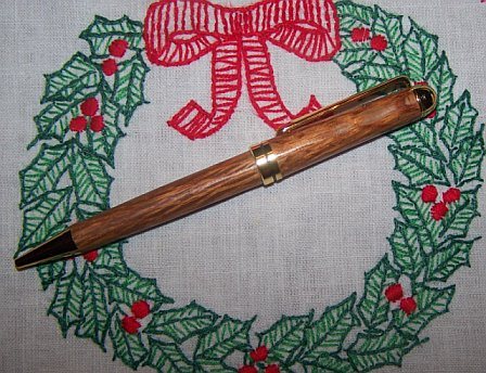

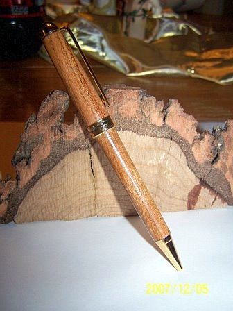

Hello,
I'm trying to learn the art of penturning. I have turned a few slimline pens and now I am trying to progress with this kit. I'm not sure of the name of it. The blank was leopard wood, and the kit was from CSUSA. I tried to put on a CA finish, but that did not turn out like I like.
So my question is what would you do different. Would you use a darker wood blank witht the gold, a different kit with this type wood. Anything would be helpfull. Yall have always been very nice before, but please dont sugar coat it, i'm looking for advise.
TAld

James, it appears to be a Round Top European. It looks fine to me as far as your turning skill. As far as the CA finish goes there are some very good articles in the IAP library you may want to read. And many people here who can help.

This pen looks great. You asked if we would use a different kind of wood. If the pen looks the way you wanted, then it is a total success. I have even turned pens that I was completely disappointed in and have had people drool over them. I don't think there is a truly ugly hand crafted pen.

I like the pen too. I started to say that I think leopardwood grain shows better on a bigger pen. I keep looking back and it really does look great. With CA, I totally agree with Gary. Sometimes it goes on great first time, other times it just doesn't. I had to try 3 times on a pink ivory pen I just finished before I got it without sanding through [B)]. Oh, and a sierra I did, same problem! Something to try, I've been playing with different combinations of glues and what seems to work best for me is 4 or more coats of thin put on with a soft paper towel, followed by 3 coats of medium with no sanding in between (unless it got too rough).

I think the wood and plating works togather well, although I am drawn towards the chrome more myself. As for the shape, I would stay away from "under turned" or straight looking upper barrels. The straight works well on the lower body, but the photos shows a slight concave in the cap. This pen really needs a profile that bevels in towards the smaller diameter cap.
Keep working on the CA finish, I went a long time before I nailed my method with the derlin strips, straight CA then a sand out and polish. I have never been hapy with a CA/BLO finish becasue I personaly could never get a "glass gloss" from it myself.

I think what your saying is I need to turn more wood away toward the cap. You said it so well, and I'm such a newby I just want to make sure I have what you said clear. I have two more of these kits and will try this on the next ones.

I agree with most. It is a good looking pen!
I also agree with Fyrefighter, the top barrel is too straight. I don't think you should turn the top part thinner, but on the next one, leave a little more in the center and slightly contour to the tip from the mid section up.

I can see what appears to be some circular sanding streaks in the finish but it could be the reflections of refracted light for a fluorescent bulb. Finer sanding or polishing. For me, it took me 1 1/2 years of "off and on" turning to get the CA finish down to a science for me, my technique and feel.

By the way, my thought was the same as Steve, you need a bit more wood on the cap, fill in that divot in the middle and bulk it up a bit. Pens can look good straight of "bulked up" a bit, but it's hard to pull off a concave body without just looking underturned.
