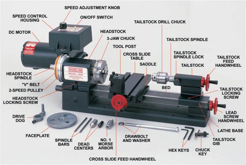

So I know I need some sort of tool holder, the missing parts to the tail stock (or a new tail stock), and hand wheel for the feed at the bare minimum.
What am I missing?
Thanks,

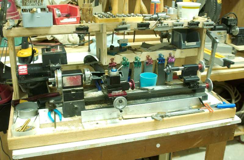

I have a Sherline 4400 if you have any specific questions. The motor will stop before the switch hits the lowest setting theres nothing wrong with your setup. Its an electronic variable speed thing. The best place for used parts is ebay. Also look for parts like chucks under Taig lathes. they both use the 3/4-16 thread on the head stock. Do not get the 4 jaw chuck sold by 800watt on ebay it works but is not accurate at all. The Taig brand wood tool rest set up is much cheaper than Sherline's and will work but you will have to re drill 1 hole to move the dovetail clamping piece forward to fit our lathe bed. If you get the riser kits which I recommend the Taig wood rest will slide Right on to you cross slide. A Qtcp (QUICK CHANGE TOOL POST) is great when you get really going. The Sherline website. Sherline.com has all the diagrams and parts for repairs and replacements as well as user videos you can watch, discountcampus.com sell all there accessories about 5% cheaper than the Sherline Website.

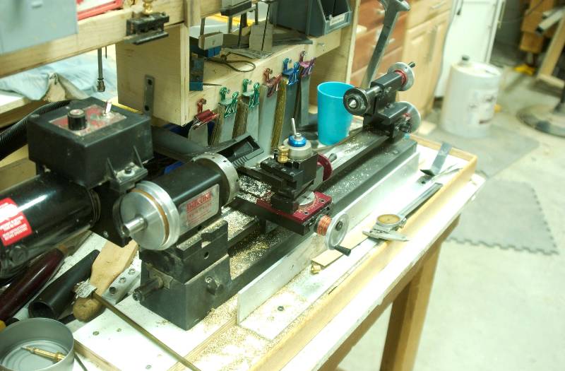

I found A2Z earlier this morning and have been wading through their site as well as the Sherline site off and on today. Its a bit overwhelming what I "could" get for the lathe and am struggling to figure out what I need instead.
I think I have it paired down to the bare minimum of a Cross Slide Table w/ Handwheel, Tool Post (quick change would be nice), Lead Screw Handwheel, and complete Tail Stock assembly.
There are a few other items that fall right after the above such as dead centers, drive spur, and jacobs chuck or live center dependant upon what I wind up with once I have a replacement Tail Stock.

The hardest part for me right now is matching what I see with a part name and a function.

If you buy a tool post make it a rocker style, dont worry about the dead centers to start go right to the live center first. Get a 3 or 4 jaw scrowling chuck. the ones sherline make are great but the taig will work and are cheaper. I have found the sherline to be a little more precise. The aluminum angle in the front is for a very low tech low cost stop for the cross slide when your cutting shoulders and need to repeat the cuts. I have a Qtcp mounted on top of the compound slide. It lets me make angled cuts without having to remove the tailpost and put on the compound make the angle cut and then redo everything back to do regulaur turning. They dont come that way from the factory i had to mill the groove in the top of the compound slide myself. The sandpaper is Curtiss Seebecks tip on gluing strips together with wood glue and then I used office clips to hang them in order of grit. The top row are the Qtcp holders with the bits i use hung on a dovetailed piec of wood cut on the saw chopped into 1in lengths and glued stapled to the top shelf area. Get a set of cheap carbide cutters to start and a few high speed steel ones off ebay etc. The 3 or 4 jaw chuck and a live center will let you do most of the work you wil need to start. If I can be of further assitance pm me.
