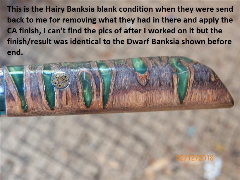

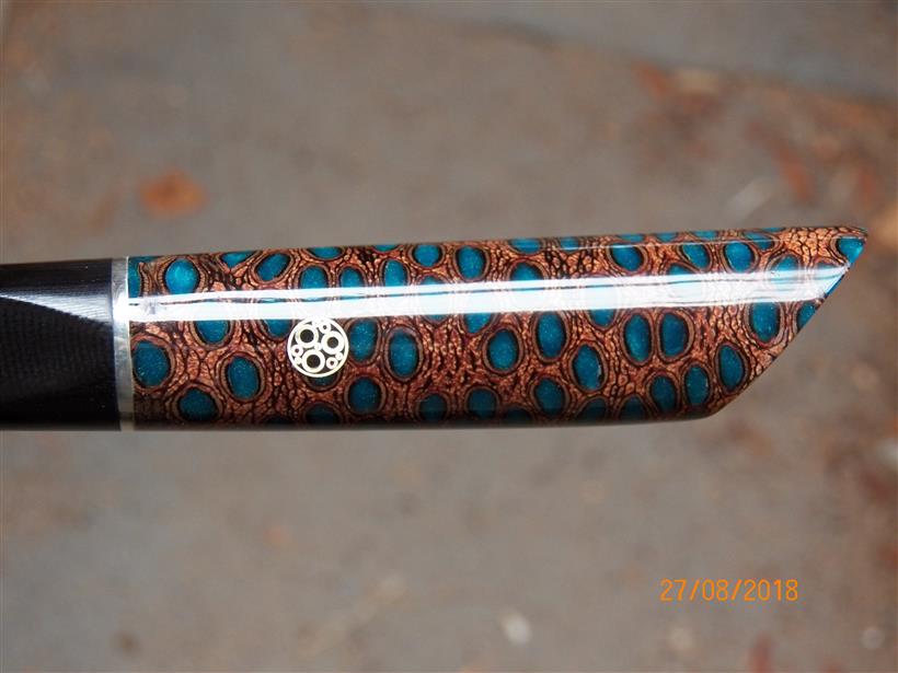

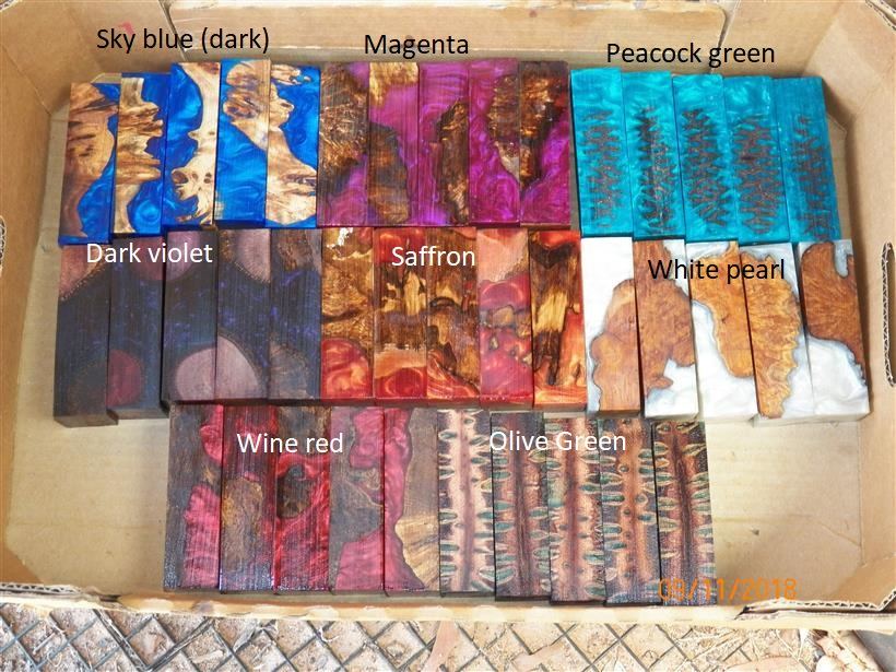

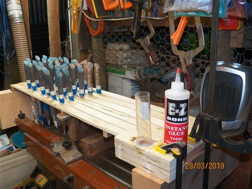

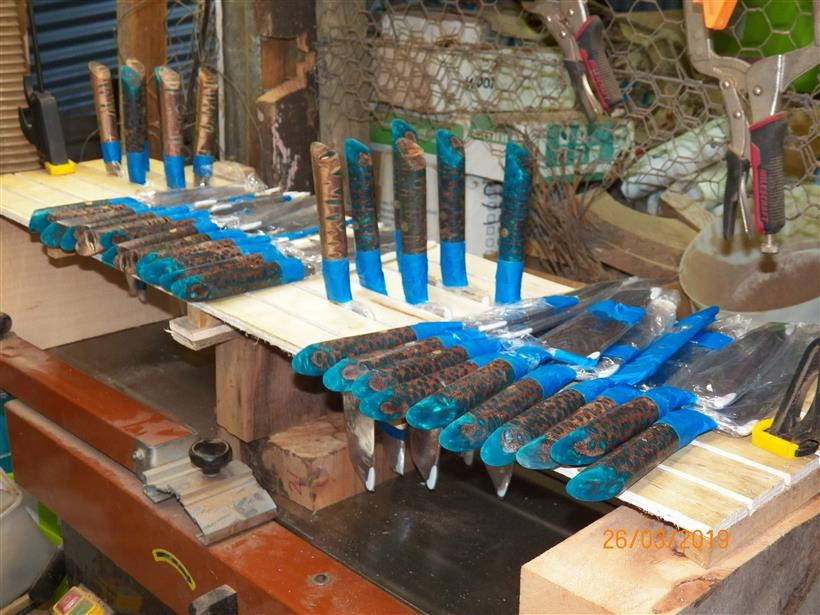

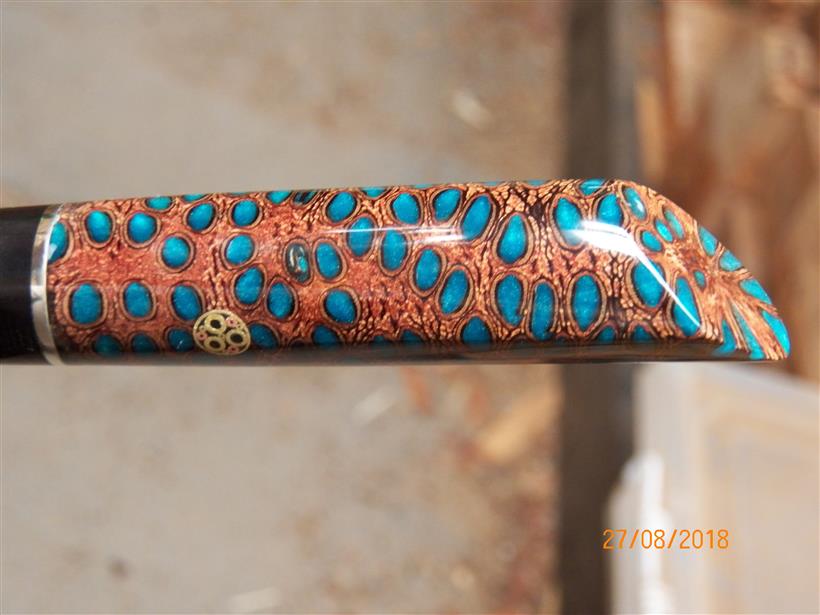

Yeah, I think you guys said it all, is really anything out there (anywhere in the world) that can "replace" the CA finish when it comes to application to non-round items, I'm talking specifically about knife handles shaped from the Hairy and Dwarf Banksia I produced for these 2 guys from Adelaide, All the handles were sent to China where the blades were made and then inserted into the blanks I made, 8 types on the first production and 6 types on the second production about 700 in total but in China they don't really know how to work and finish the Banksia blanks even though I made a tutorial video and dozens of pics showing what needed to be done but in the end, the banksia handled knifes had to come back to me as they failed to apply the CA finish as requested, the whole handle structure was totally compromised firstly with the wax and later varnish coatings that I had to remove to apply 6 good soaking thin coats of CA (mainly the first 2 coats/dippings), the issue became even worse when I find out that the knife tung (what goes inside the handle) is barely longer than the plastic and metal ring they used as the ferrule, therefore, is basically nothingto suport and give strenght to the handle/pod and that is not as I believe it should be.
Anyway, I may do a bit of a story on these knives handles I created and some of the requirements that have to be met to not compromise my work and some of the unique materials I use(d), some of you already know how important to take those extra steps with some of my blanks, Banksia blanks specially, the finish type and product use will determine how long that handle will last, these guys have put a lot of work to get these knives together, I have side by side with them and making sure the right methods are used in these handles, my name in on them but is a lot than my name, is need to make the expectation and trust these guys put on me but also the expectation to those that are buying their knives, their Kickstarter went extremely well and their new website is coming along nicely, they named them Koi knives.
So, and going back a little bit, all the other type finishes I have available to me here in Australia, many I have tried and some are simply not suitable, wipe and poly(ish) type has the drying problems mentioned by some of you and the fact that they don't offer the durability required, I have created this post because I read a few comments on here about some new products that some folks were using instead of the CA, those are the products' names I was after so that I could do some research and decide if is worth to have them sent to me for testing.
