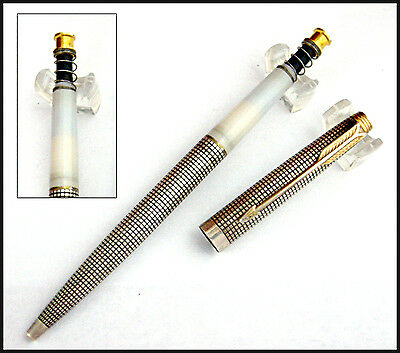

The Parker 75 ballpoint was cap action. If you can find someone who deals in spare parts, it's a much easier solution. Basically a screw-in.

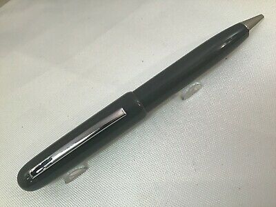

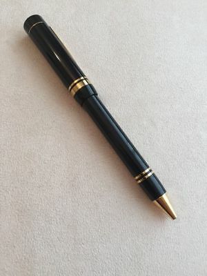

I found a couple of pens that looks like it :
But I can't seem to find any kits like this. Looked at berea, but didn't have any luck. Any other suggestions?

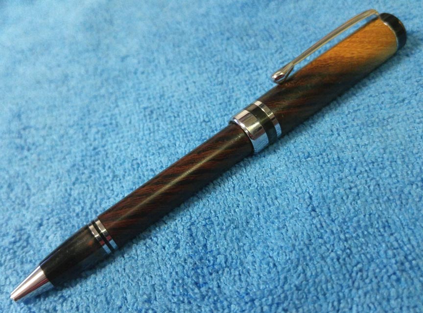

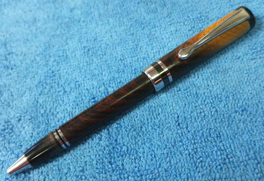

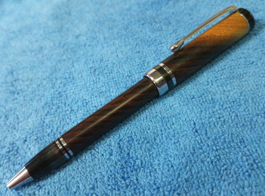

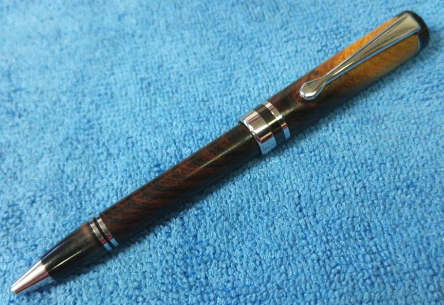

I made this one years ago. Woodcraft used to sell the kits, but I haven't seen them in a long time.
