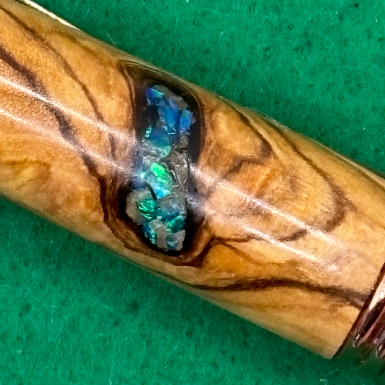

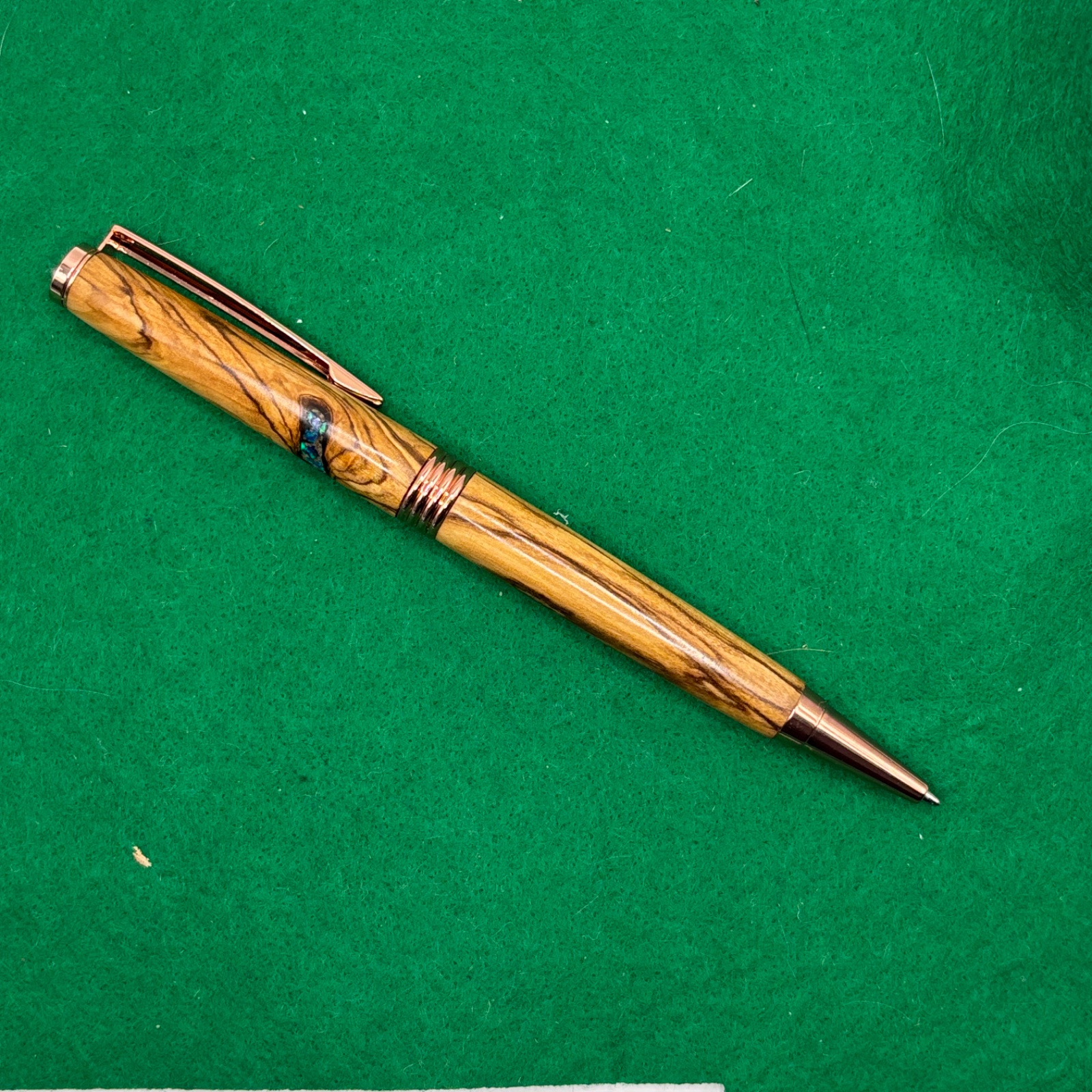

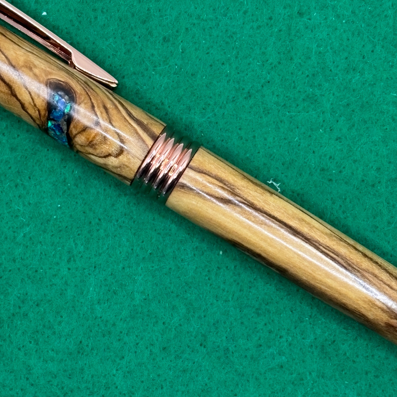

Decided to make a Bethlehem Olive broad ballpoint, only to discover a knot hole that wasn't observable prior to turning. Didn't want to waste it so made it a feature. Filled with some crush opal I had bought years ago when I thought about making rings. Put it on Facebook and sold within the hour.

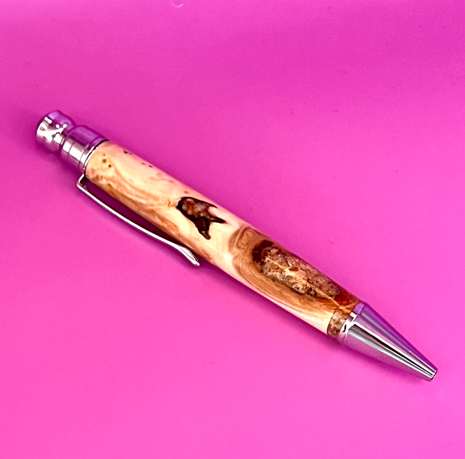

That looks great! I love the "defects" in blanks - they make the piece so much more interesting. Here is a pen I gave my brother that I hated to give away! Many years ago I was in retail and sold handcrafted crystal. Waterford crystal is mouth blown and hand cut by experts who learn their craft for years. Not one piece is the same as the next when you have a good look. There are small inclusions/gas bubbles/cutting differences etc. That way you know it is truly handmade by an artisan - not pumped out from some soulless machine. It is no different to our work - embrace the oddity as it proves it is a real product made by a caring person.

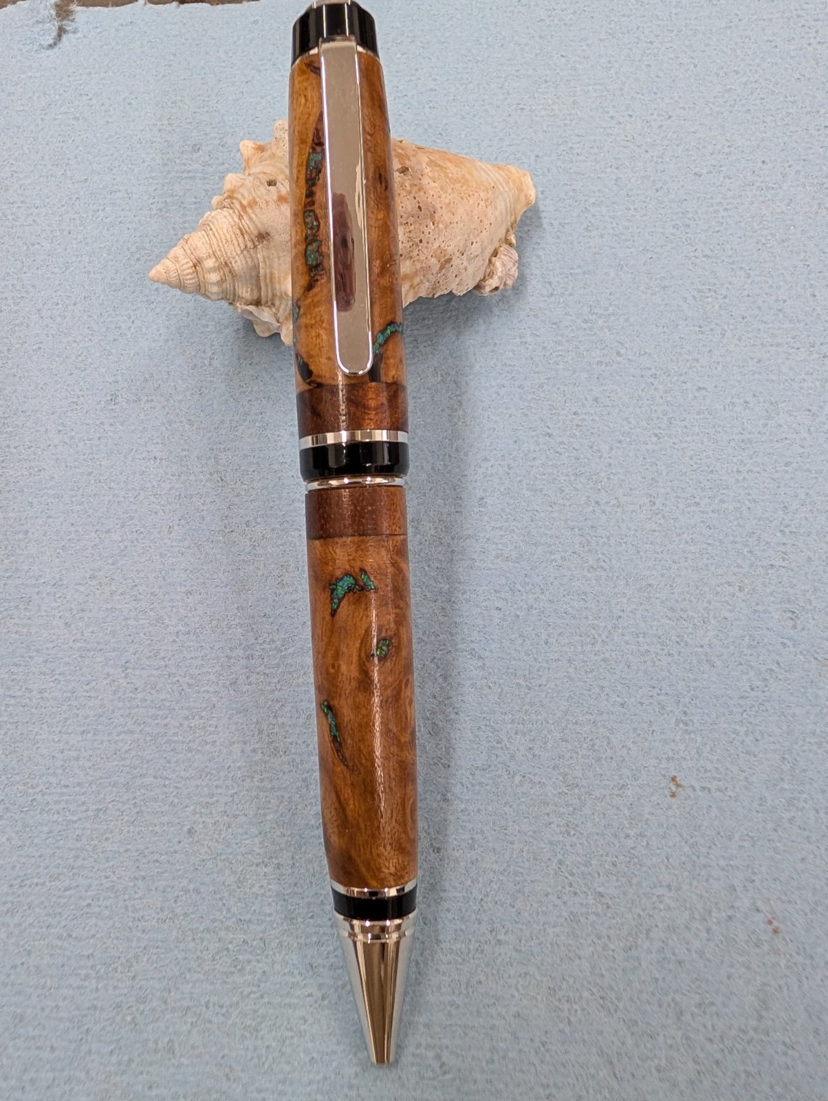

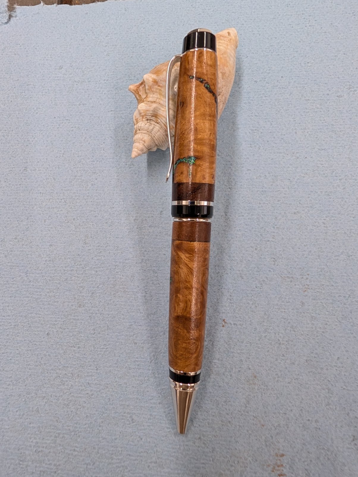

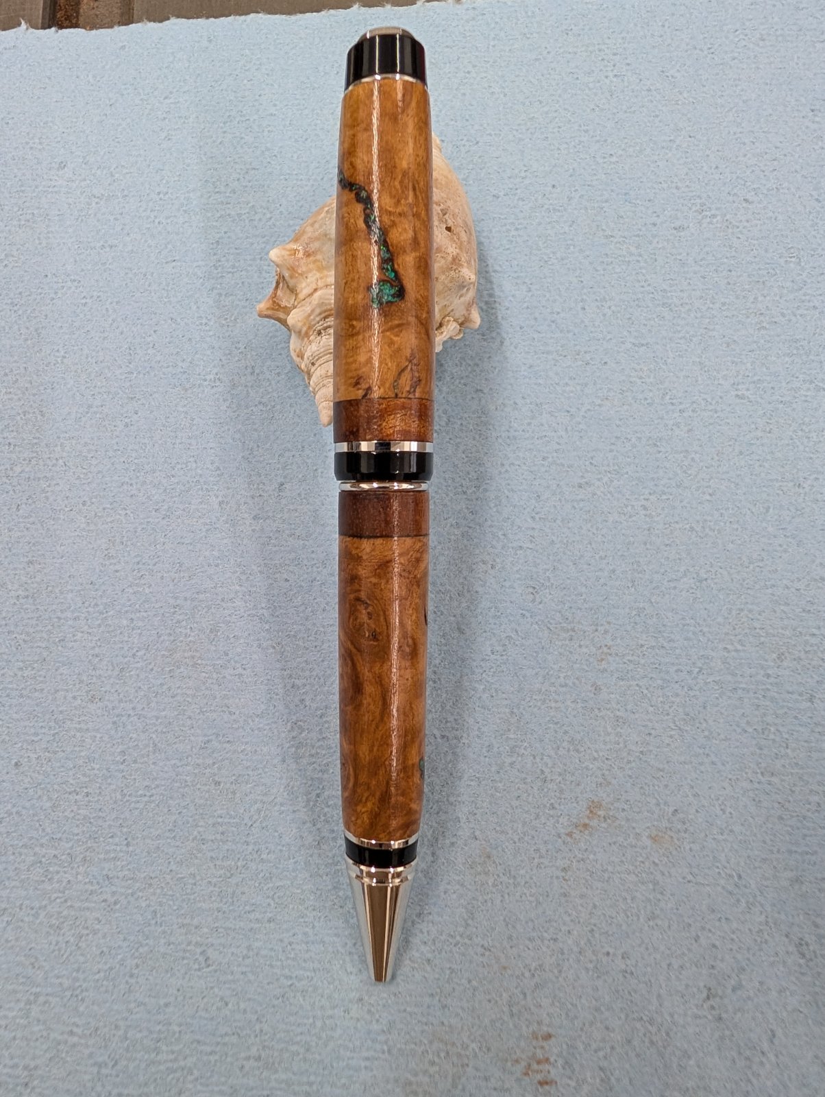

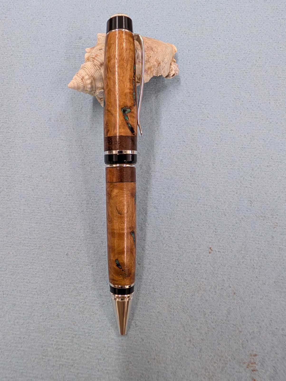

I've had the same type issues in the past. It sounds like you and I are on the same wave length. Here's mine in some kind of wood and Koa on the center bands. I know the wood had lot of worm holes that were filled with poop that I cleaned out with a straight pen. I used crushed Opal on mine too.
WCK, what kit is that?
To answer the question, not necessarily a defect but a chip or delamination between the tube and blank (glue present?), I set the kit aside until later.
Often little holes in the material can be filled with clear CA and when polished the surface acts as a lens and looks like the inner surface is pulled up top. Often hard to tell its a hole.
The kit name on this is Big Ben Cigar Pen from PSI (PKBIGP). Nice pen and they sell pretty well if priced right.
