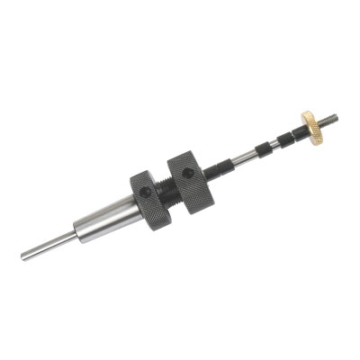

I've been turning a bunch of pens as Christmas gifts and have had several instances of uneven material around the tubes. Ive mostly taken care of it with light touch ups and sanding but its still lopsided to some degree. I wasn't sure if I had a wobble on my lathe or if my bushings were just worn but I bought some new bushings and still had it happen so rules that out. I'm at a loss at this point. I'm using a jet 1221vs...thoughts?
If you are using bushings on a mandrel, you may have the thumb nut over tightened. This will actually cause the mandrel to bend, causing what is called out of round (OOR) There is a certain spot in snugness with this thumb nut. That is, too loose, the blank will stop turning when you touch the turning tool. Too tight, the mandrel bends. Best solution is turning between center bushings (B2B) , that eliminates the use of a mandrel. Some of our vendors supply these bushings.
Thanks, I forgot to specify. I'm using a mandrel with a mandrel saver in the tail stock. I'm relatively new to pen turning so ill do some googling on your suggestion. Thanks!
There is obviously a wobble somewhere, I'm guessing in the headstock. Believe it or not, it could be as simple as a dirty Morse taper. It's happened to me. Try cleaning all the internal and external surfaces of both tapers with a little solvent and see if that helps. By the way, which mandrel system are you using?

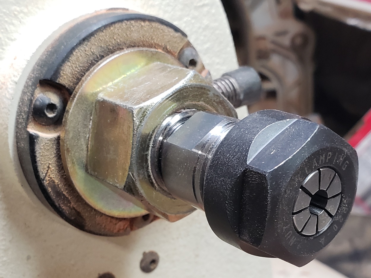

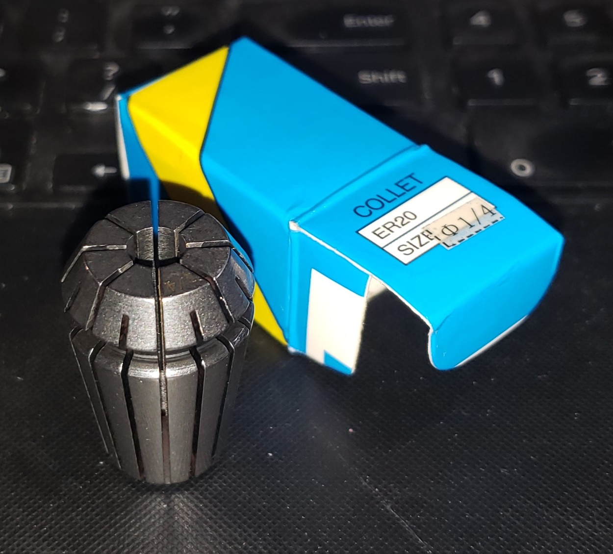

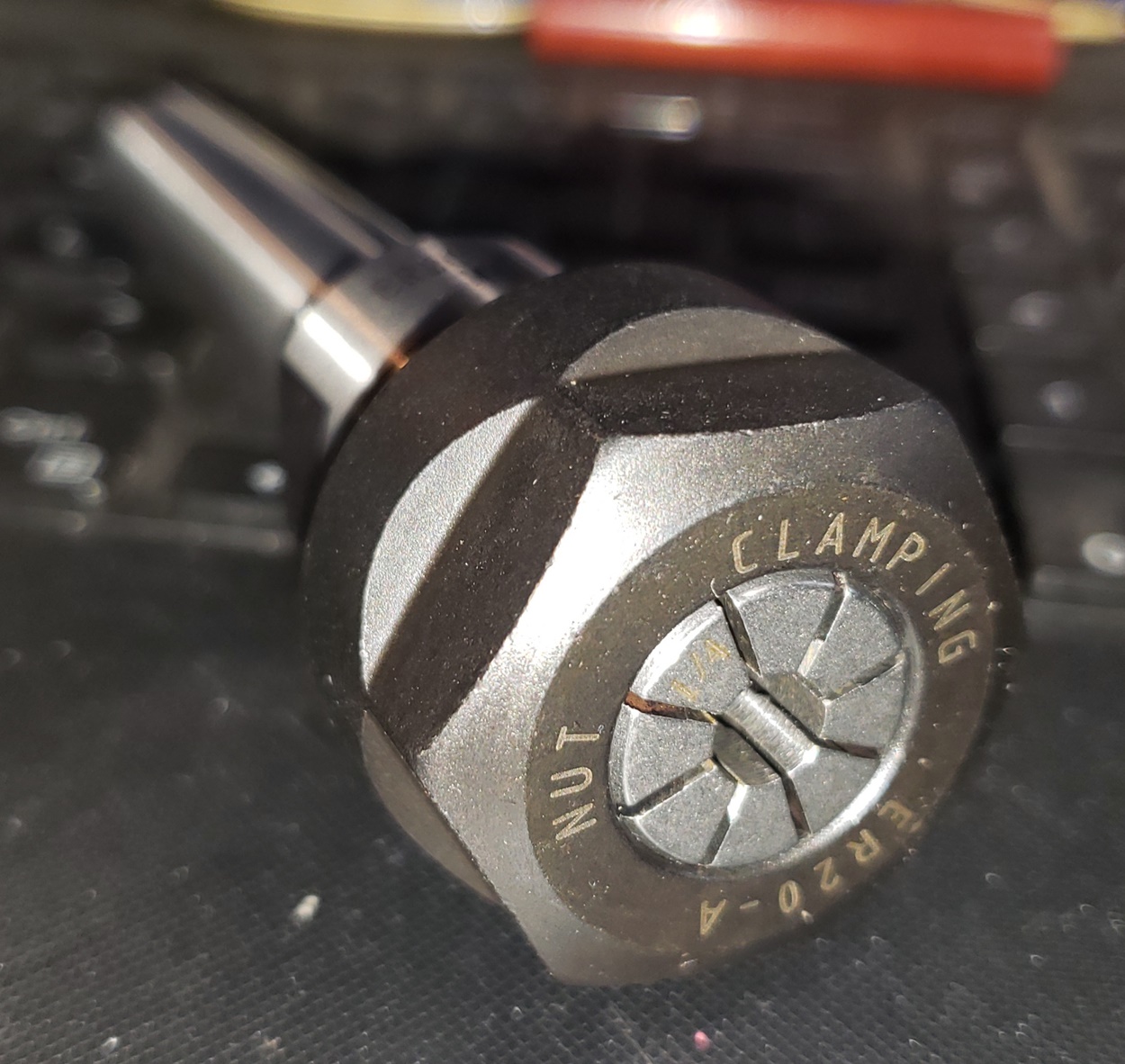

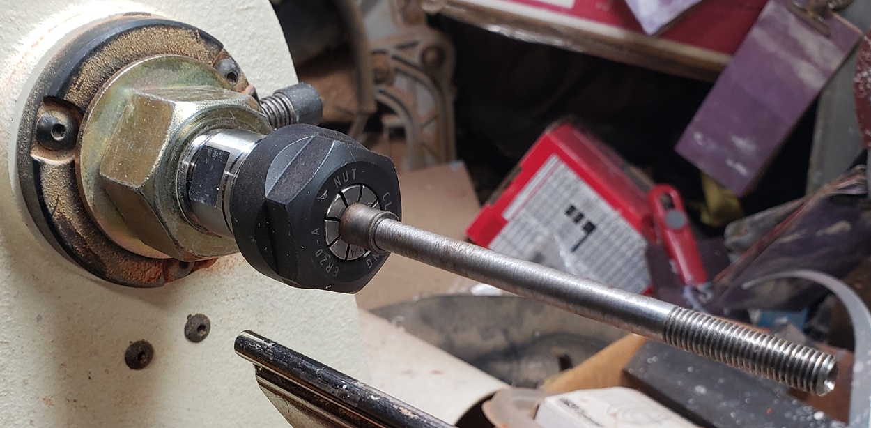

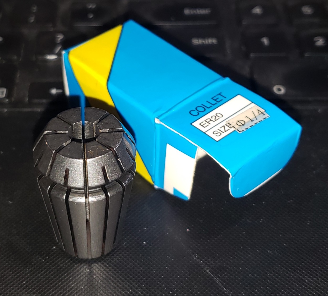

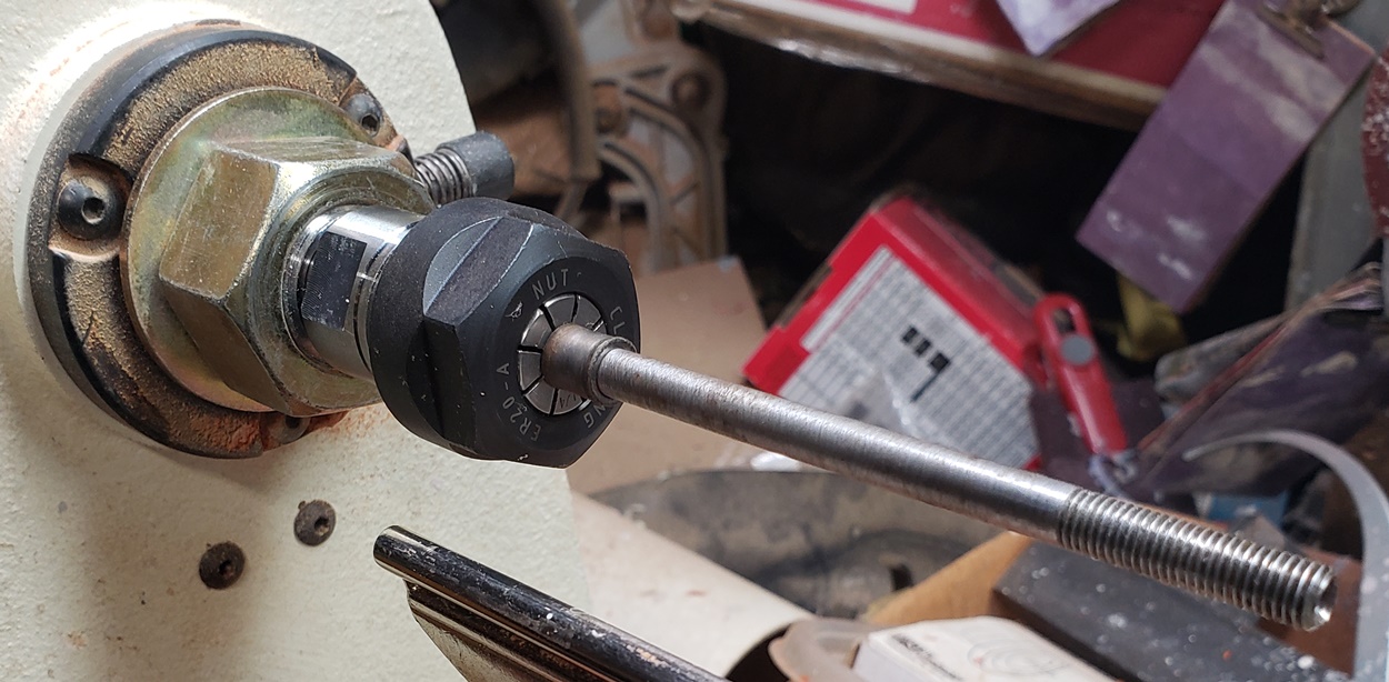

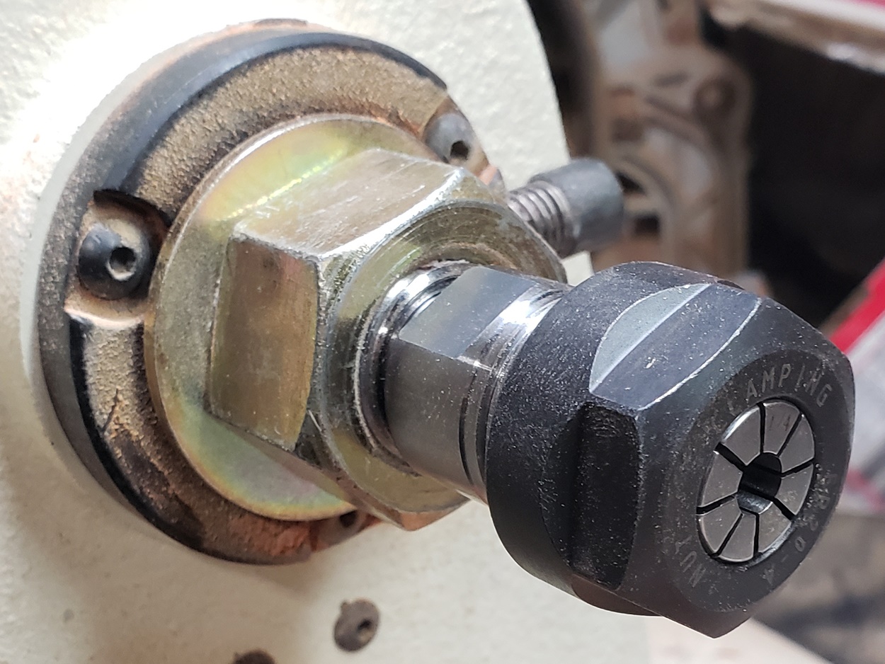

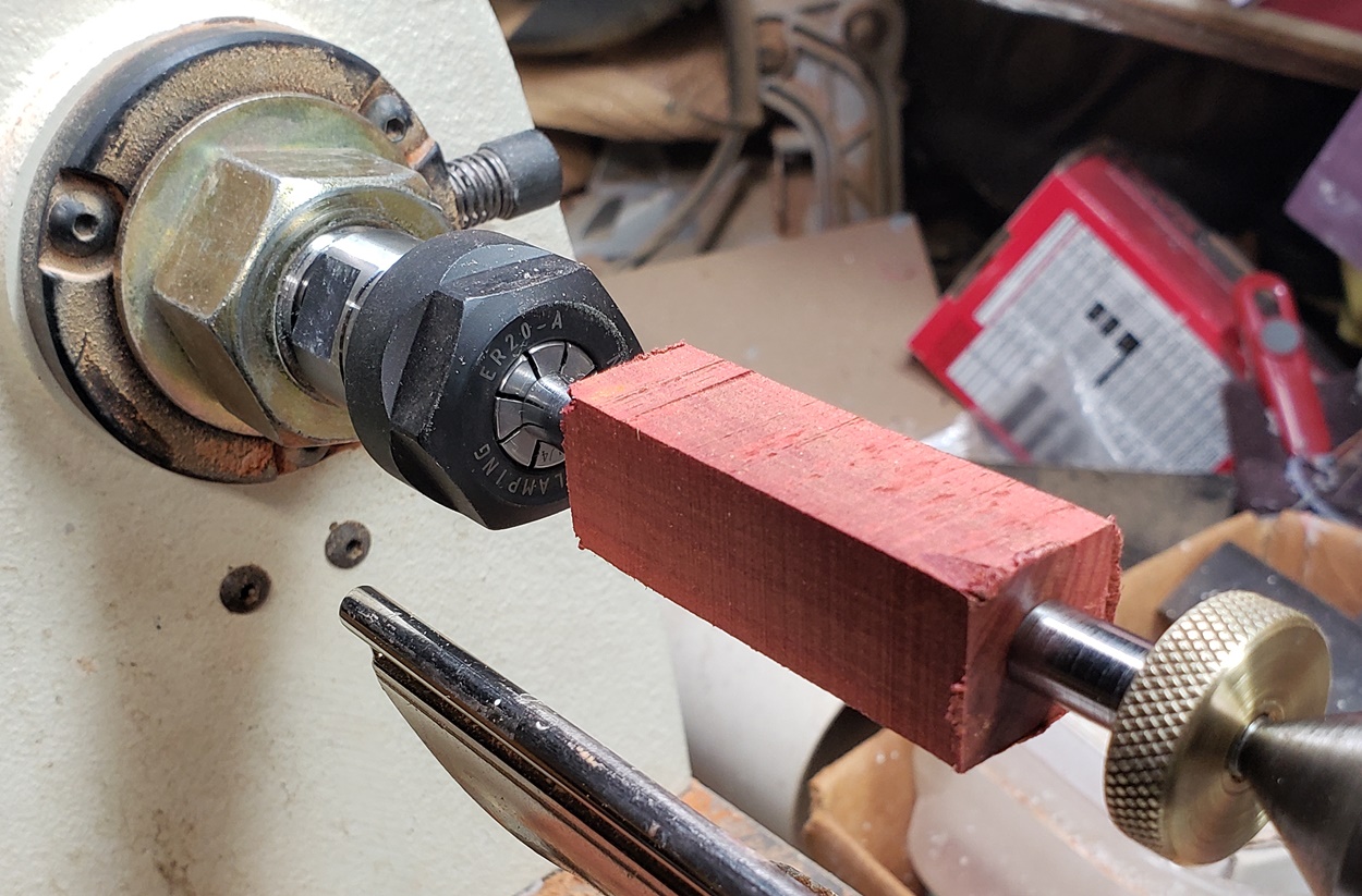

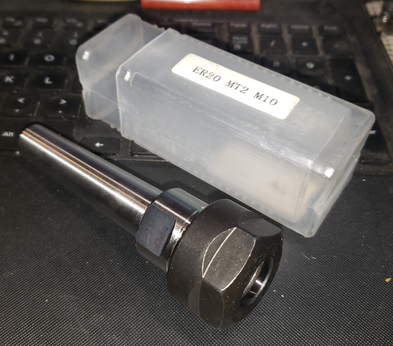

Of course, it could be the mandrel system itself. I've used two different ones from PSI, and one from Woodcraft. I recently switched to a cheap collet chuck from Amazon, and it actually seems to be more accurate.

Yup--This happened to me too. Small piece of swarf got stuck in the taper and caused all my pens to be slightly off. If you sand longitudinally and radially, I've also oversanded longitudinally before causing the pen to be off center. Finally, if you are using kits that have pieces that thread-onto delicate threads (like a finial), don't press directly on the threads when assembling the pen. Either screw the finial on and press it in as one unit, or use a slightly oversized tube to press on the area outside the threads, if that makes sense.
Finally, I've just had mandrels get out of whack even with a mandrel saver. So you might test that your mandrel is running true with a dial indicator and, if not, replace it and don't tighten it down so tight.

IMO the mandrel bending is actually caused by the tail stock and a live center in the end of the mandrel and the tail stock is too tight. The thumb screw will tighten the bushings to the blank and does not alter the mandrel. This will also show up if the blanks are not square to the tubes.
Since the OP is using a mandrel saver the mandrel should not be bending. I would say the ends of the blank are not perfectly square or there is build up of CA glue or the Morse taper is not fitting properly.
