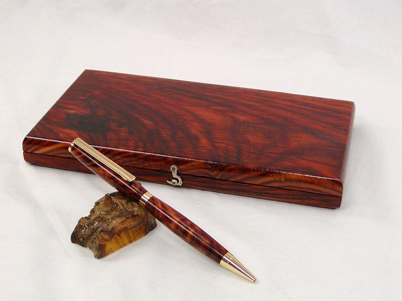

I thought I would post for you a picture of two items. The pen pictured was finished with CA - one coat of thick and one coat of thin with MM on the final coat. I polished it out with Mylands - but it really didn't need it.
The contrabass reed case behind it was finished entirely in lacquer. Two coats with a sponge sand between.
Both the pen and the reed case were made from the same chunk of cocobolo.
Best,
Roger Garrett
