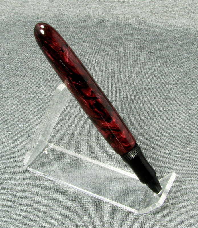

I left a pretty good wall thickness on this one. I used PR for prototyping since I had quite a few of these blanks available. I'm just curious if/how it will hold up over time.
My assumptions above were pure speculation and I'd be happy to be proved wrong.
damn, I want that blank. where'd you get it?
Garnet and Black mix that I had Jonathon mix up for me some time back. I had a few extra in the shop and figured they would be a good test material.
