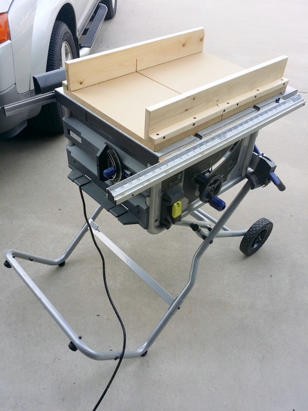

I don't think a job site saw can ever compete feature for feature with a quality full size contractor's saw. I sold my Delta Unisaw to make more shop space. How I regret that. I recently purchased a Lowe's Kobalt saw. I looked at many saws and carefully researched the web and YouTube diligently. The DeWalts received excellent reviews. Bosch not quite as much and Rigid came out t the bottom in my research. Did not find much on the Delta saws. I saw a few on the Kobalt but not many. My closest Home Depot does not even carry their own Rigid saw. I finally went to Lowes which had Bosch, Delta, DeWalt and Kobalt on display. After spending an hour or more comparing features I finally decided on the Kobalt. It is very well built. The folding stand is very rigid. I liked the idea of a front and back lock on the fence. I can make the fence accurate but I also want the fence to remain where I place it. The table is a little smaller than the other saws on display. I also appreciated the slide out side wing goes out to 30" which is great for 24" cuts. The price difference is spectacular. Being old and retired I do watch my budget carefully. Also at 76 with many health problems I don't even know how long I can continue my current projects. God wiling I'll have some good years left. But back to the Kobalt saw, I think it is a terrific bargain. What ever you buy enjoy it and happy shoping.

I still think the Ridgid has the best fence of the saws I looked at. The Dewalt was a rack and pinion style fence that looks like it would be very accurate once set up. I have got to agree with Rocktime on the Kobalt saw. It's the least expensive of any of the saws I looked at, and I was pleasantly surprised at how accurate the fence was. It locks in front and back, which I said I didn't want. But it locked better than any other saw with this style fence. I think you would have to try to get this to lock out of square.
