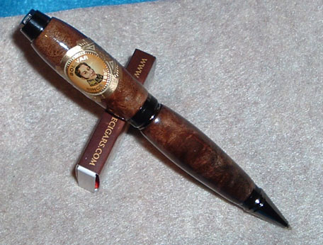

Doug, I made this one some months ago and gave it to a co-worker.
I exaggerated the upper barrel to accommodate the band.
It uses a cigar kit which has a rather small centerband.
If you are using one end as closed and use a large centerband kit you should be able to make the barrel large enough to use about a 50 ring size band. May look odd though!:biggrin:

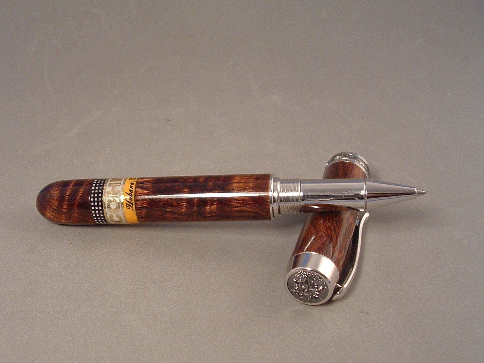

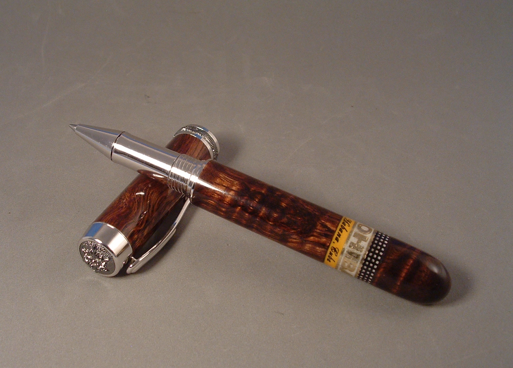

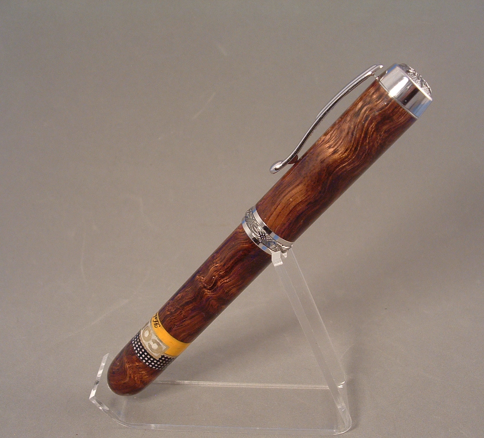

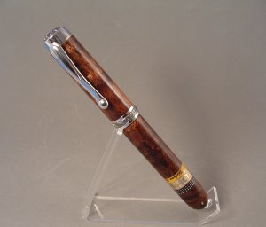

The completed pen
The kit chosen by the customer from the ones I had narrowed it down to was a Statesman Rollerball in Rhodium/Black Ti plating.
I actually got this pen made before Thanksgiving (just barely in time) but I am just now getting around to posting the pictures. I delivered the pen to my customer last weekend at a Christmas craft show and he is very happy with the pen.
Closed end Statesman rollerball in Curly Koa wood with the cap on.
Closed end Statesman rollerball in Curly Koa wood with the cap off.
