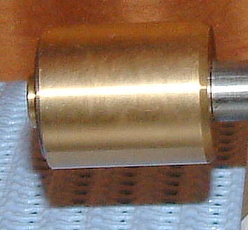

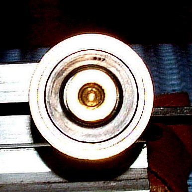

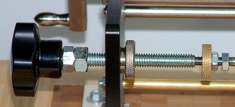

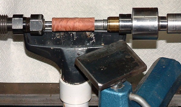

Forgive me for intruding please find my solution for Slimline production on my Taig. Making a brass sleeved outside recess hole a snug fit for the standard mandrel inserted in the outboard end of a brass piece threaded to fit where the drill chuck fits. Also on the outboard end I fitted a bearing into which the sleeved brass receiver for the mandrel is press fit creating a live centre. The recess is about 3/8 of an inch and I used 1/4 inch washers to pack on the shaft. On the head stock I used the Collet Chuck and Collets sold by Taig. For convenience it would be dead easy to make different sizes to accomodate other mandrel sizes.
All this many years before mandrel savers were thought of when I posted, several manufacturers picked up on this design and went into busness selling modified mandrel savers. One pic shows my mod to hold the mandrel with other mods for my Pen Wizard, then on my VL100 lathe. The end view shows the bearing and recess sleeve, the brass one fitted on the Taig.
Trust this helps. Making a through live centre useless for the Taig or using the h/stock collet and locking the mandrel after would work as well.
Pics taken 2007.
Kind regards Peter.
