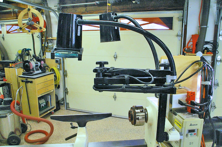

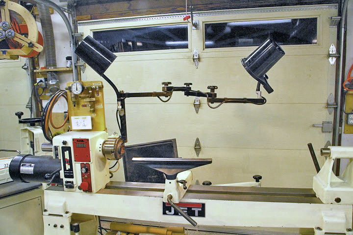

I have found that lighting has immensly helped me during turning and finishing. I made an articulated arm set up with two Moffat type gooseneck lamps (from CSUSA). These lamps also have excellent swivel heads on the highly stable goosenecks. I have used 100W bulbs, but more recently switched to 23W CFL bulbs. It's like turning outside in the bright sun now:biggrin:. One of the lamps has a wide magnifier on the shade that has come in handy on occasion.

Thanks Kryn, tumbleweed and Dick for the replies you gave me. I have to say I like the rig you made Dick. I'm not sure I would need two of the Moffatt light but one might do the trick. I do have question about going form 100W to 23W CFL do they put enough light on the work to show up sanding marks and the like. I'm going to have to look of the light to see how much they are.
Dan, the 23W CFL shows sanding scratches just fine. It also shows gloss buildup very well when applying CA or WTF finishes. Hope this helps.
Thanks Dick it does help. I would also think there would be less heat as well. I found the moffatt lamps on amazon for under $57.00 and it's a prime item so I get free 2 day shipping. If I go with that lamp I have to choose which base to get.
