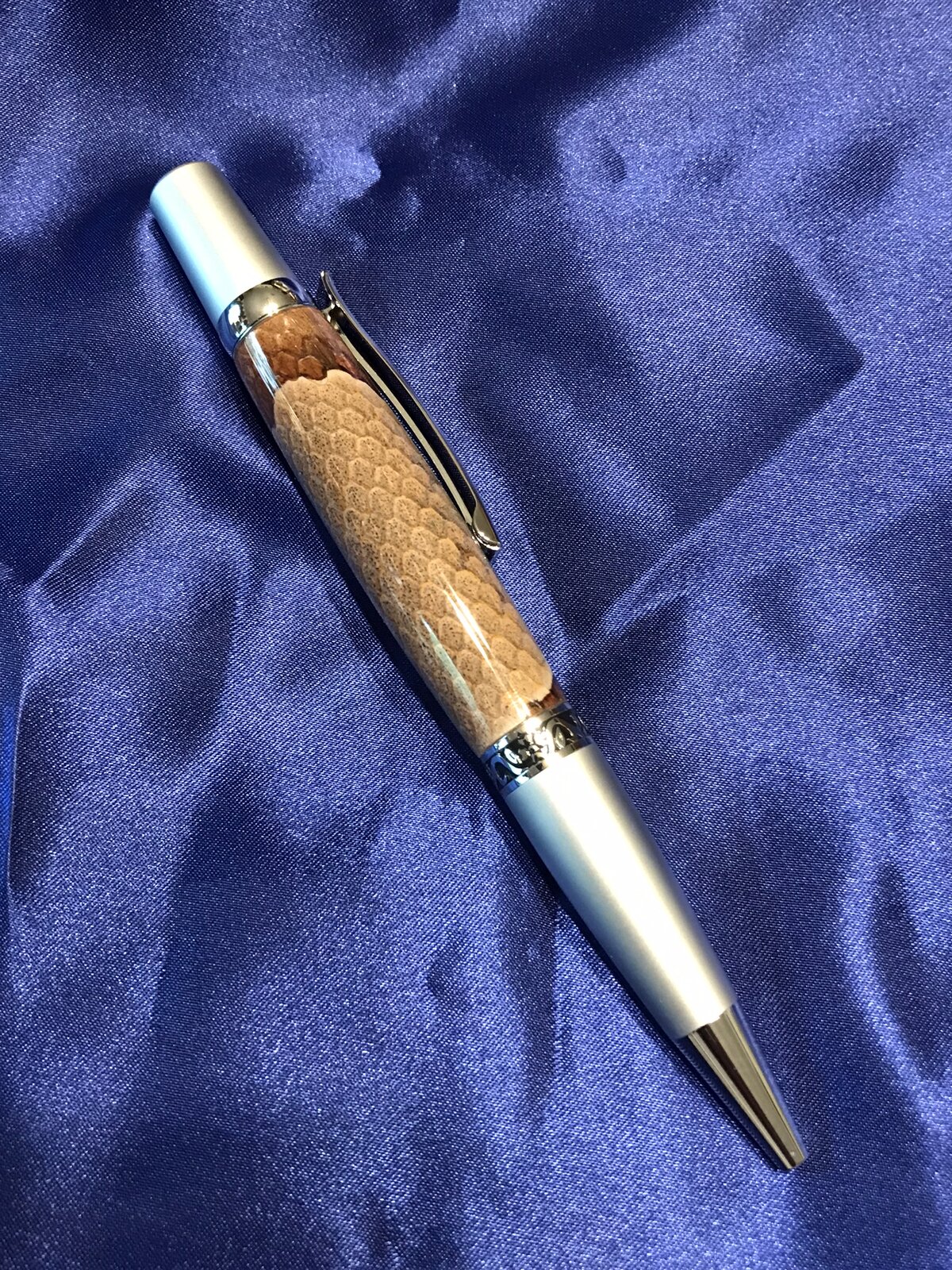

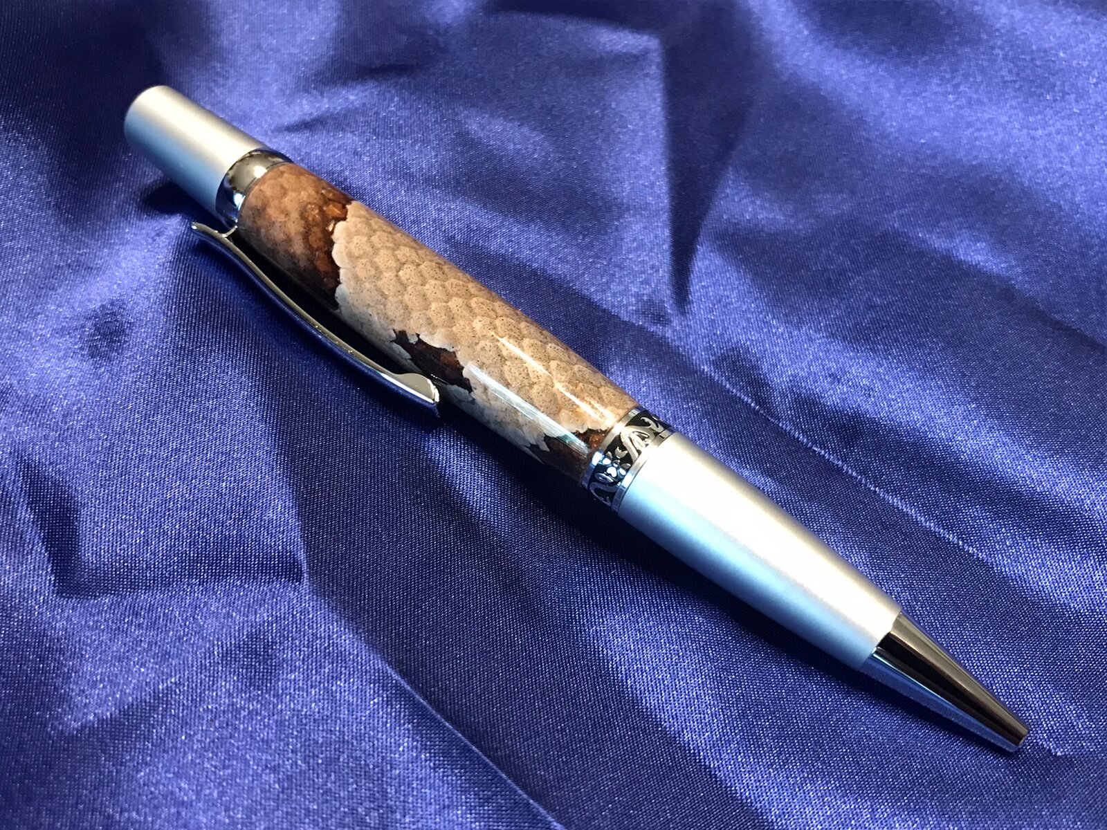

newby here, I've got to ask, what's a snake? assuming it's not the kind that creeps me out.
Kenny Durrant
Sep 11, 2012
2,505
Sachse Tx. 75048
Yep! The creeping kind. Copperhead skin.
