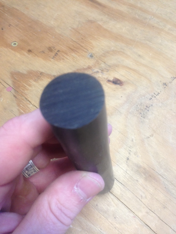

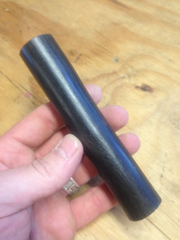

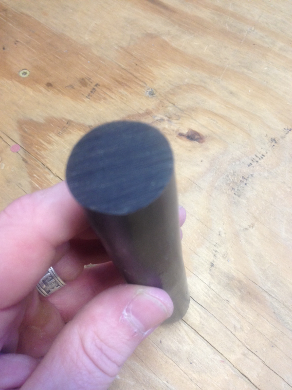

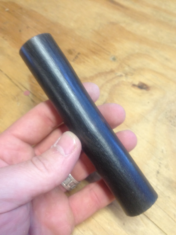

Got it in a box of stuff. Seems like wood but ?
hard to tell from the pics but the side view seems to show an open grain structure ...perhaps bog oak or Asian Ebony
I've worked with bog oak before. Doesn't seen like it In person. It doesn't seem heavy enough either.
I was wondering ebony or black wood? I've never worked with either.
Slice off a very small slice and burn it. You will be able to tell from the smell if it is wood or horn.
not a bad idea. The idea of smelling horn doesn't seem pleasant though. It would seem like horn would be hard and smooth? This seems to have grain and I can easily whittle off it with a razor knife.
I don't 'need' to know, I just wanted to know if there are pitfalls to turning / finishing whatever it is. And what sort of kit to use it with based his interesting it is.

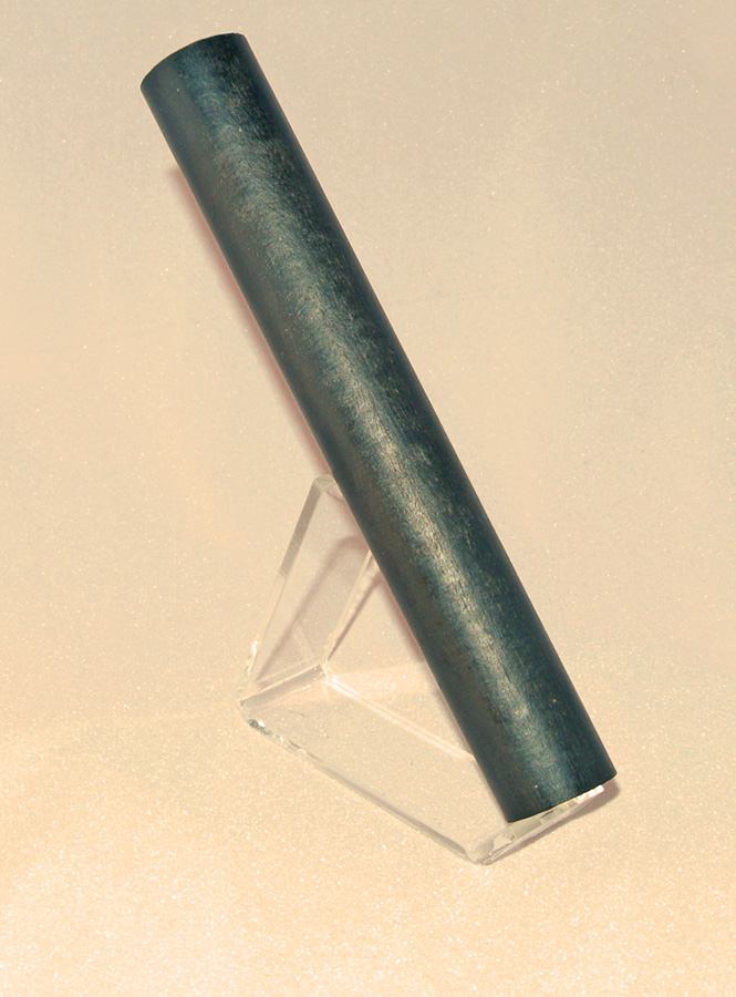

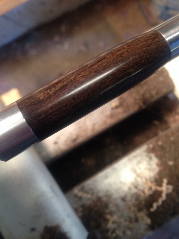

It's really hard to tell in the photos in your first post but does it look anything like this:

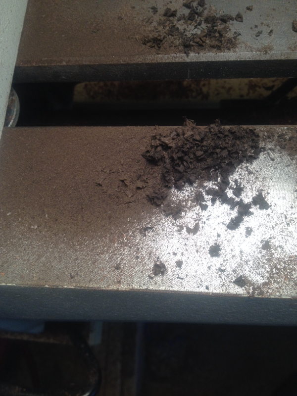

This is an acrylic with a good grain texture that is powdery when drilled.

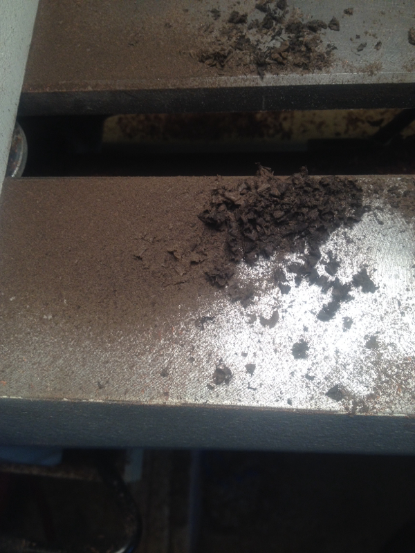

The shavings is not that of ebony, ebonite or horn. Same with the color.
Few questions, you said flakes and crumbles. Is there a residue on your skin, it is chalky, soot like, paste?
From the shavings image it appears to be some type of compressed, composite material. Add to that the color change and reflection patterns in the first image I would have to wager $ on it being some type of man made material like that. M3 maybe?

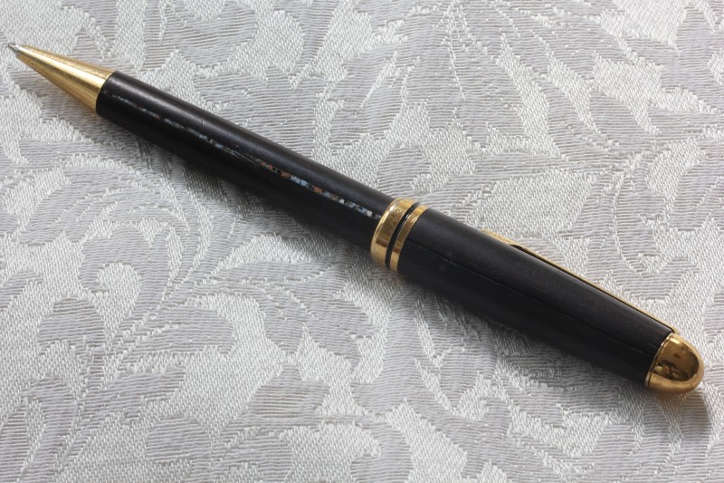

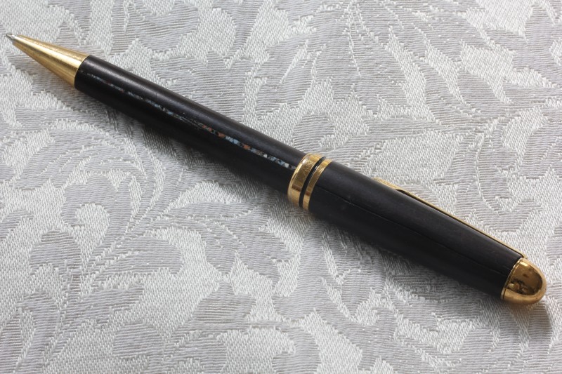

Rob - If it is this, any problems with cracking etc?
This is one of my very first pens. Maybe even first 50. From over 10 years ago. I purchased the ebony as a pen blank. Probably turned it within a few weeks or month from purchase. And it cracked horribly within a few weeks. So I filled the lower crack. Still carry it around. Rotated the clip off the upper crack. Hope it shows through.

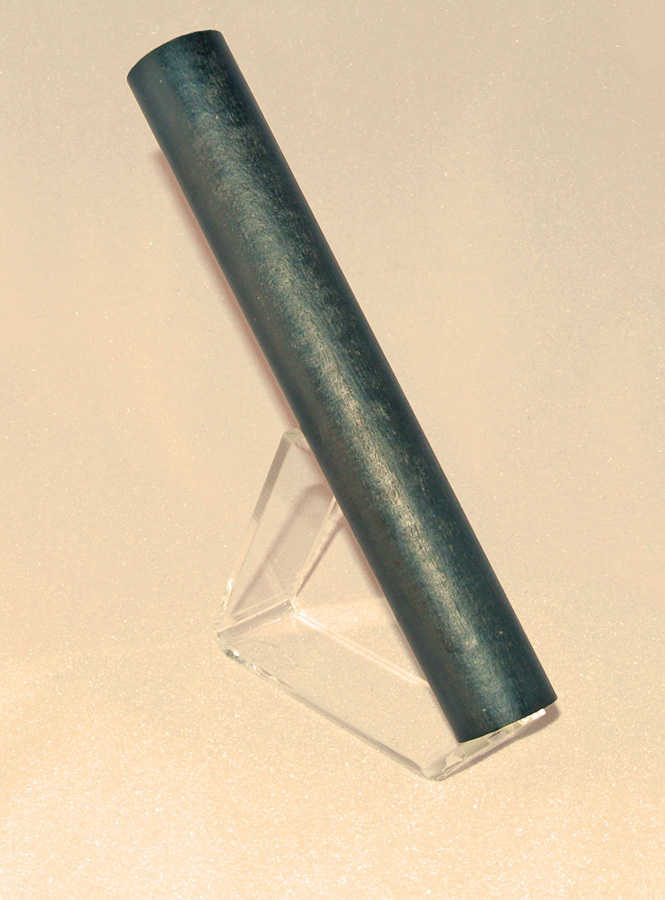

Here's a pic of one of the dowels I have left. I used most of the darker ones. Gaboon comes in various shades from brown to pitch black -which is what is sought for musical instruments.
Yes, I've had problems with cracking. I know it does not like temperature extremes.
