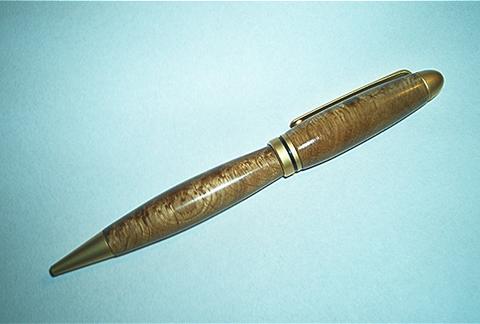

I have some OAK beams (2.5" x 15" x 5')from a dismantled barn that was built in the late 1800's. I have to sharpen my tools 2-3 times per pen. It seems almost like petrified wood!
Not the most colorful wood but when it is done, it has the nicest chetoyance, just incredible!
I have more of this wood if anyone is interested in a trade.
One of my earlier photos, not the best!

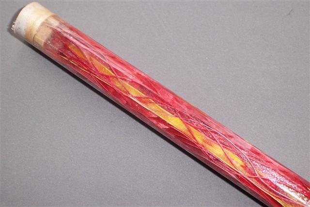

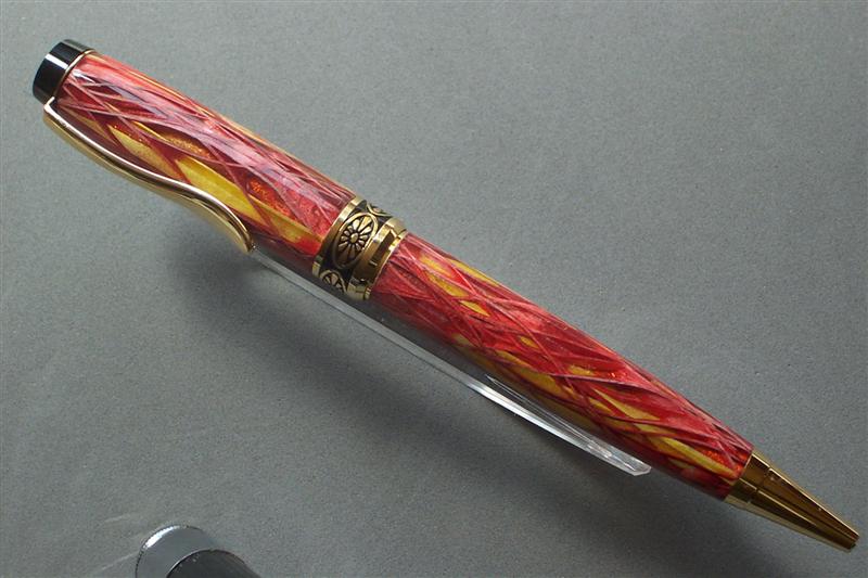

The most difficult stuff I have turned to date is plexiglass with a laminated wood glue up in it.
