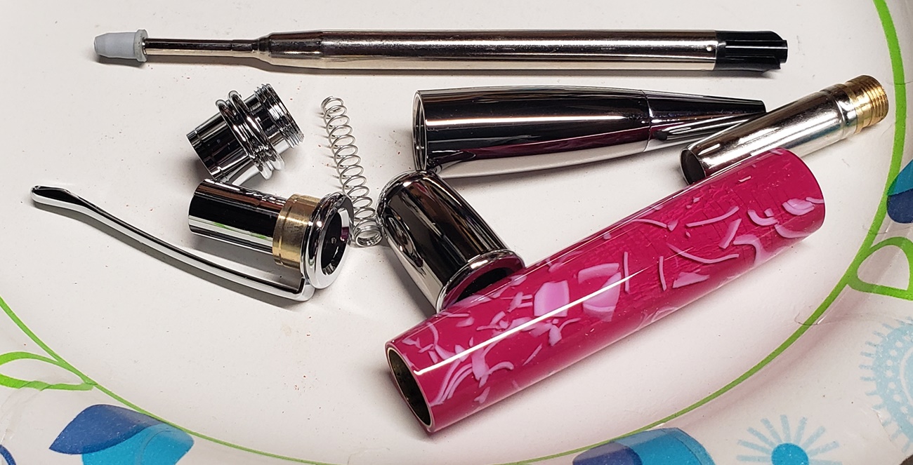

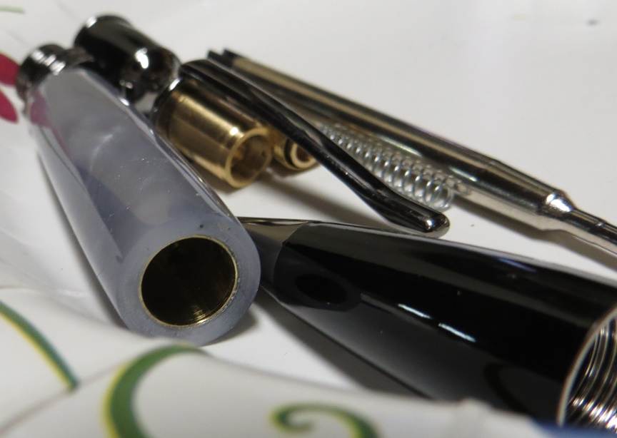

Gatsby on the left, Gatsby Grande on the right. You can see that the body thickness on the Gatsby is less than on the Gatsby Grande. I hope you ordered Grande bushings with the kits.

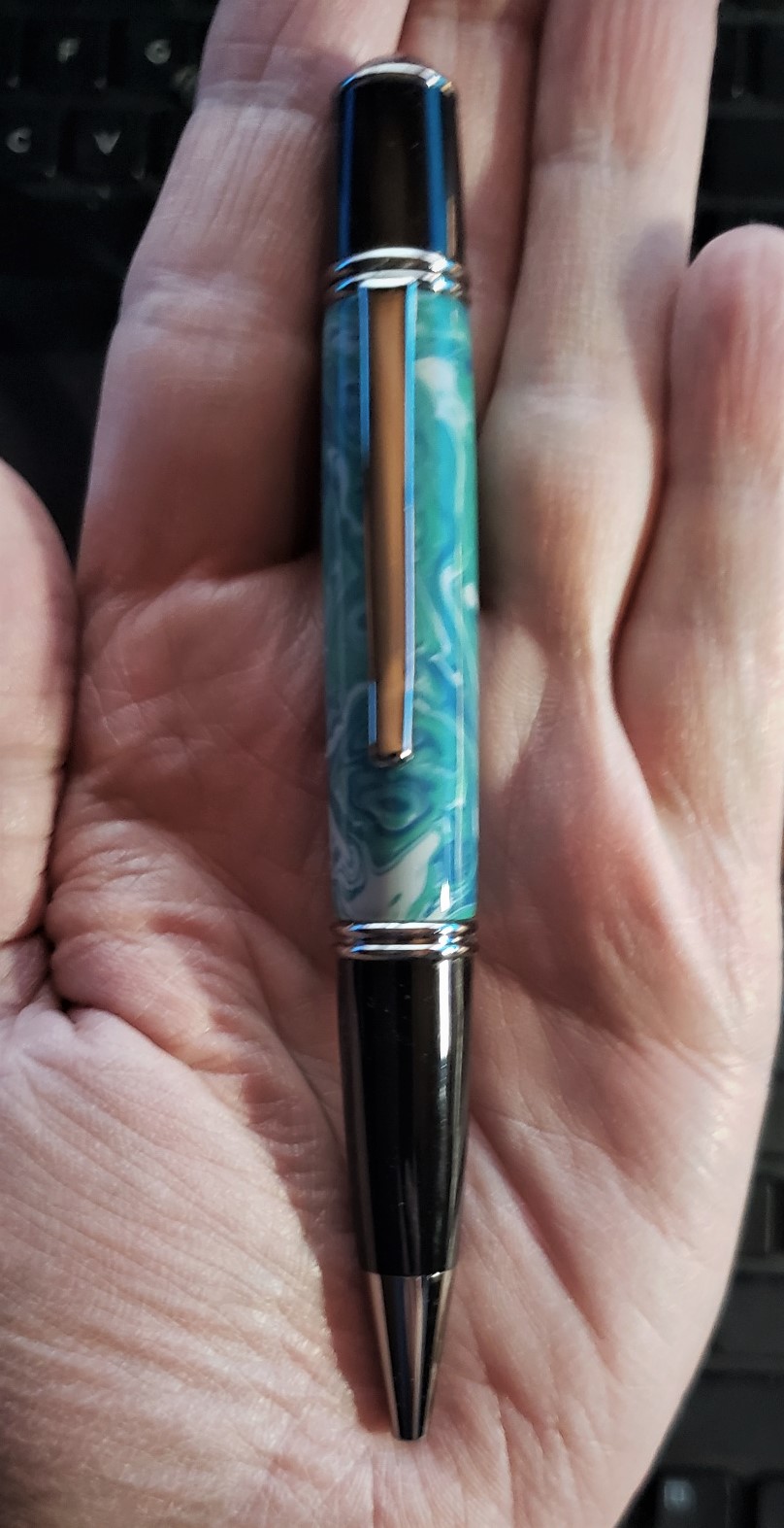

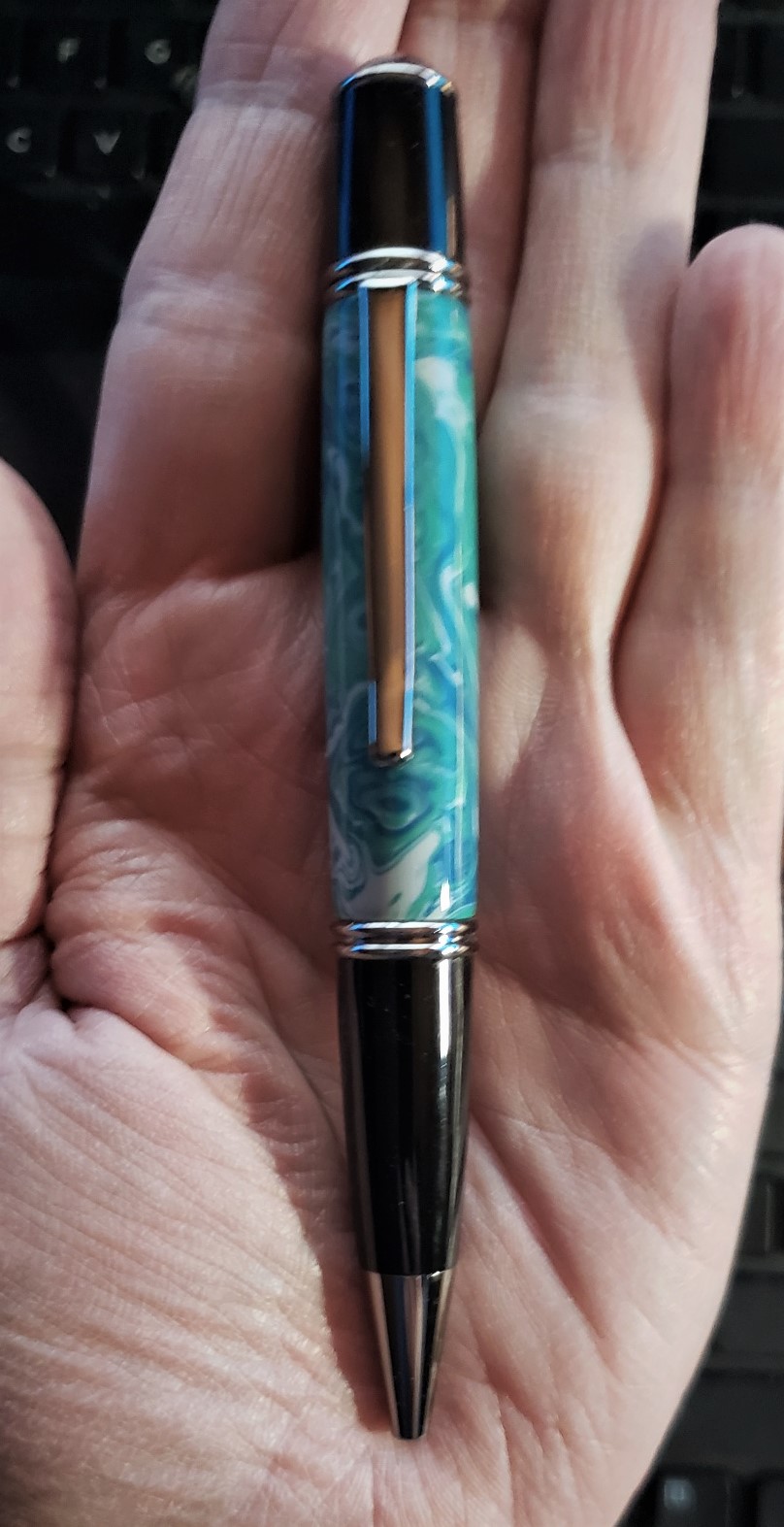

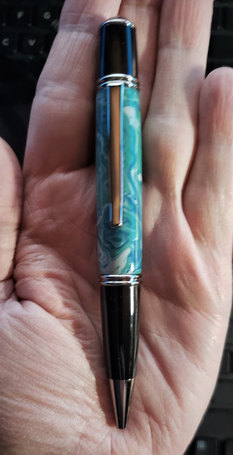

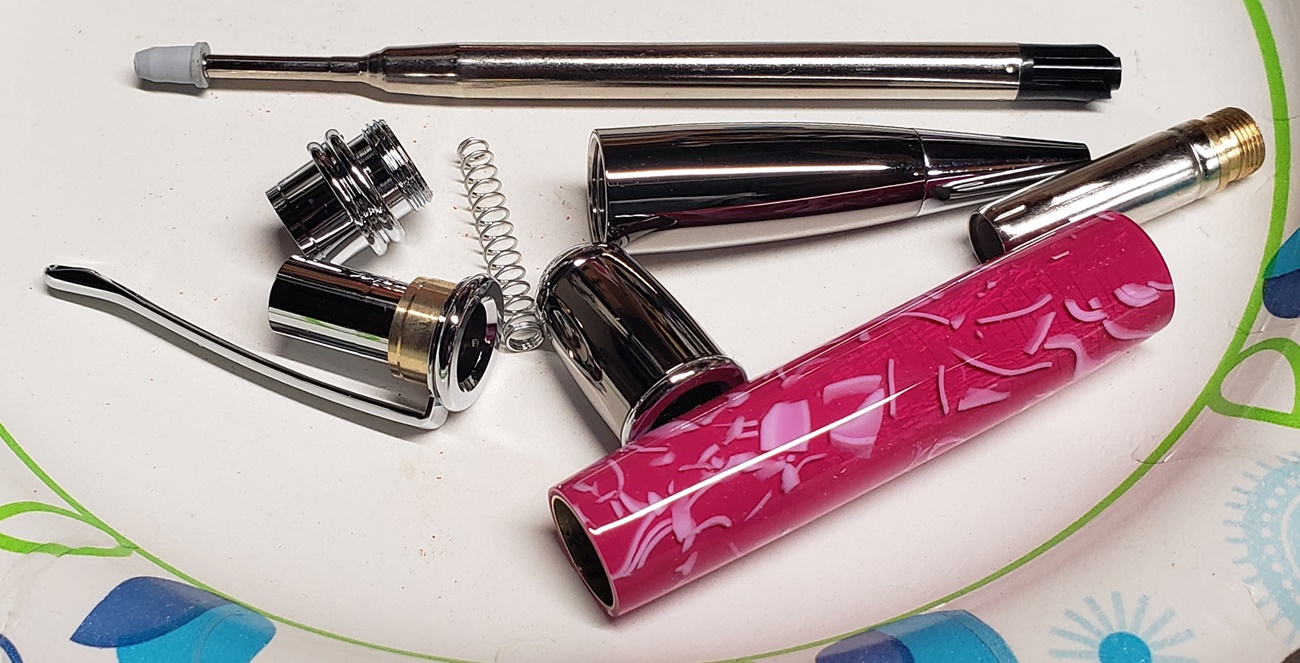

It is the only pen that I started turning with a nearly straight (not convex) profile(but that is a matter of personal taste). I just made this one.
Blurry photo, but you get the idea.
What blank is that? I like it.
Lava something ; I bought it from Exotics (look under his Lava category). I have many of them.
I have a ton of CA that is approaching a year old...so I applied several coats to it. They are 100% opaque turn very easily, but a little powdery. That's another reason why I add the CA, but one doesn't have to.
