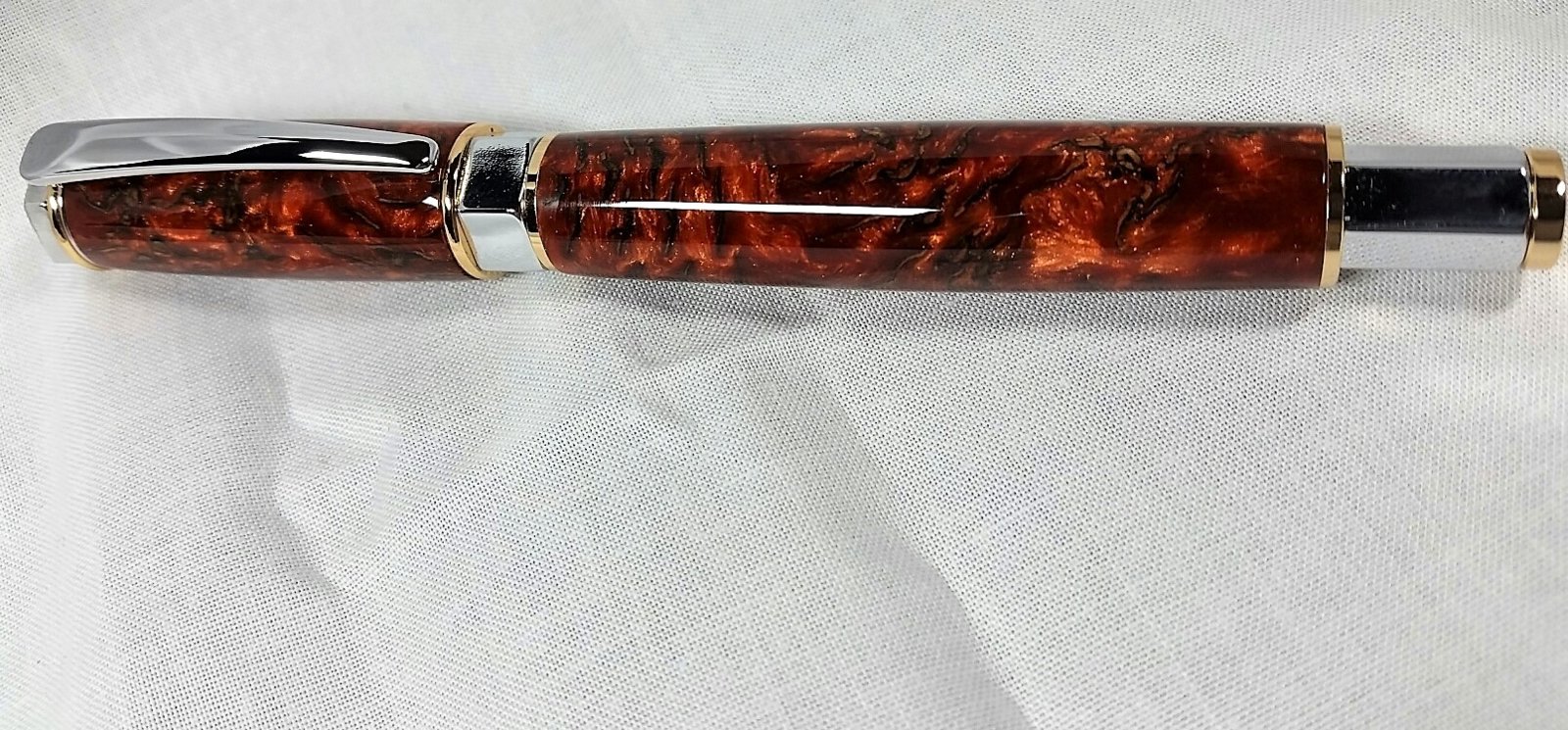

I made my first fountain pen back in 2006 for my youngest daughter's wedding. I made a pen stand so the people could register at the wedding.
Click the link and look:
That was before I had a good camera to take good pictures. When I posted that picture, I got some great advice from several people - Do not stand the fountain pens with the nib end down. That is OK for ball point and some roller ball pens, but not fountain pens. I took that to heart.
Second part - notice how I had the thinking of the roller ball and fountain pen as similar. Well, in the fountain pen world, they are not. That is also the reason that fountain pens will sell 2x on the lower end and 10x on the high end than ball point/roller ball. Fountain Pen aficionados or enthusiasts are a different breed and treat their pens with a different kind of respect than do ball point/roller ball buyers.

As I researched the fountain pens tuning, care, and maintenance I noticed that most of the end users where definitely a different user than most. That group definitely was aware of the pros and cons but, the group that was looking for status or just thought it looked cool was the group that truly gave me concern as a seller.
