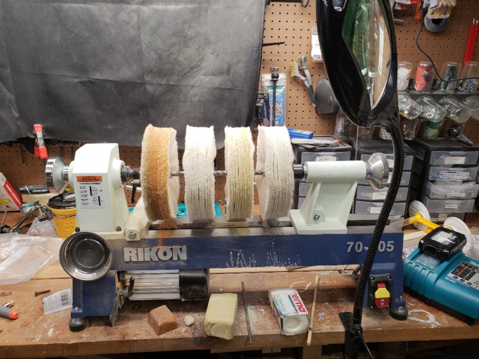

I have Peachtree's 3 wheel system set up on a lathe, but lately have been using Novus 3 step after Micro Mesh on Glu Boost--and really liking the result. Steps 3 & 2 are applied at about 350 RPM, then lathe off and in grain direction. The polish (Step 1) is just with lathe on. I'm liking it on Alumilite with no CA also, but i need to work on that technique a bit.
edit--clarifying...the Novus is applied with blue shop towel, not the buffing wheels. On the Alumilite, i may try the White Diamond wheel before and/or after the the Novus Step 1...just thinking out loud there.

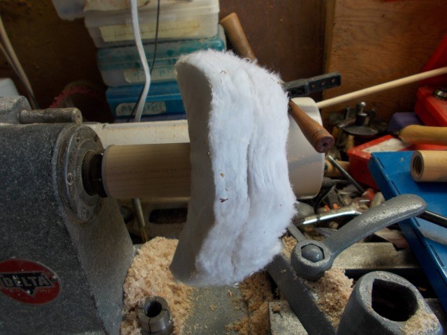

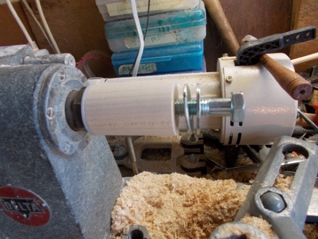

I drilled and tapped blocks to fit my headstock threads. Then drilled and tapped from the end for 1/2" bolts to hold the buffing wheels in place. This cost me a few dollars in wood, bolts and washers for about 15 sets. All of my buffing wheels come from Caswell Plating. I used the advice of Tex at Durango for purchasing teh wheels and compounds.
I eventually made one of these for each buffing wheel that I have. They fit nice in 1 gallon zip bags. I keep the wheel and it's buffing compound in one bag. My wife also does jewelry and uses one of the lathe for buffing, so I have about 15 different wheels and compound combinations. These wheel mandrels fit 1-8 threads,

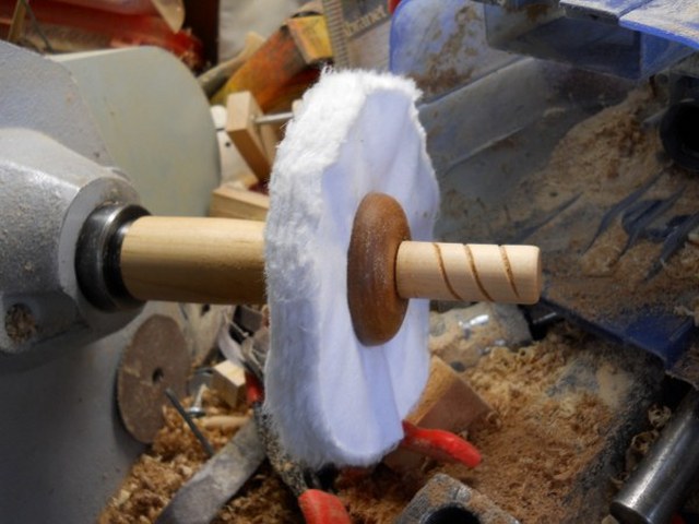

The 3rd pic works the same way, but I used a piece of all thread to make the bolt part, This was made for the fun of it. But it works great for my specialty buffing wheels.
I high recommend that you label your wheels to the compound that you use on that one. These pics were taken before I screwed up and used them out of sequence. You Never want to mix compounds on one wheel, and you DO NOT WANT to polish anything wood with a wheel that is used for metal items.
