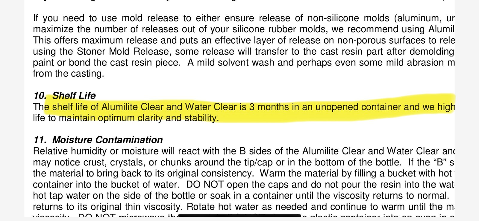

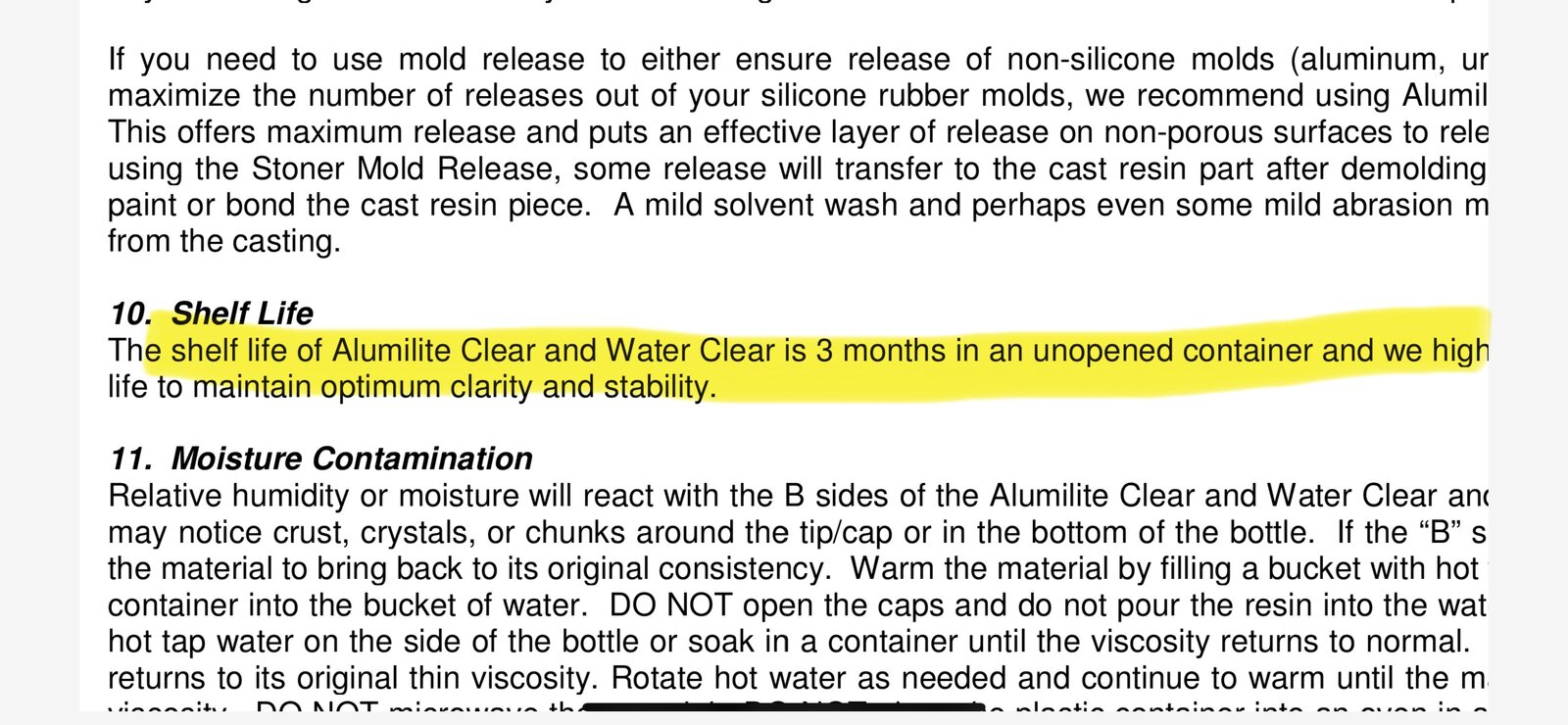

What's the shelf life of unopened Aluminite Clear Slow and opened Liquid Diamonds resin?
I think the Alumilite Clear Slow is three months, however I've used it a few months past that and it's fine. I do keep it in an environmentally controlled space though.
I've got some that is well over a year old and it seems like it still works like new. Like Michele. I keep it in a cupboard in my climate controlled workshop. - Dave
