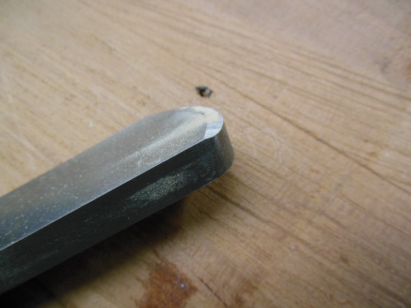

This is my negative rake bowl scraper. It is a finishing tool, not used to hog off material. After turning a bowl form to about the correct thickness, this tool is used to remove any tool marks from the inside or outside of a bowl. Present horizontal and on center line OR just above center on inside, just below center on outside. In case of a catch, you want the material to be moving away from the cutting edge.
View in Gallery
It is easy to put a negative rake on a standard bowl scraper. The angle isn't critical. Any angle from 15 to 25 degrees is appropriate. The higher the angle, the less "grabby" the scraper is. Sharpen the scraper upside down to put a burr on the upper edge. Hone top surface for smoother cuts.

Tim, would you mind describing how you do this? I'm still not following how a skew can be used like a negative scraper.
A skew is usually used with the handle down and blade upward and cutting in at an angle. When used as a "scraper", it is laying flat on the tool rest, handle presented level to the blank. Since the skew is beveled on both sides, and presenting the blade flat and level to the blank, the blade end is at a negative angle.
Notice that Randy posted a picture and how the end of the blade is ground slightly downward - the end of the skew, when presented this way, the blade edge is also slightly downward. This is a "negative" angle when presented level to the blank.
