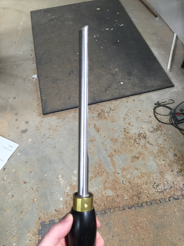

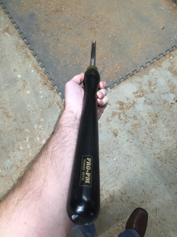

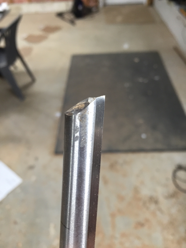

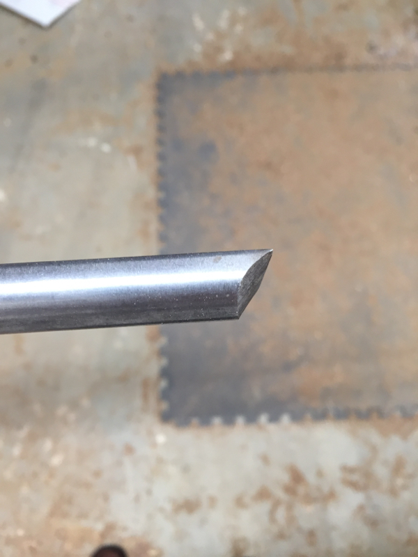

Got this bowl gouge recently in a bulk deal. Nice Crown Pro-PM model but no idea what the grind is. Any tips, can't see this not being a catch machine! Thanks!

I've looked at it for a couple of weeks here and there and keep shaking my head trying to figure it out. I guess I did just needed to be sure it wasn't just me missing something lol.

The first picture appears to show a flat bottom and not the traditional U, rounded V, or parabolic shaped flute.
If flat, that is a special tool developed by a midwest Turner and sold through Hartvile. Memory is his last name was Houette or similar. Was intended for bowl bottom cuts. Was a bit tricky to use.
The bad news if flat bottomed, Will not grind to a bowl gouge.
It can be reground to a negative rake scraper or a fluteless gouge.

read again, OP says it is a "Crown Pro PM" gouge. :wink:
we can only see a small piece of the handle, but that appears to be a Pro PM handle.
it could be a re-handled gouge, but look very closely at the first photo - it's a parabolic flute bowl gouge.
it doesn't hurt that I have about 5 of those - it's a very good gouge when it's got a good grind on it.

If it is fluted, there are a bunch of good grinds. I cannot see from the photos if it is flat or fluted.

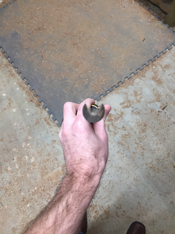

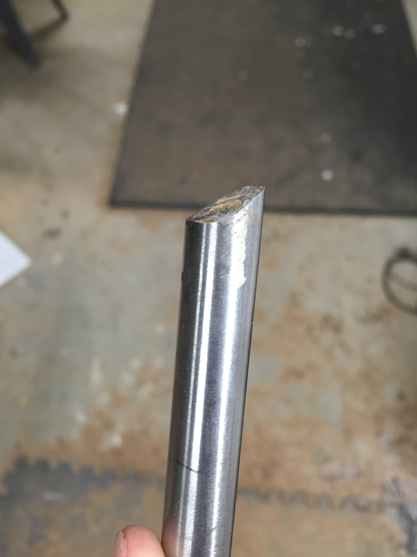

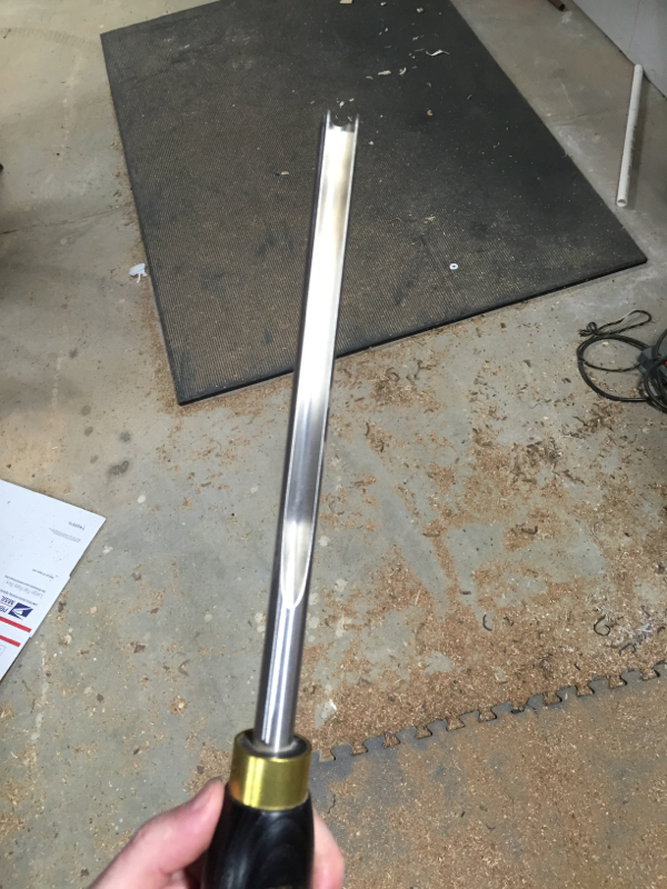

Sorry guys, just getting back home and settled. Definitely fluted. At first I was thinking it should be some sort of bottoming grind but just couldn't figure out how it would work out. Ultimately though I think the former owner just sharpened it incorrectly. Hope the pics help more. I'll regrind it one of these days. Thanks for the help!
