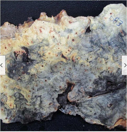

I have my first turning project coming up where I'm considering using maple burl vs. buckeye burl. I'm going for neutral colors and I think the Maple would work well, but the dark bluish? colors I'm seeing on some of the buckeye burl on ebay look intriguing as well.
Does anyone have a picture of finished buckeye burl that started from a piece that looked something like this? ...
